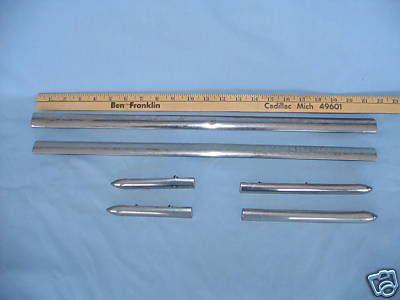

Have For Sale the Deluxe Chrome Strips that attaches to the side of the boot cowling, with attach clips Both strips have imprinted Taylorcraft on them. Let the tribe know about these before they go on the other site!
Ken, do you have all 10 pieces, or just the ones that have Taylorcraft on them? How about the cast grills that go with them? The ones with Taylorcraft go on the engine cowl. The one for the boot cowl is a plain strip.

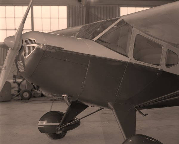

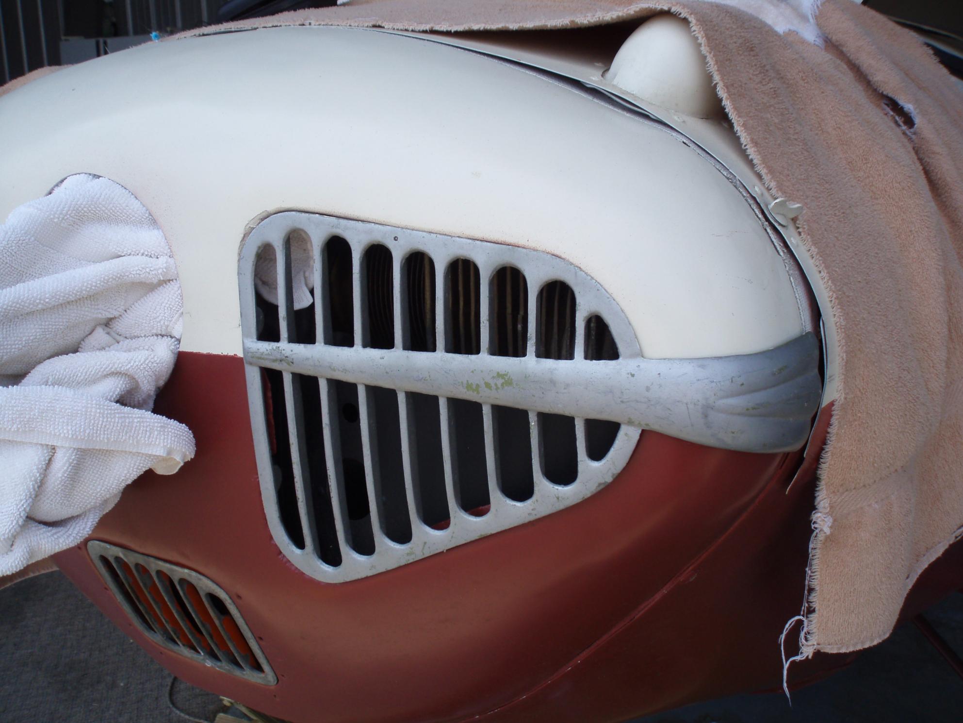

These two pictures are for the nose bowl and cowl. The short pieces go over and under the long ones with "Taylorcraft" on them. There is one piece per side for the boot cowl and one for each side on the door. The door ones have a hole for the outside door handle.
These photos are of mine, NOT the ones for sale, but I can tell you, if you need them, GRAB them. My set took YEARS to find!
The boot trim strips are a different length from the engine cowl ones. Only the front center ones have Taylorcraft on them, but I HAVE seen some front ones without the pressed in "Taylorcraft". The door ones also have a tapered end behind the door handle hole.
I have been planning to make a mold to cast resin ones that would be painted with Stainless appliance paint, but REAL ones still look much better! The front grills are cast Aluminum (there are three of them, don't forget the rectangular one on the bottom). The aluminum never seems to polish up like the stainless, probably my technique. I have painted mine with the appliance paint since the photo and they look much better now. Not perfect, but MUCH better than aluminum that won't hold a polish.

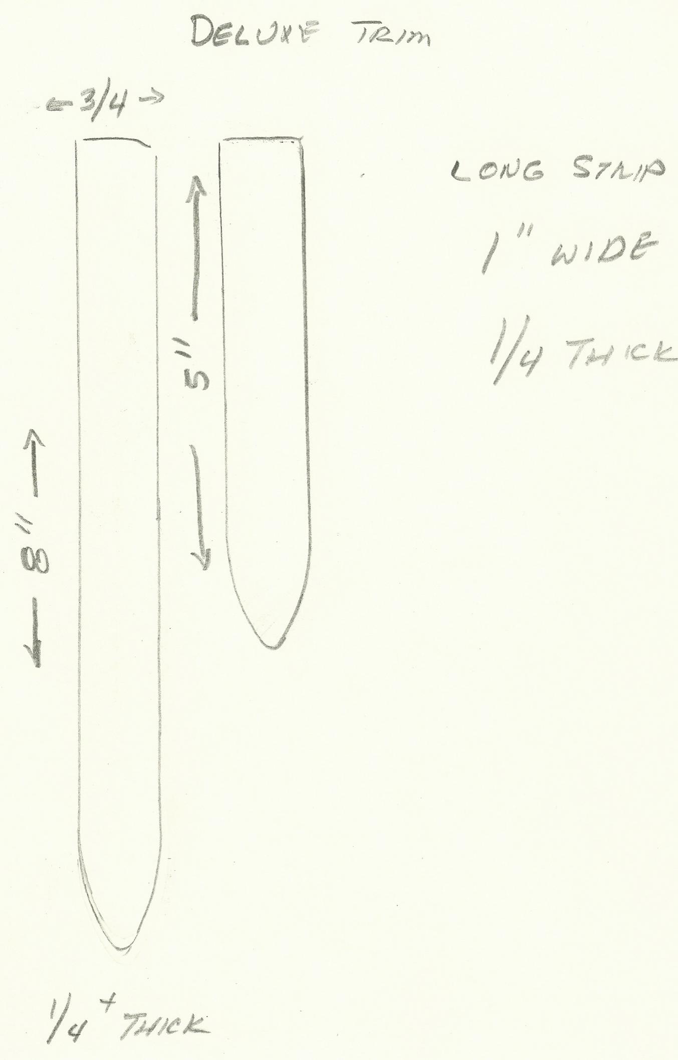

Would you measure the length and width of these and post that info here.

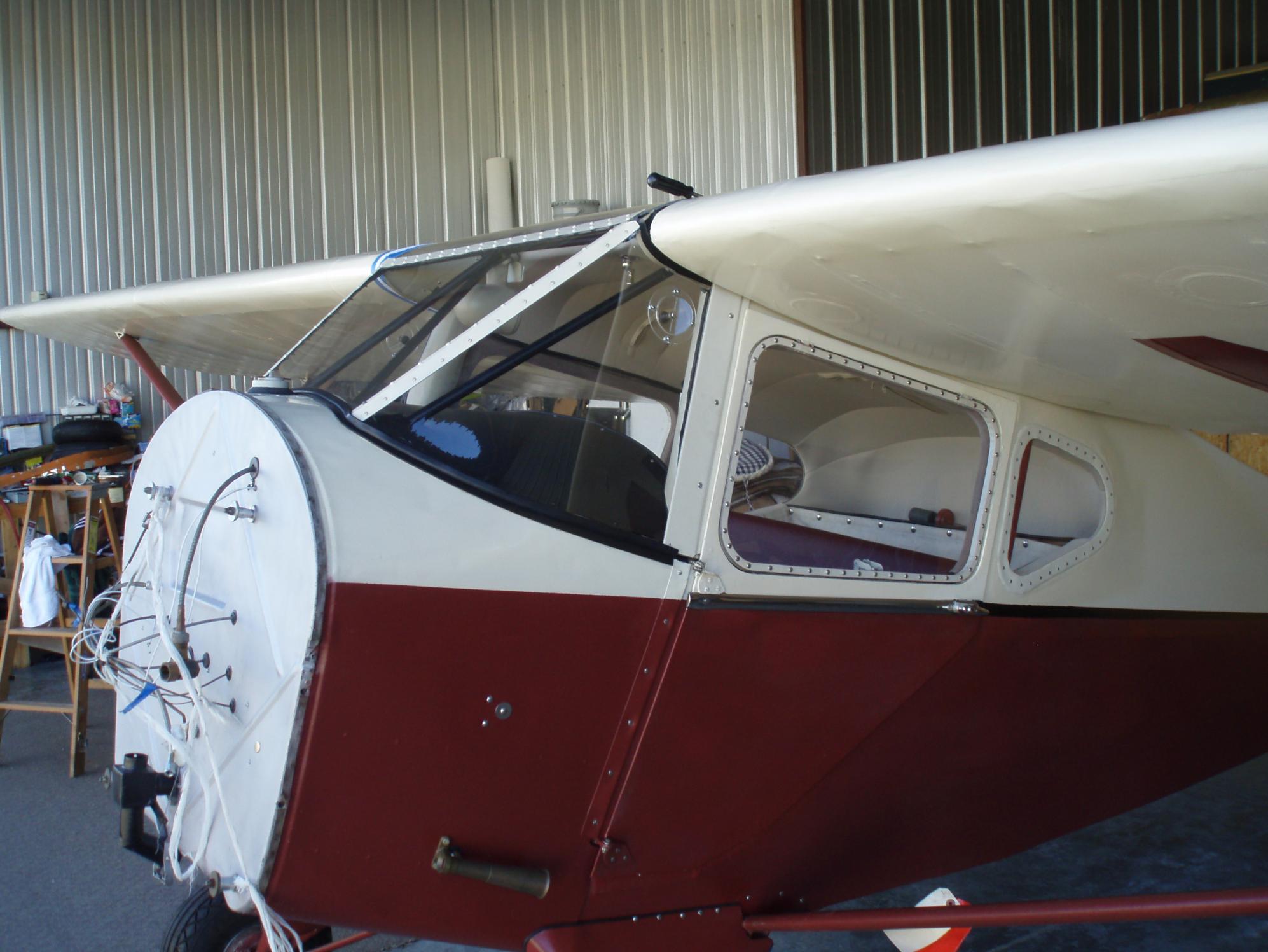

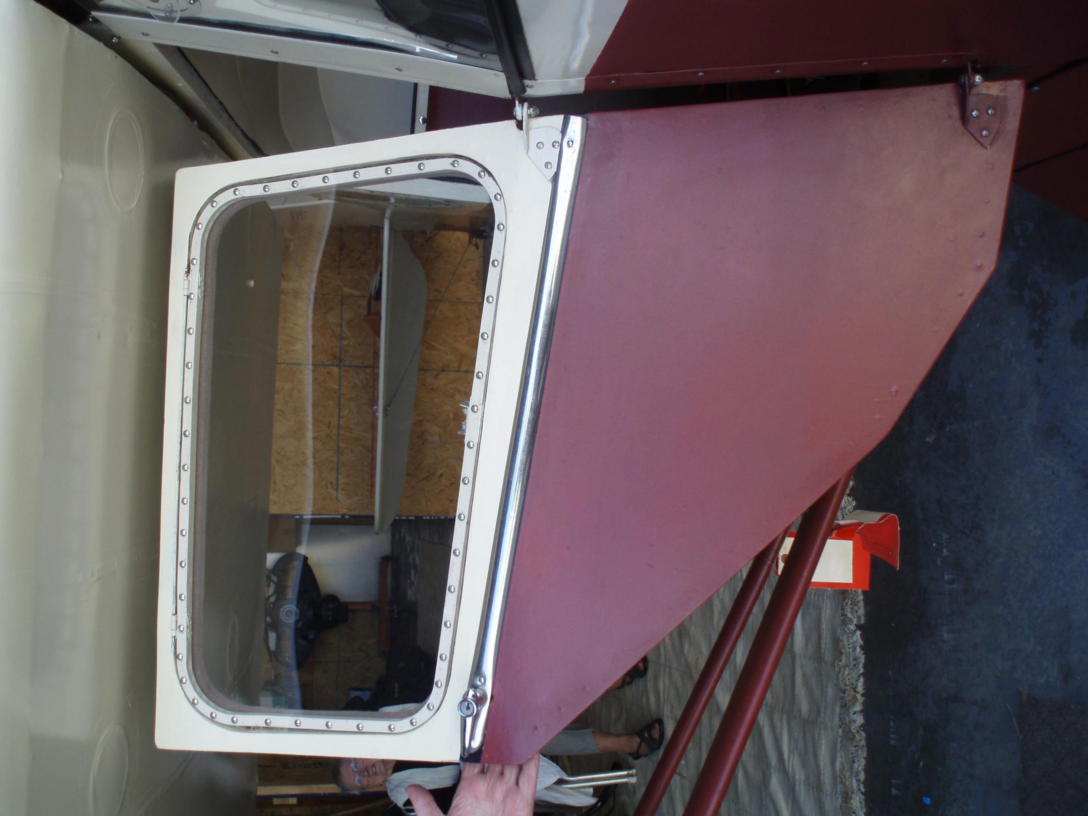

Here are photos of the door and boot cowl trim. Kind of hard to see the trim on the boot cowl (last photo) but it is the only shot I have with a boot trim on. The lengths of the door and boot trim are pretty constant for all the 41s but the cowl length could be different if anyone ever changed the engine size or mount to make yours a long cowl for a starter. Sorry about the 90* rotation on the door alone, I didn't notice till it was already attached.
I originally just painted a masked off area between the Maroon and Cream on mine and painted it with the Stainless appliance paint. From across the ramp it looked fine, but from under 20' it looked like a painted trim stripe. If you go that route, make the stripe about 1/4" narrower than the real strips and when you put the real trim pieces on they will cover it. I got away with it for quite a while. ;-)

Thanks Ray,
Those dimensions are just what I needed.
I see there is no length for the long strip. But that's OK because it seems like the long piece reaches almost to the end of the upper engine cowl.
That's close enough for what I'm doing.
