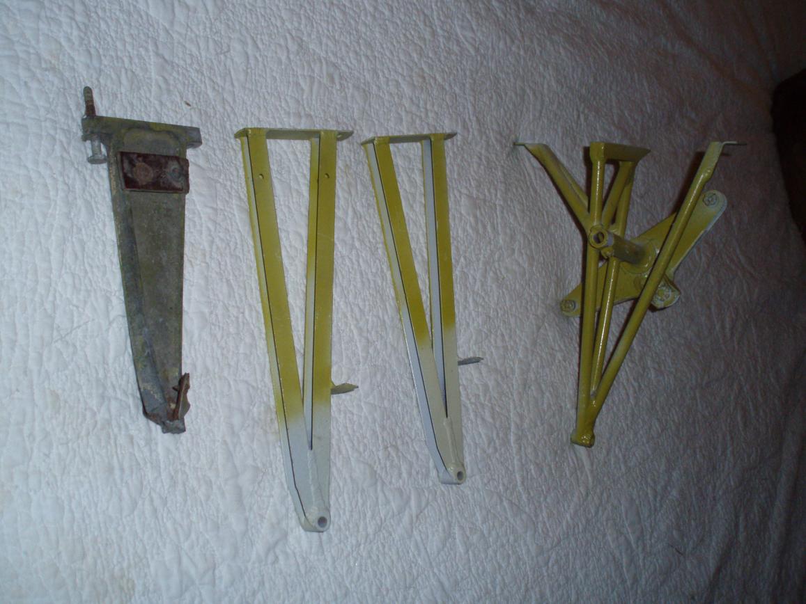

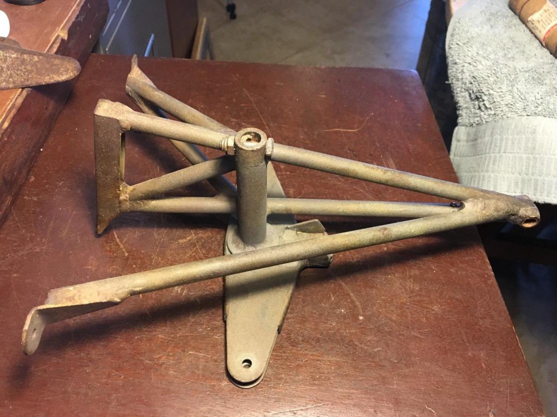

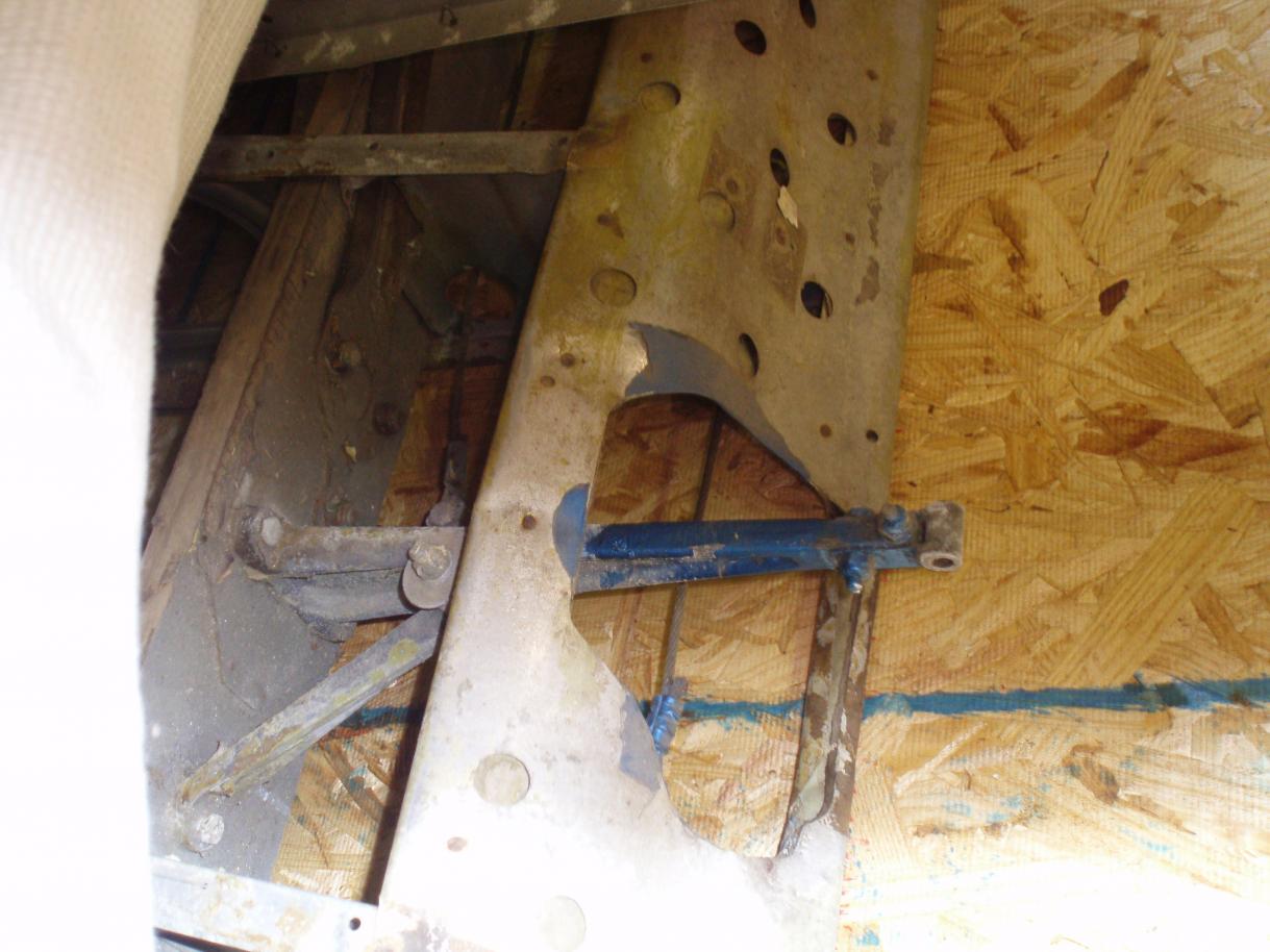

                  "Hank had made mention in other post about prewar hinges being sheet metal rather than cast mag. Id like to see what both look like. maybe the next post if everyone is in favor could be a picture post where folks can post up a pic of the pieces we need and if its pre or post war. I could start chipping away at the items that need to be modeled in cad." The pre war hinges are welded steel, not sheet. Far superior to the cast Magnesium post war hinges. Around WW-II Magnesium was considered the new "Miracle Metal" that would be light as Aluminum and strong as steel. "Not quite". Very strong for its weight but corrodes worse than an old far field gate and cracks if you look at it wrong. I have a few damaged Mag hinges that could be use to scan so an NC machined, high strength Aluminum or steel one could be made for very little weight penalty. Based on a letter from Dorthy when she ran Taylorcraft a pre war welded steel hinge can be used on post war wings but the geometry isn't exactly the same and some minor mods need to be made. I will try to post photos of each kind of hinge. Hank
                    Sorry guys, my group connection just crashed and I am just getting back on. Will try to post photos now. Keeping fingers crossed.

                      Notice that in the first photo the hinge end has corroded under the steel cap and failed. I have several hinges that are corroded there and if that had failed in flight I don't like to think what would have happened. In several cases I have seen SEVERE corrosion under the steel cap that was undetectable until you took the cap off!

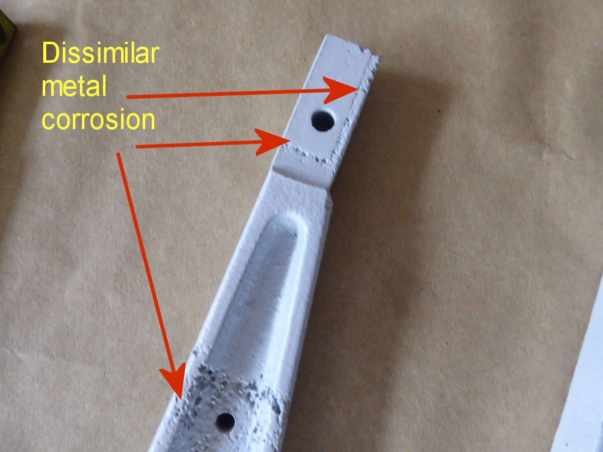

                        I hear and agree with Hank's comments.
                        During my rebuild I was fortunate enough to get some NOS magnesium aileron brackets from Harry (remember him?). I ensured that I provided a barrier between the magnesium and steel at the ends.
                        Funnily enough, the most corrosion (dissimilar metals) on my original 1946 brackets was between the magnesium brackets and the aileron cove...there is a little steel "L-piece" that is intended to provide some stabilisation for the rather long aileron attach brackets. It's the hole on the right of the attached photo. See also the bottom photo.
                        Full description of these brackets is still on my rather dated (now 20-years-old) restoration site at
                        I also attach an image of the dissimilar corrosion on my original magnesium brackets. I had bead-blasted them and primed them for posterity; rest assured they are not on an aircraft!.
