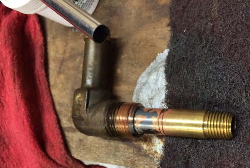

I must be bored, here is something that I found on the breathers....Tim
Breather Modification

I made one of these and installed it on my new C85. But before I ran the engine, I got cold feet and ended up buying one for more than $200.
I still get a few drips of oil on the hangar floor from the breather tube after every flight. And oil on the belly.
But I'm not complaining.Attached FilesTim Hicks

Can't fix blow-by past the piston rings or valves (via exhaust valve through the cover area) with a mod. They were designed for aerobatics (C-150 Aerobat) and can apparently reduce direct oil pickup in those situations. But if the crankcase if being pressurized via blow-by then address that. I did it to my PA-11 and it changed little on a tight engine. I did not have it done to my current ride as I wanted to know if and when oil blow-by increased so I could deal with the cause. A few drops of oil are expected on a non-oil fume recirc engine.

The key to the reorientation of the elbow is that the oil vapors condense on the inside of the tube and since it is tilted up the drops of oil run back into the engine. If the tube is turned down the drops drip out the end.
A lot of blow by will still cause some oil on the belly either way because you can't condense it all out. At least this method cleans up normal oil loss. If you still see oil on the belly it is time to look deeper.

Yes Hank that seems to be the case...upturned elbow helps. I started out on a fresh C-90 overhaul (last plane) with a normal installation. I was getting some minor dripping (maybe rings not fully seated or too much oil) so had the tech add the internal extension. Same bypass flow. He then turned the elbow up and it quit most of the outflow. But, in cold weather the exposed run of hose over the top of the front cylinder became a concern for moisture condensation so we lagged the fitting and hose with insulation and left the project for another.
I've installed catch cans at the outlet of the breather hose. Ran them into the side of a small firewall mounted (hose clamped) soup can that could be emptied. Also always add a pressure relief hole upstream in the hose or tubing in case the very end freezes. I prefer hose to metal as it seems less prone to freezing the contents. On one winter installation I used clear flexible tubing so I could see any internal blockage.
