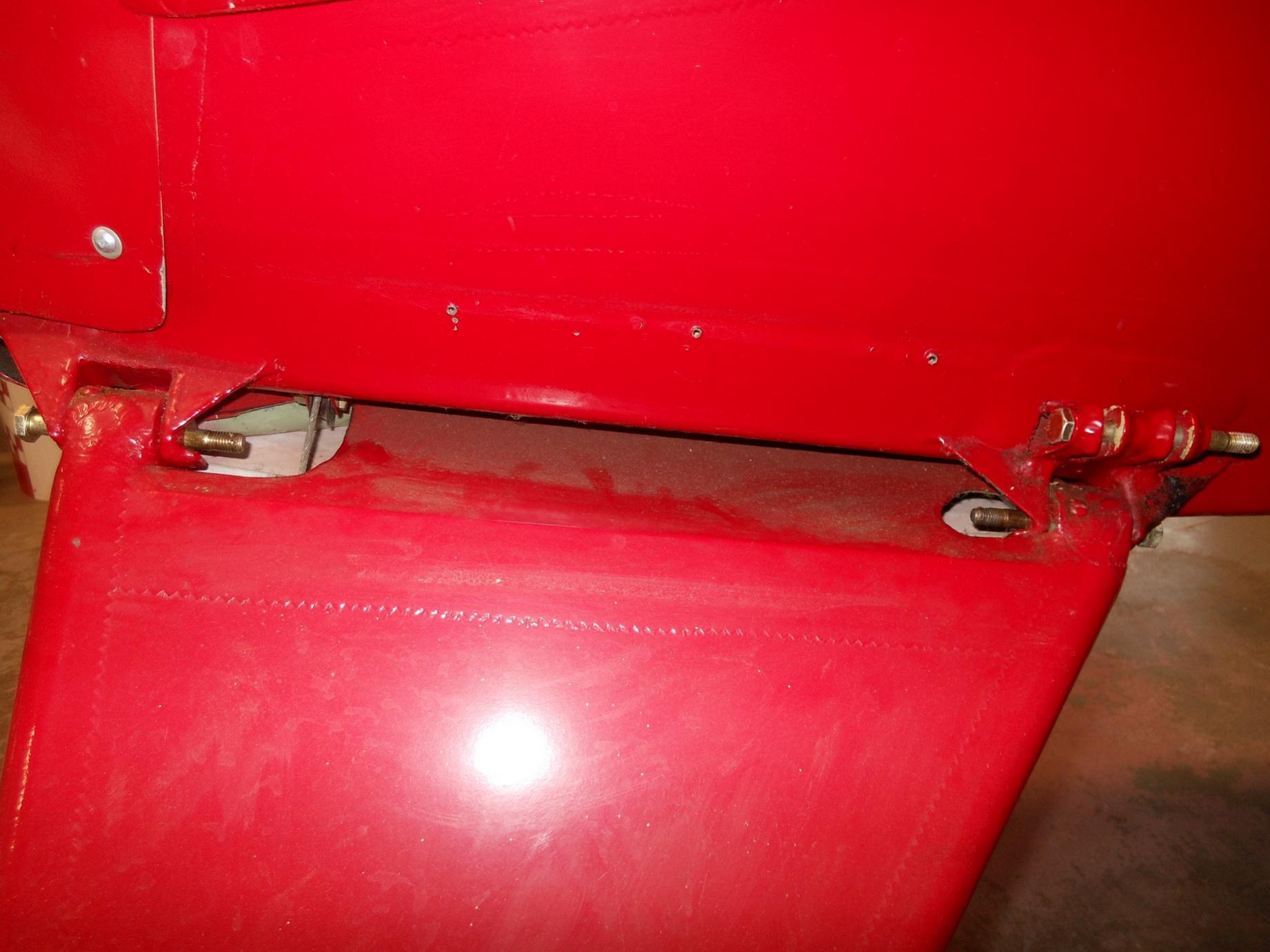

        Here is the gear leg.
        • #49
          Re: New 1940 BC65 Restoration.
          Perfect, Now I see how it was done.
          Thanks
          Jerry Hays

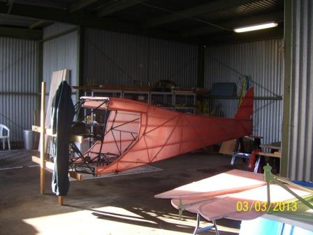

            Moved the T-Craft to my new hangar at SAC (Sacramento Executive) last weekend. I had put my name on the waiting list 8 weeks ago and was expecting to wait for months, lucky me, I got a call two weeks ago.
            Much better then my garage, and only 5 miles away from the house plus I am now around airplane noise
            Jerry Hays

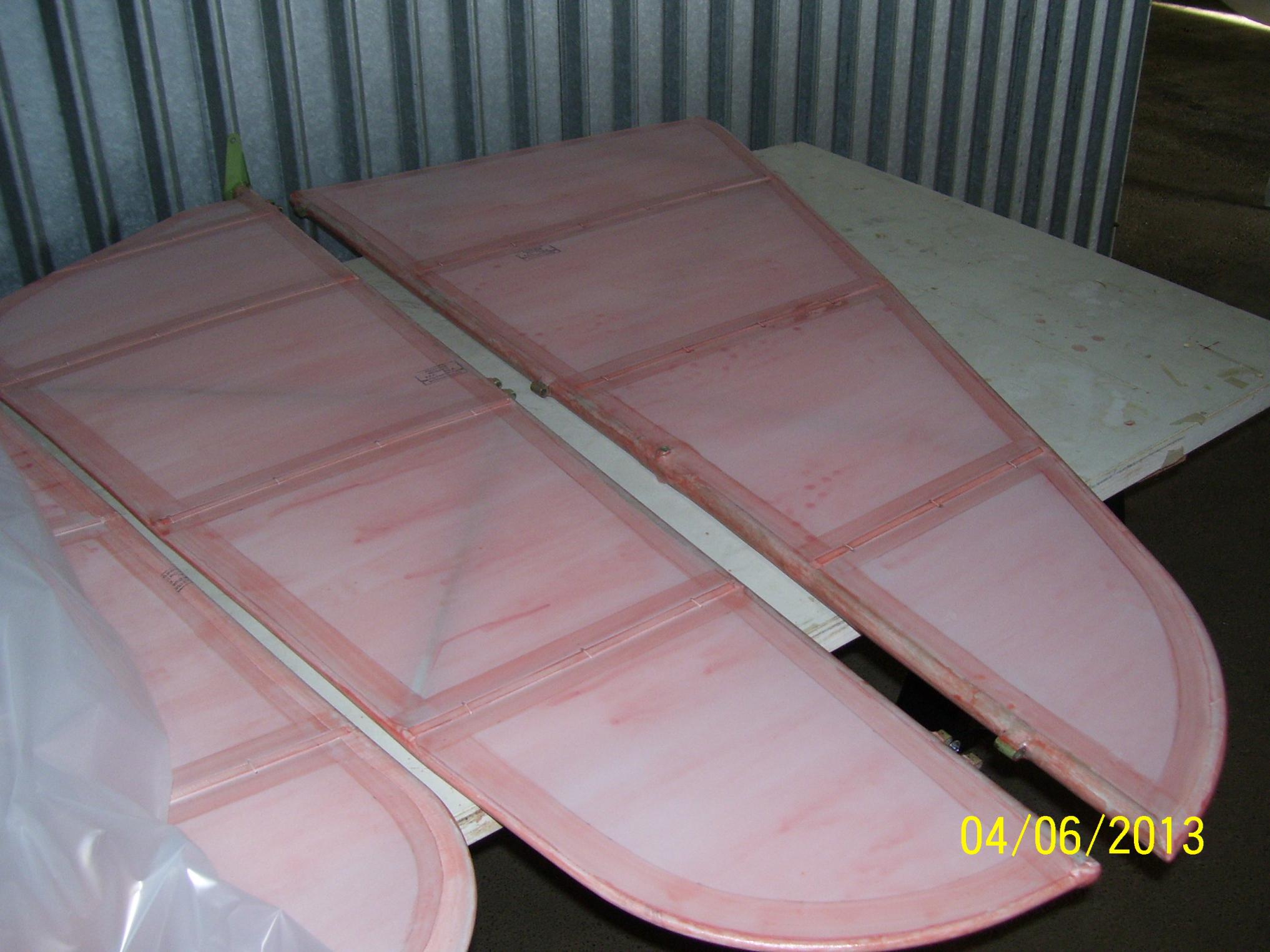

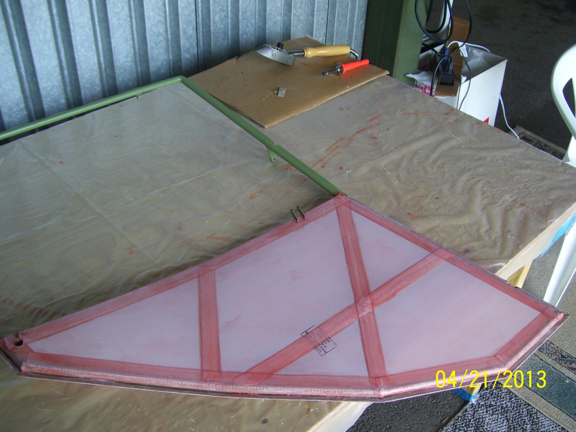

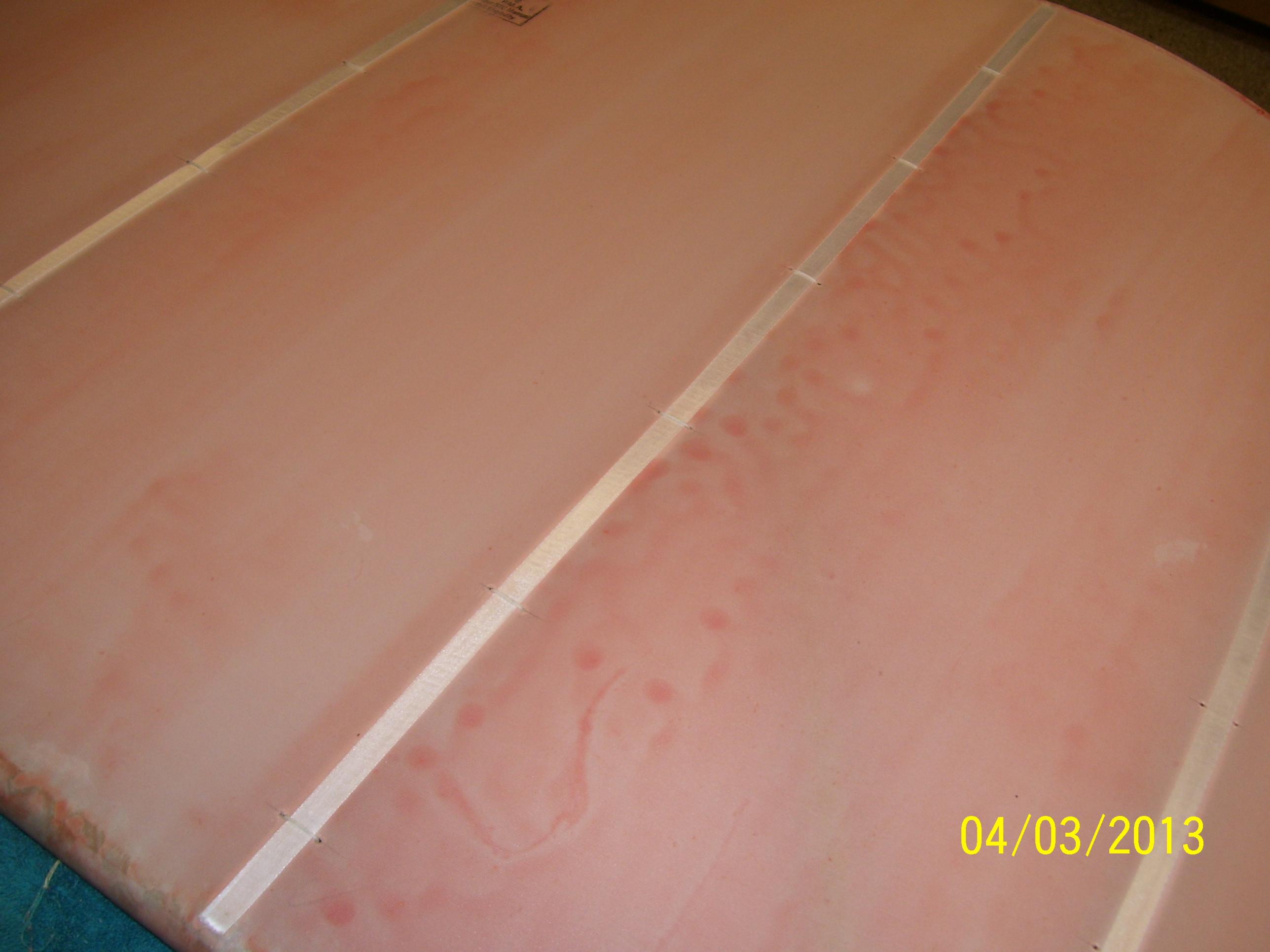

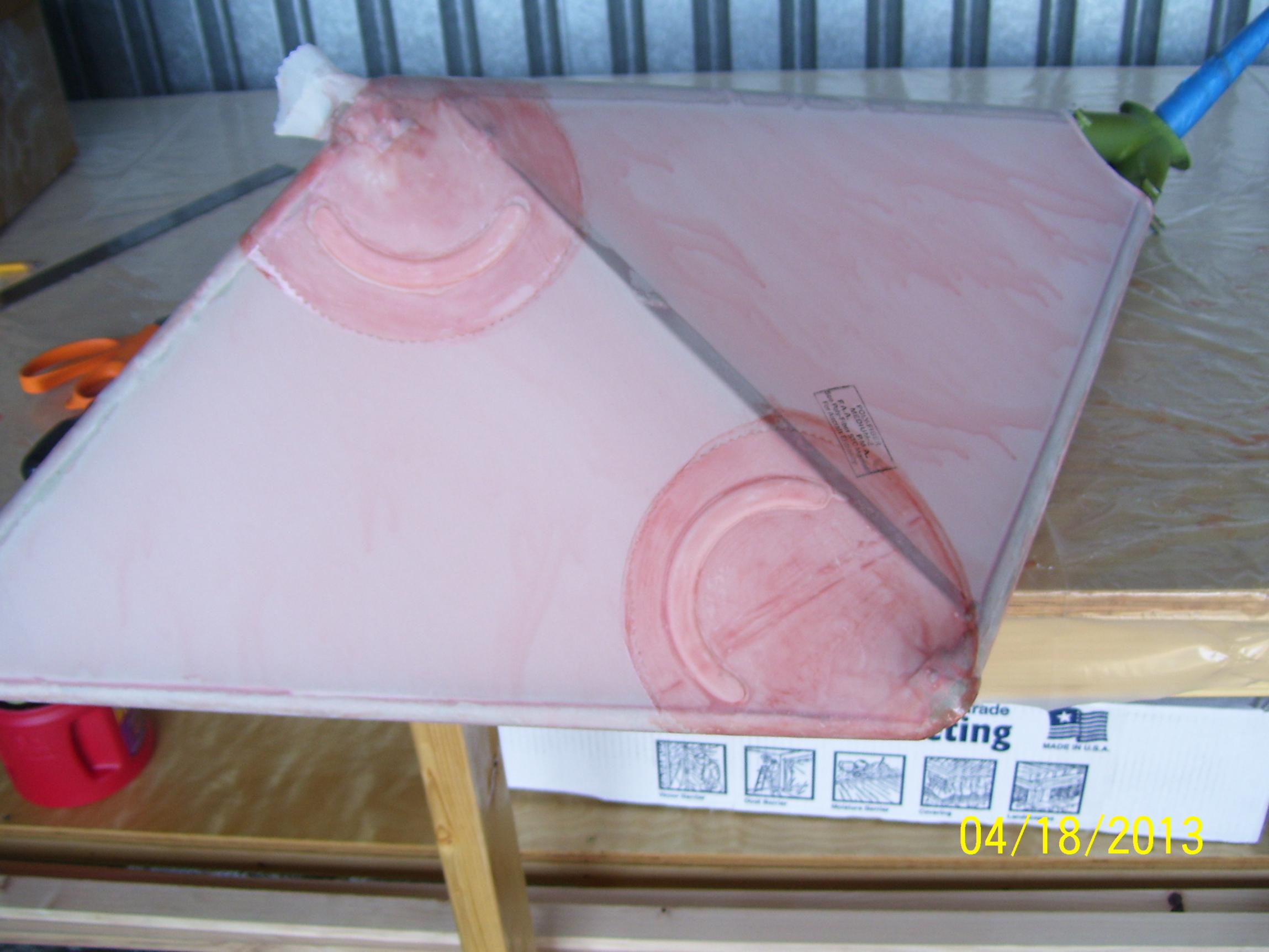

              Here are a few update on my restauration project.
              Finished covering all tail feathers, landing gears and doors.
              Rib laced all tail feathers, I got that down to a science now
              Tapped the doors and in the process of tapping the tail feathers and landing gear.
              Here are a few pics
              Jerry Hays

                Jerry,
                Nice work! I have never seen partial inspection rings used before. My gear legs just have small openings created using a soldering iron. Looks like you will be putting on the silver soon.
                Richard Pearson
                N43381
                  Thank you, I have covered dozens if RC models but this is the first real cover job, I guess it helped.
                  Yes, the half inspection rings, I figure that a little reinforcement in that area would not hurt, I'll cut it open after I spray all of the silver and color coats. I'll be working on taping the tail feather and gear next.
