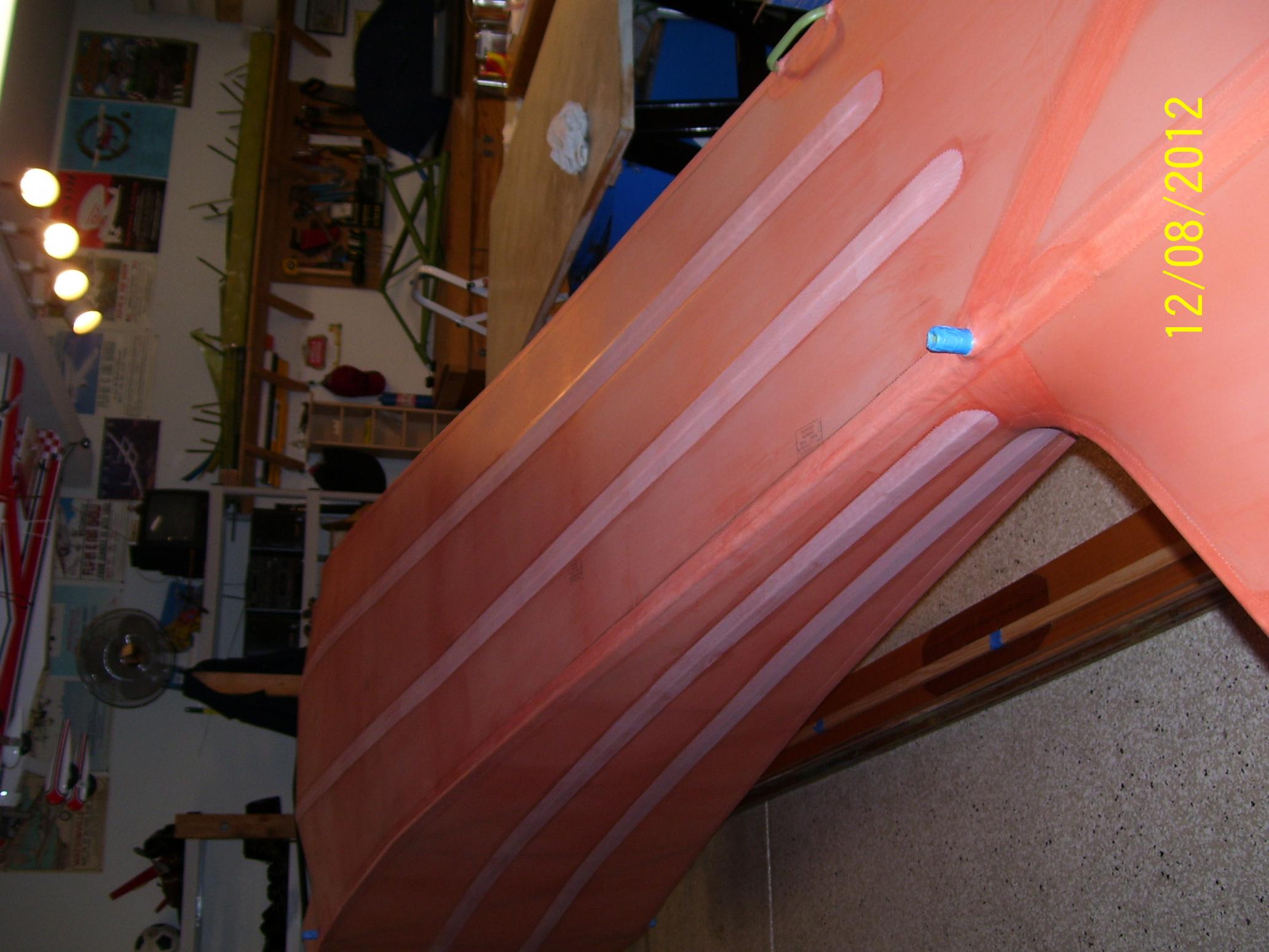

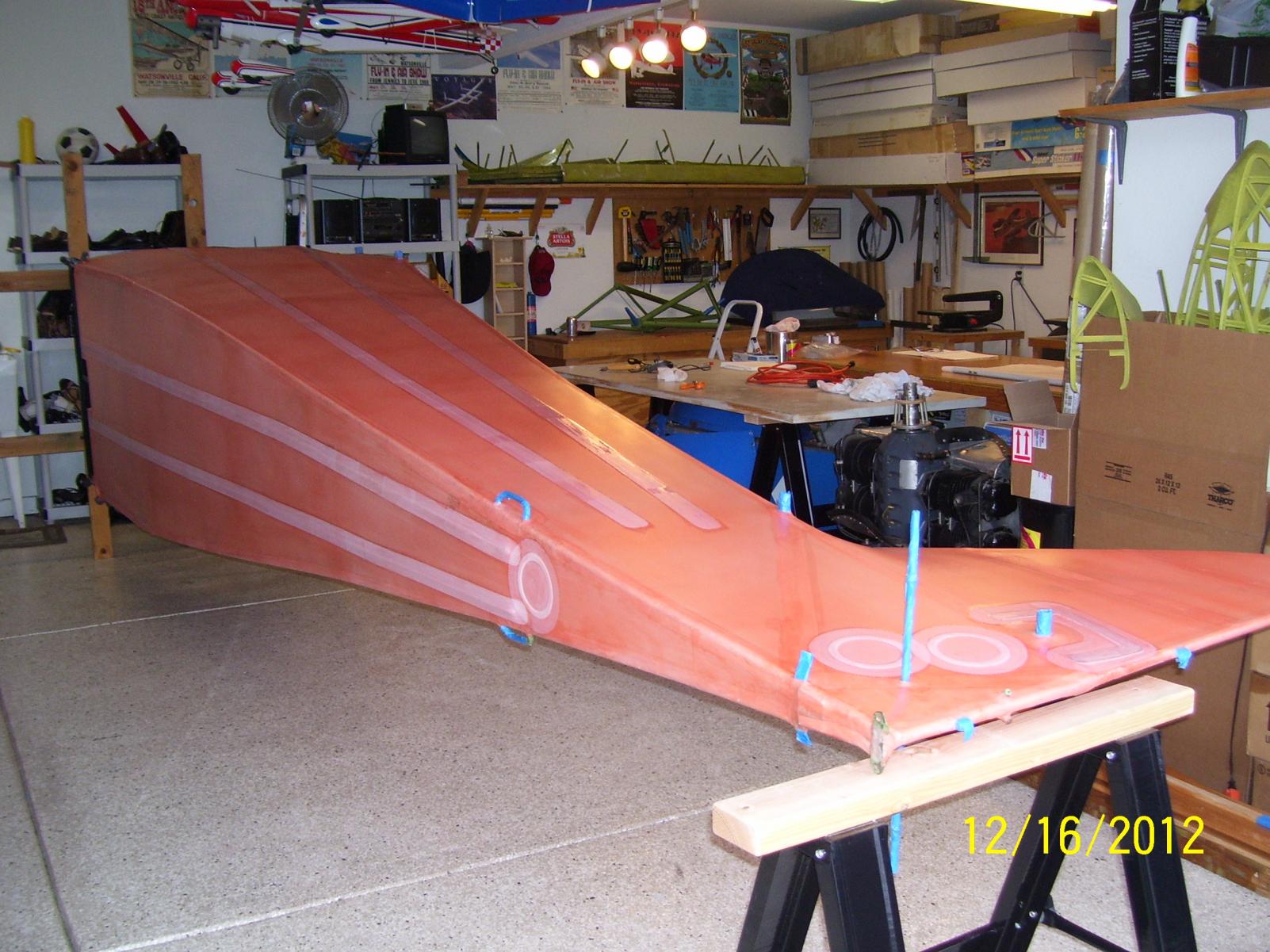

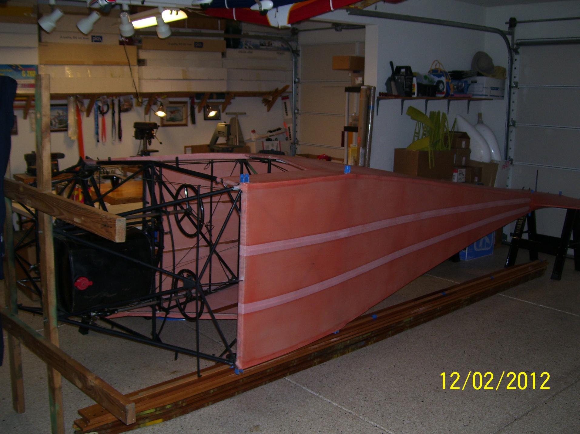

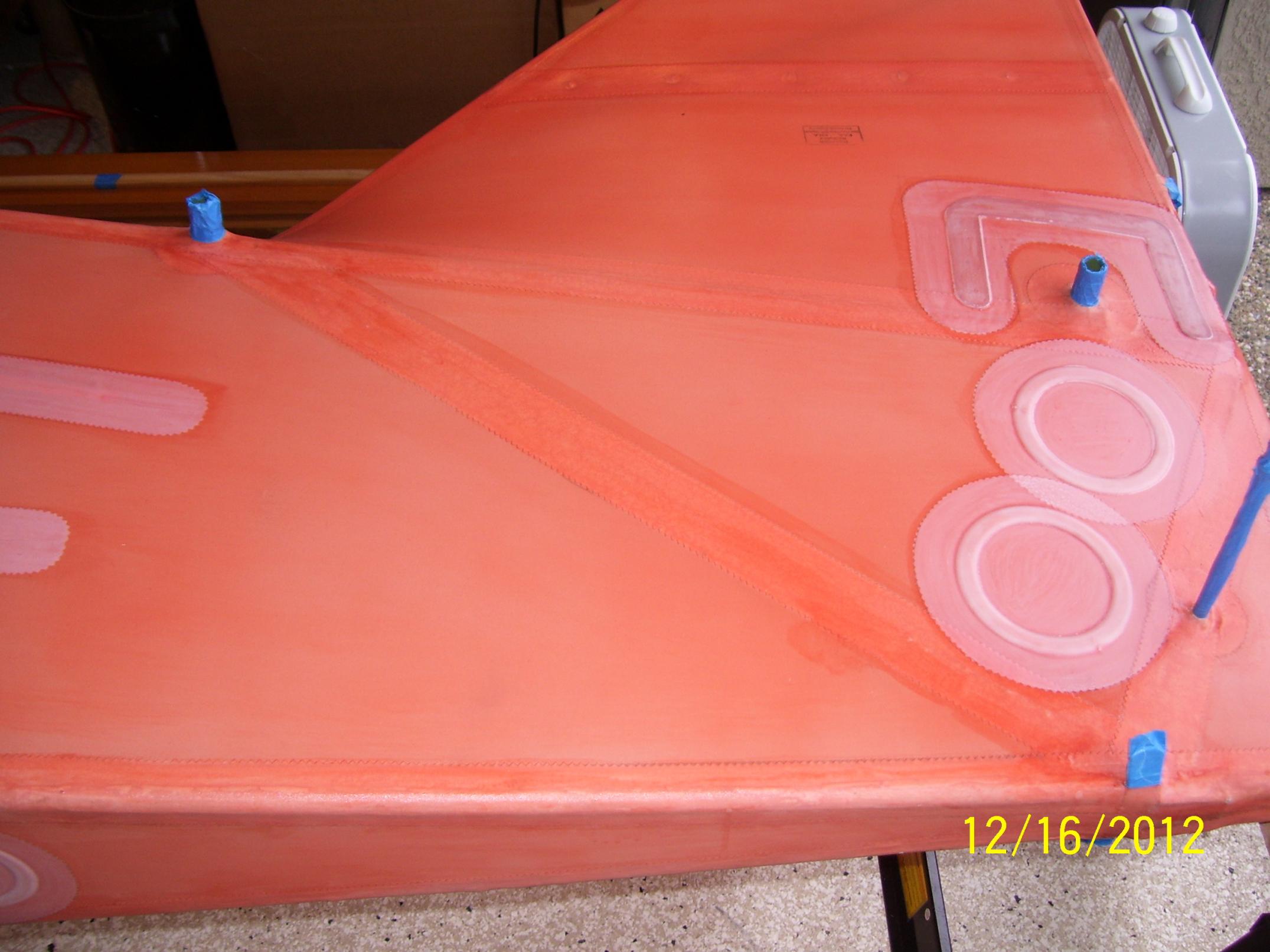

    So to refresh everybody's memory I have attached the latest progress on my project.
    Currently covering the tail feathers.
    Question, what is the stitching interval measurement for the tail feathers, 4"?
    Thanks all!

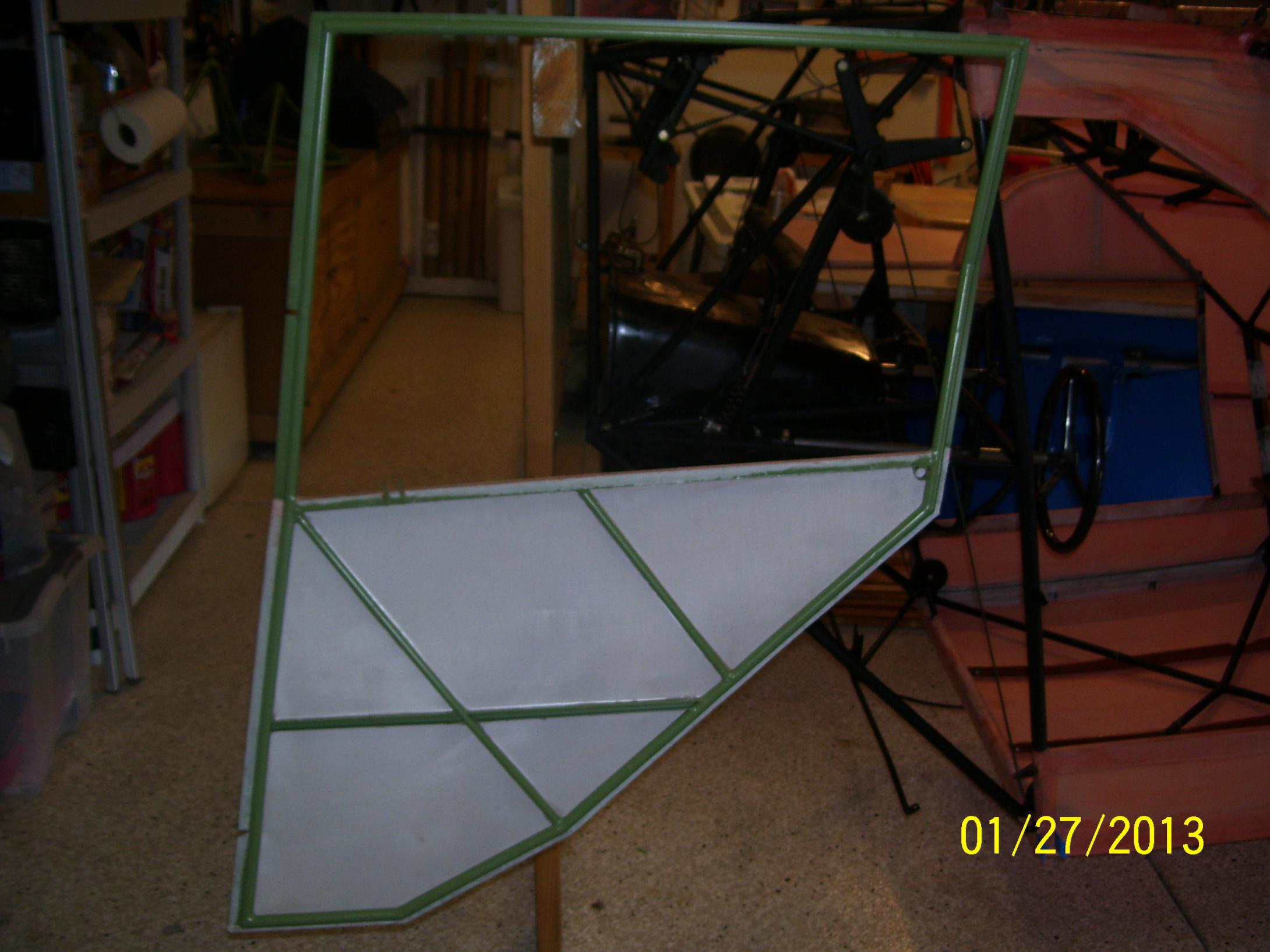

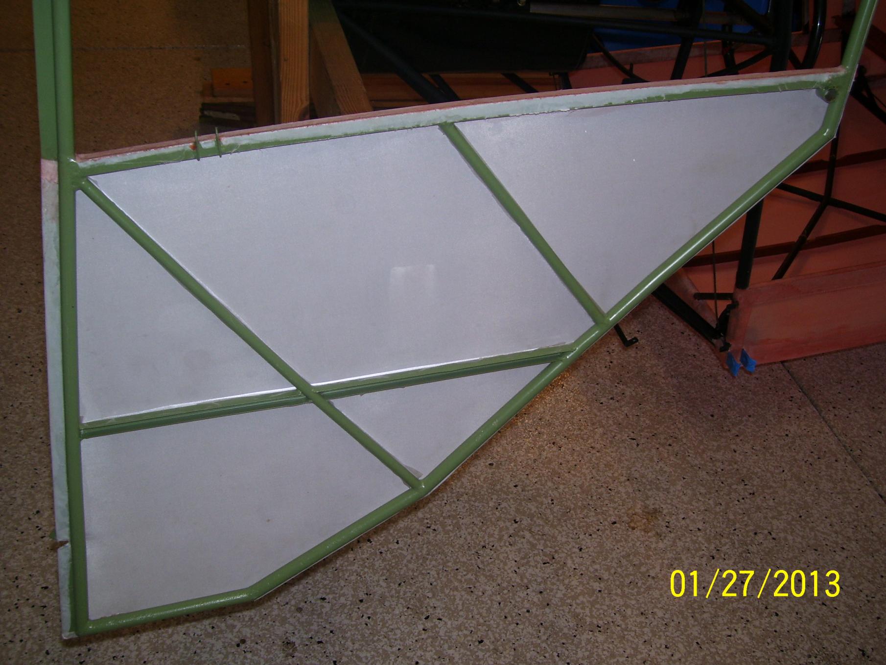

                            Question to the group.
                            I am covering the doors of my 1940 BL65 project, is the inside of the doors also covered with fabric?
                            Thanks
                            Jerry Hays

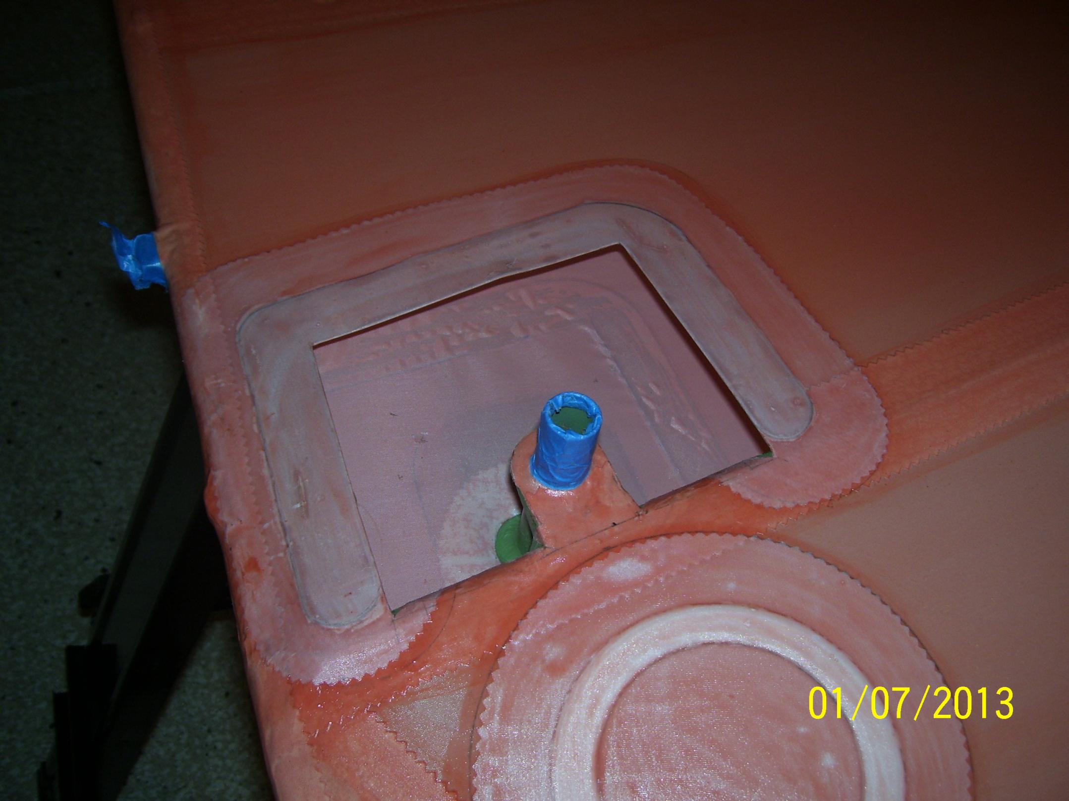

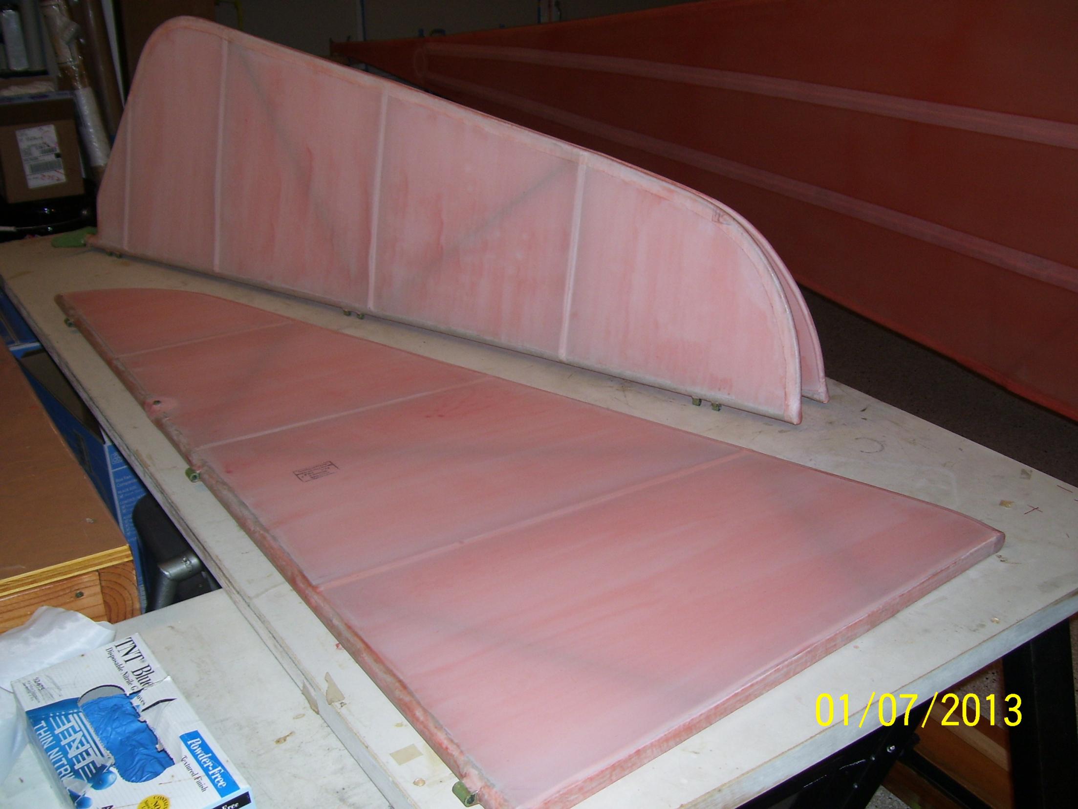

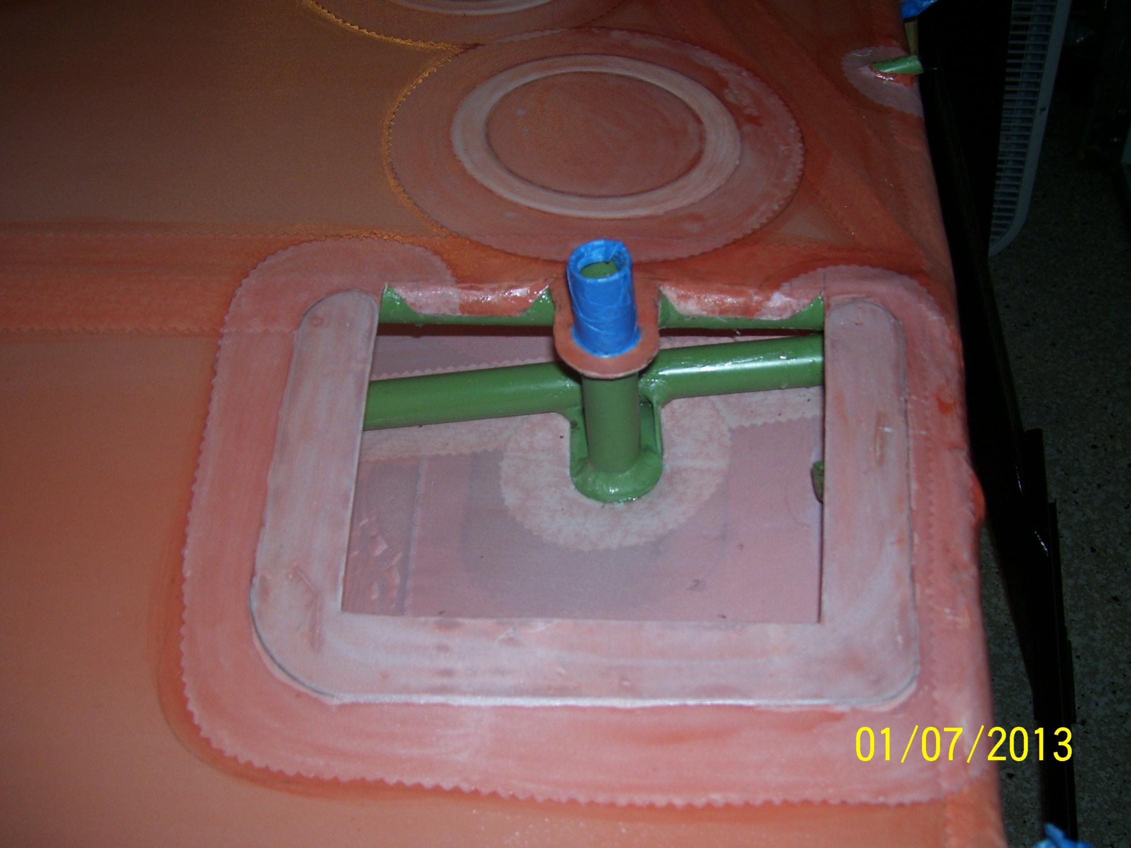

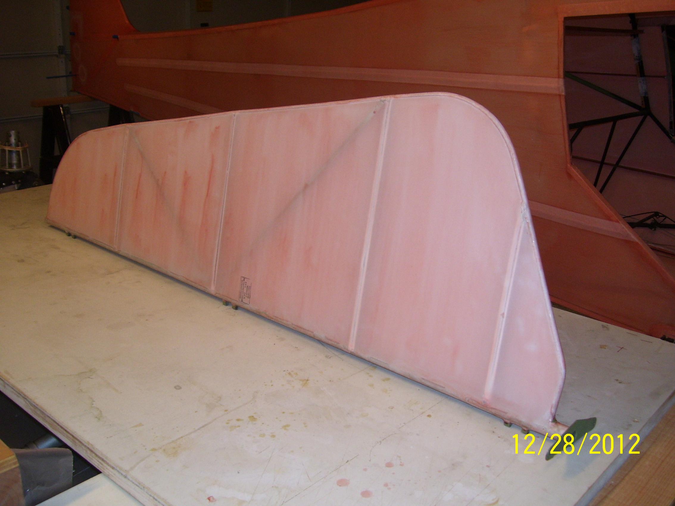

                              Some updates on the project,
                              -Finished covering the horizontal stabs and elevators, next will be rib stiching them and finishing tape.
                              -Also cut open the inspection area for the elevator control horns and folded and glued about 1/2 inch of fabric on the inside of the frame.
                              -All finishing tape is done on the fuselage.
                              -Will cover the doors and rudder next.
                              Jerry Hays
