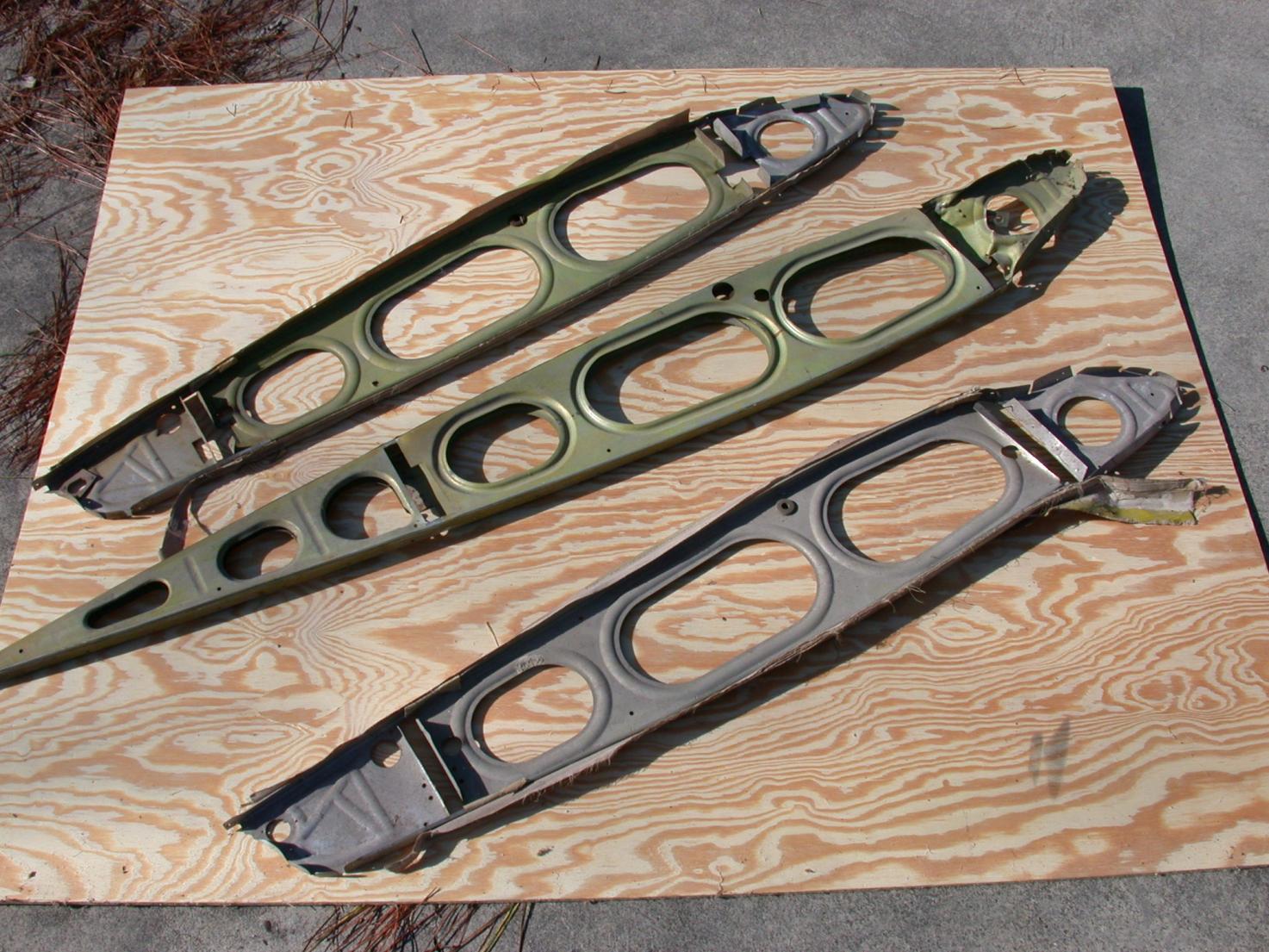

    Pre war ribs look like the photo attached. The later wings had 15 ribs instead of 13 and used stamped sheet metal ribs like the second photo. What do you need them for? Usually the pre-war ribs are used by more "anal" restorers (why are you guys grinning and looking at me?) since plenty of the stamped ribs are available and are a lot less damage prone. The weight difference is fairly insignificant.
    Yes, I know the stamped ones are bent up and the stick ones are nice, but give me a break, the stamped ones in the picture came from my 45 after it was flipped on it's back. the built up ones would have been mangled after that.

      There is a couple versions. Some had the nose "X" braced instead of one diagonal brace. I think those were the later ones. Also the 15 rib wings were 1200 gross which was only on the DeLuxe prewar and the '45 postwar. All others were 13 as hank mentioned. BUT the '45 wing was still different and had a postwar style leading edge and wing tip bow.

                  Been listed MANY times and unfortunately WAY over priced. If they are building up a tow plane they really should look at the stamped rib wings. Less expensive, stronger and MUCH more utilitarian. I have two planes with both types of wins and the stamped ones are better for any working plane. The weight difference is insignificant.
                  Use the money saved for a larger engine and good climb prop. Also make sure the cooling system is done to perfection. Tow planes burn up engines.

                          For those of us who have an "originality fetish" the "T" section stick ribs are the way to go, but that is because we are nuts. Having one plane with each type of ribs I can't think of a single reason to use the pre-war ribs except that you can use rib stitching instead of the Taylorcraft wires (and having done both of those why would ANYONE ever want to use rib stitching?)
                          I plan to put built up ribs on Josh's plane because he had said he wanted to return her to original (which is a shame since I have plenty of ribs to go with stamped rib wing). If anyone wants to swap built up ribs for stamped sheet ones I am open to trade, and if ANYONE comes across a 1940 orphaned fuselage for the project please let me know. I KNOW there must be a pre-war fuselage gathering dust somewhere.
