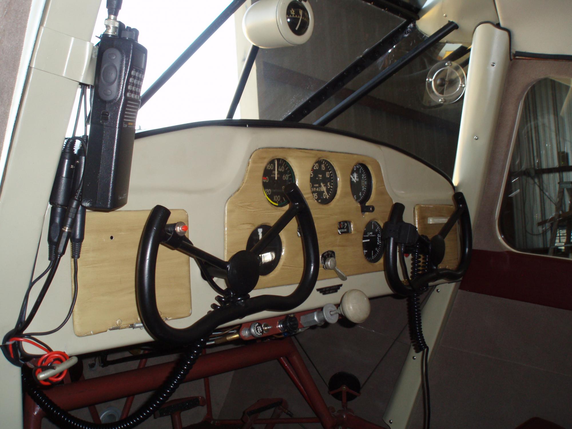

Let me try this again. For some reason my post didn't go through. The uncovered tubes in the cockpit (the ones visible from the seats through the glass, including the tube through the "D" window) are matt black on mine. The tubes for the door hinges (the "A Pillars") are wrapped with sheet metal covers that are painted beige. I found a match for the color in hardware store spray cans called "Putty". I think it was Rustoleum. The base color for the panel was the same with Faux wood grain for the insert and glove box doors. Under the doors the covers are aluminum colored (aluminum paint seems to last better than actual bare polished aluminum).
In the picture I have since routed all of the radio wires behind the "A Pillar" covers and I hope to make a new mold for the missing glove door handle.

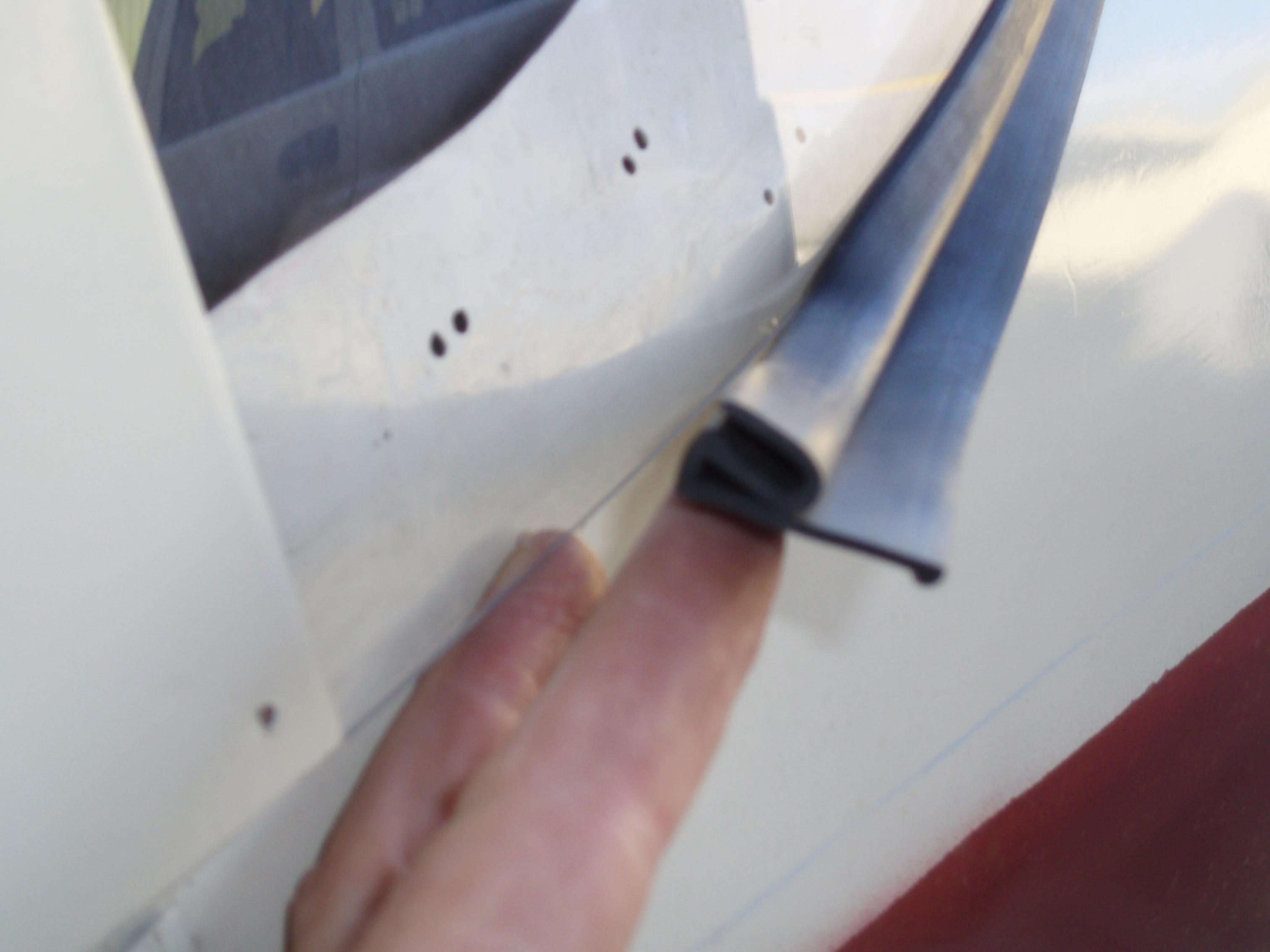

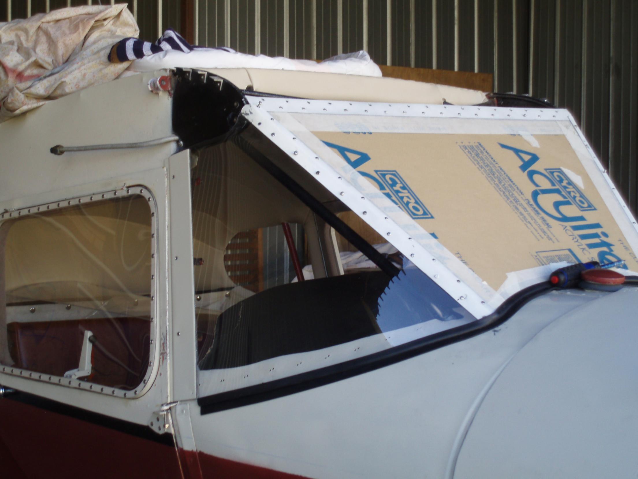

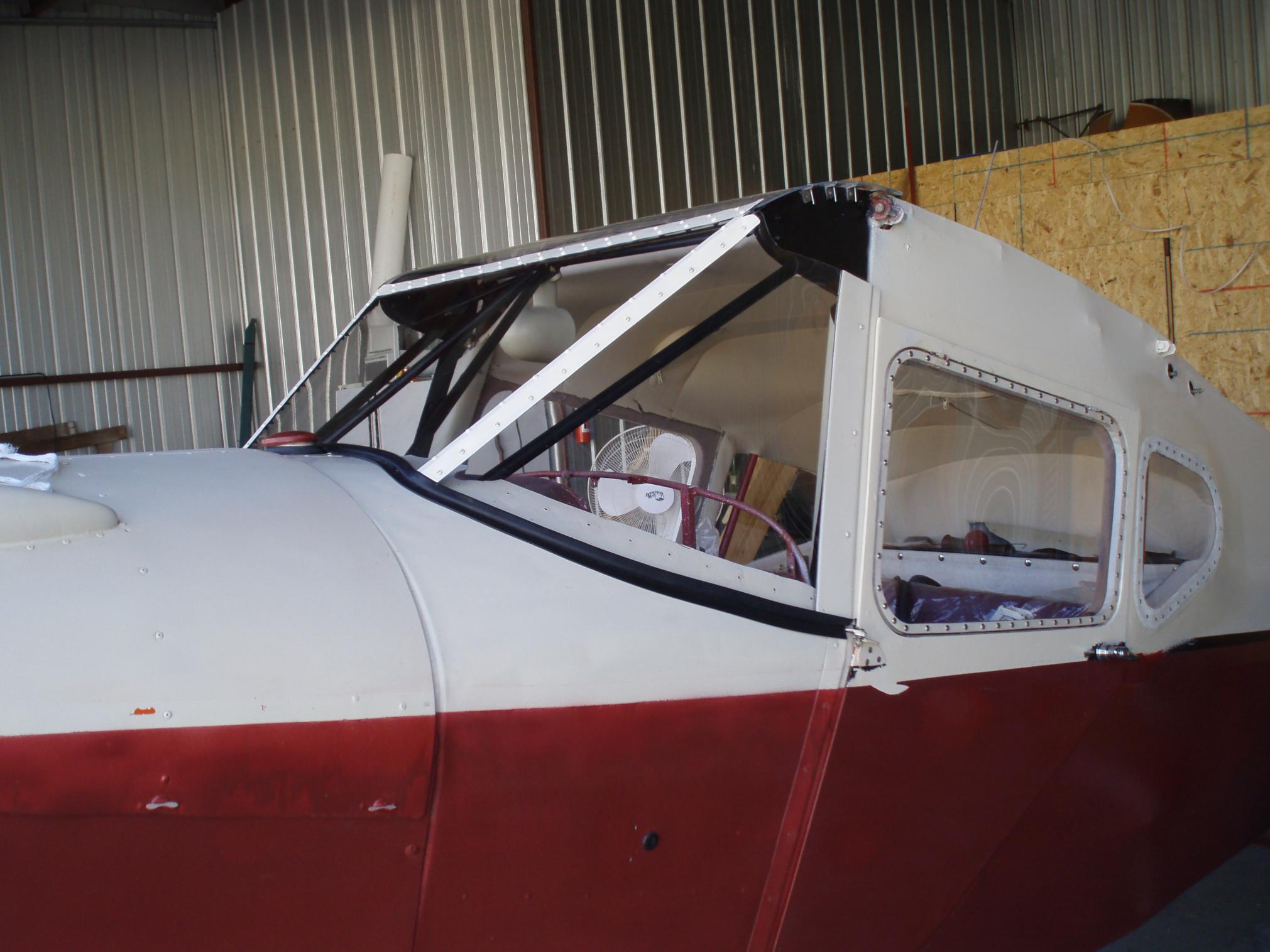

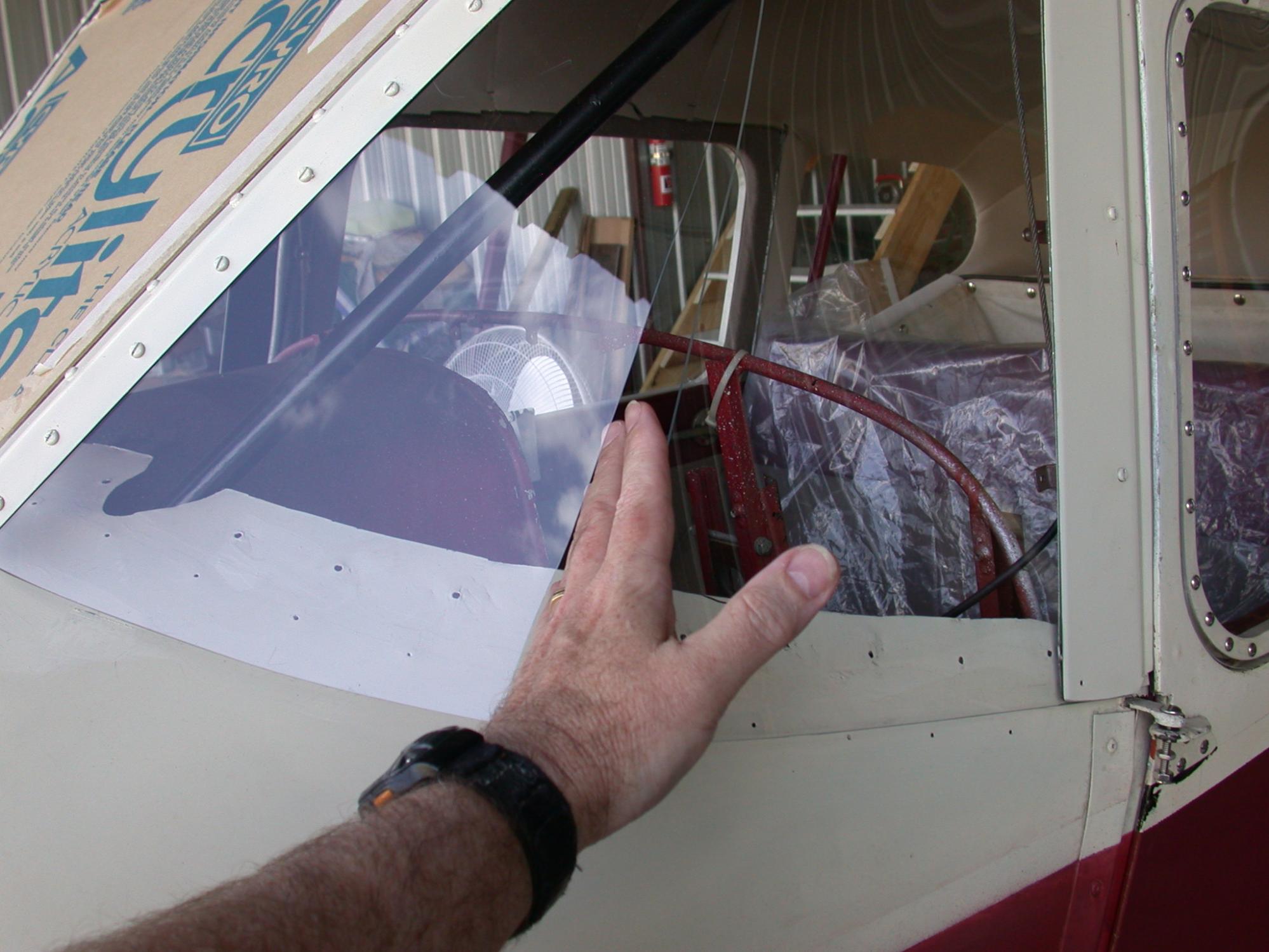

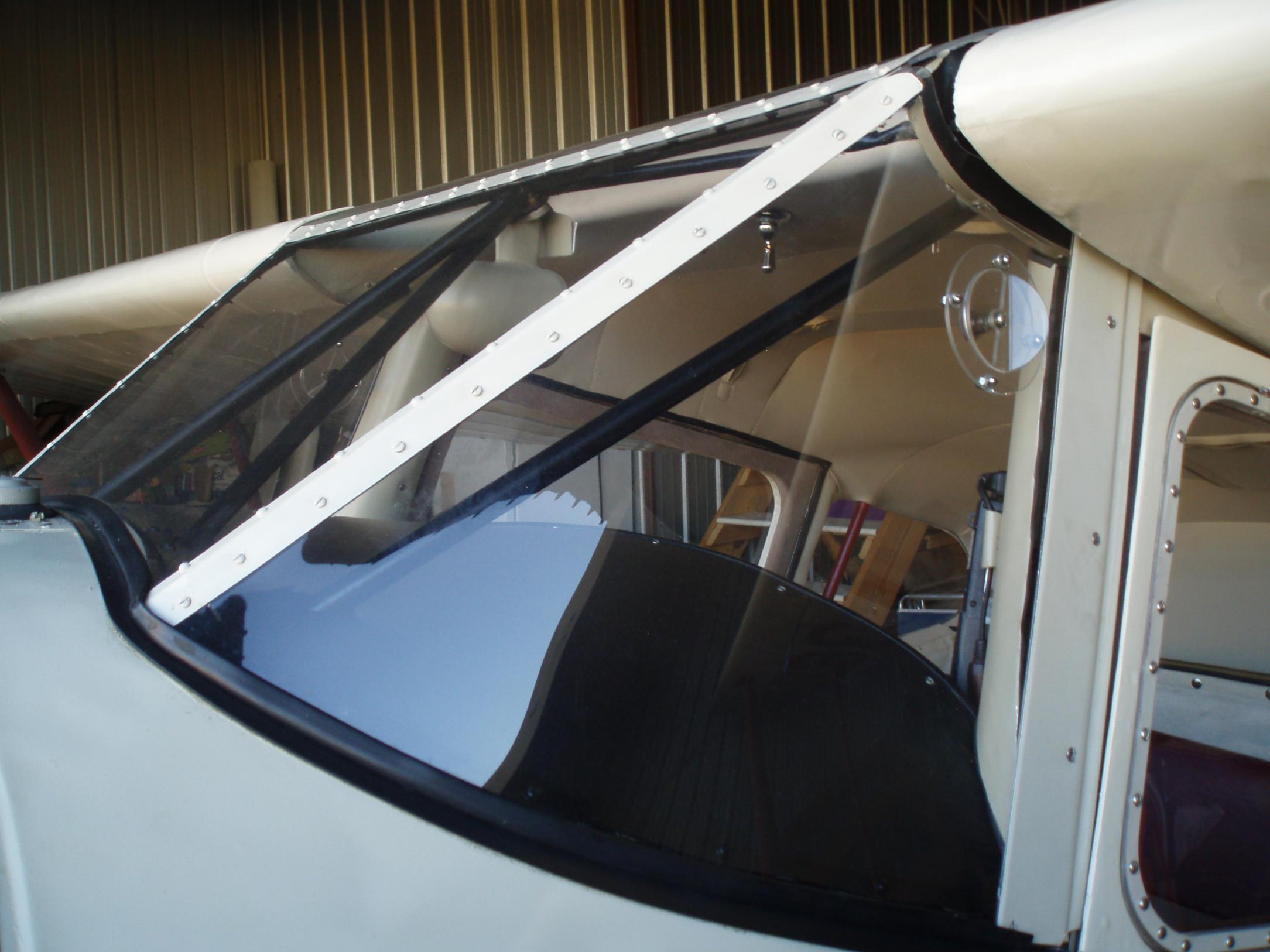

I am in love with the 4 piece windshield. The more I look at it the better it looks. Of course there were some pretty painful parts too. The windshield (the front part) was custom cut at a plastics manufacturer and all of the holes were drilled there since a crack in the main piece would be pretty expensive. The front piece is key since it has to be made to fit your boot cowl and wing roots and each plane is a little different. If THEY cracked one of the holes, they were responsible. Each was drilled oversize and I put a piece of small model plane fuel tube in each hole so the screws wouldn't bear on the Plexi. The holes in the metal strips were drilled to match the Plexi, NOT the other way around! I made the windscreens (the side pieces) and the top transparency. The top was easy, but he sides were a PAIN. If anyone else does this pick the HOTTEST day of the year to do the actual instillation of the side glass. I have a whole stack of broken windscreens in the hangar. It didn't work until I "broke the code" and attached the front edge with the plastic sticking out and the metal frame not pulled down to the "A" Pillar (the door hinge tube). I pulled it on a day when the temp in the hangar was 110*F and used a tile gun to GENTLY fan the plexi till it relaxed and slowly curved down for the bolts to hold it to the "A" pillar. Even then I came out the next day and the pilots side was broken the first time (see photos). The cause looked to be a small "nick" on the top edge where a crack started as it cooled. What finally worked was to heat the plexi, on a REALLY hot day till it was SOOOOO CLOSE to bubbling (there are a few up under the wing fairing) then keep it very warm over night so it would hold its shape (August in SE Virginia is NICE AND WARM!).
After it was fully formed and had been in place a few months I took the curved piece back to the plastics contractor to have the vent holes made (it held its shape by then). He had NO IDEA how hard they were to make, but he did a great job polishing all of the holes so they don't start cracks.
If anyone wants to try it, it should be a lot easier the second time. The big thing is to keep the side pieces HOT. As for visibility, you don't even really see the frames since they are pretty much in front of the tubes. Get your pieces made and wait for your hangar to be unbearably hot. You guys north of the Mason-Dixon line need to plan some time in the south or have a BUNCH of heat in your hangar.
