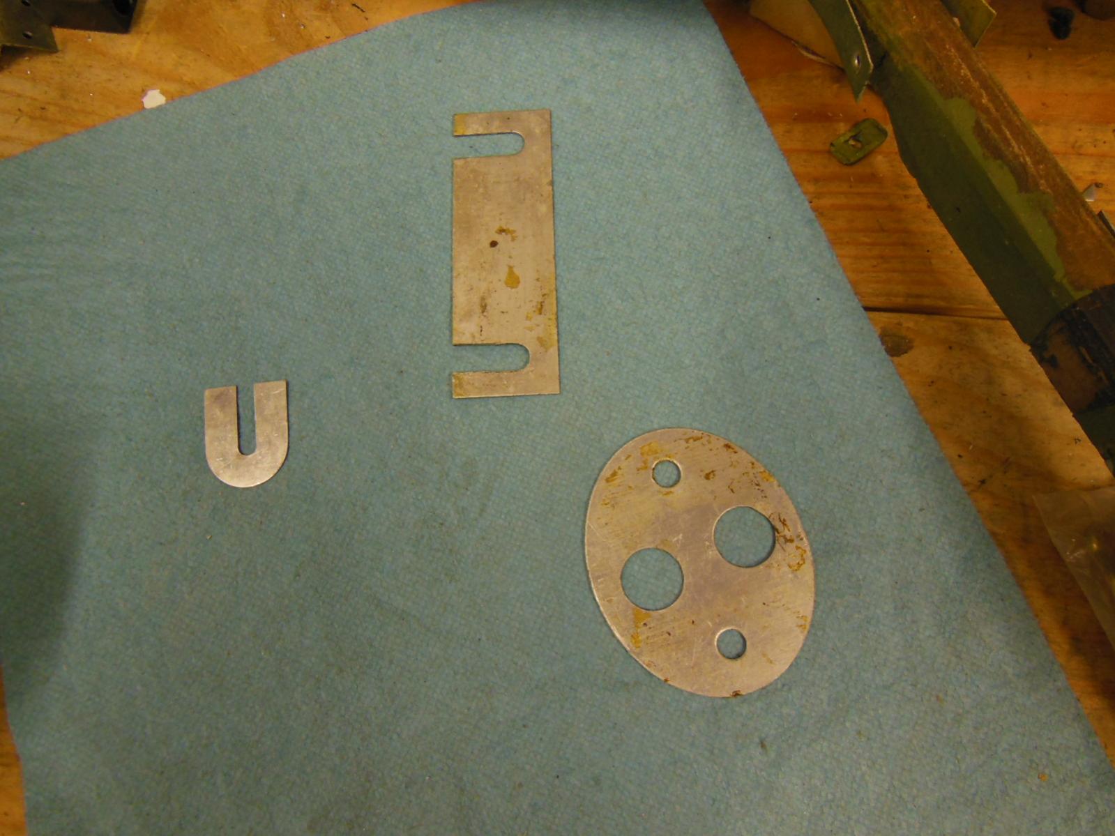

      Anyone know the difference between the B12-805, B12-806 and B-875 shims? My plans indicate B12-805 is required at butt end of rear spar and other shims are used "as necessary".
      • #33
        Re: BC12-65 Wing Rebuild
        I think that my answer is yes.
        I looked in my parts book and don't find the shims but they exist, I have a bunch of them. Will send you pictures Thursday.
        Tell me, what plan/drawing are you using? It sounds good.

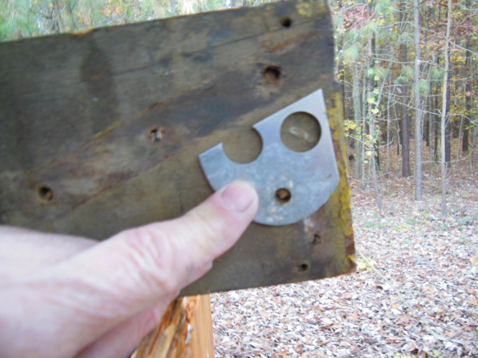

        The B12-806 is going to be an oval. The B12-805 is a B12-806 that has been cut in half on an angle (and is as thick as the rear spar butt attach fitting).
        I suspect that the B-875 is the little "U" shaped aileron hinge shim.
        • #34
          I will really appreciate your pics re these shims; the plans that I'm refering to are "TAYLORCRAFT AVIATION CORP, Frame Assy Wing, dtd 1/5/45 B12 A 836". I bought these plans from Tom Baker in Effingham, Il. You can call him at 217-342-3540. He has lots of TC parts and stuff. A very nice guy.
          • #35

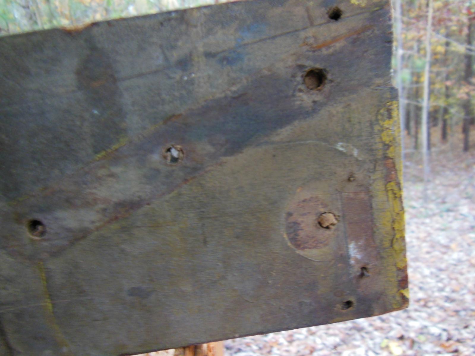

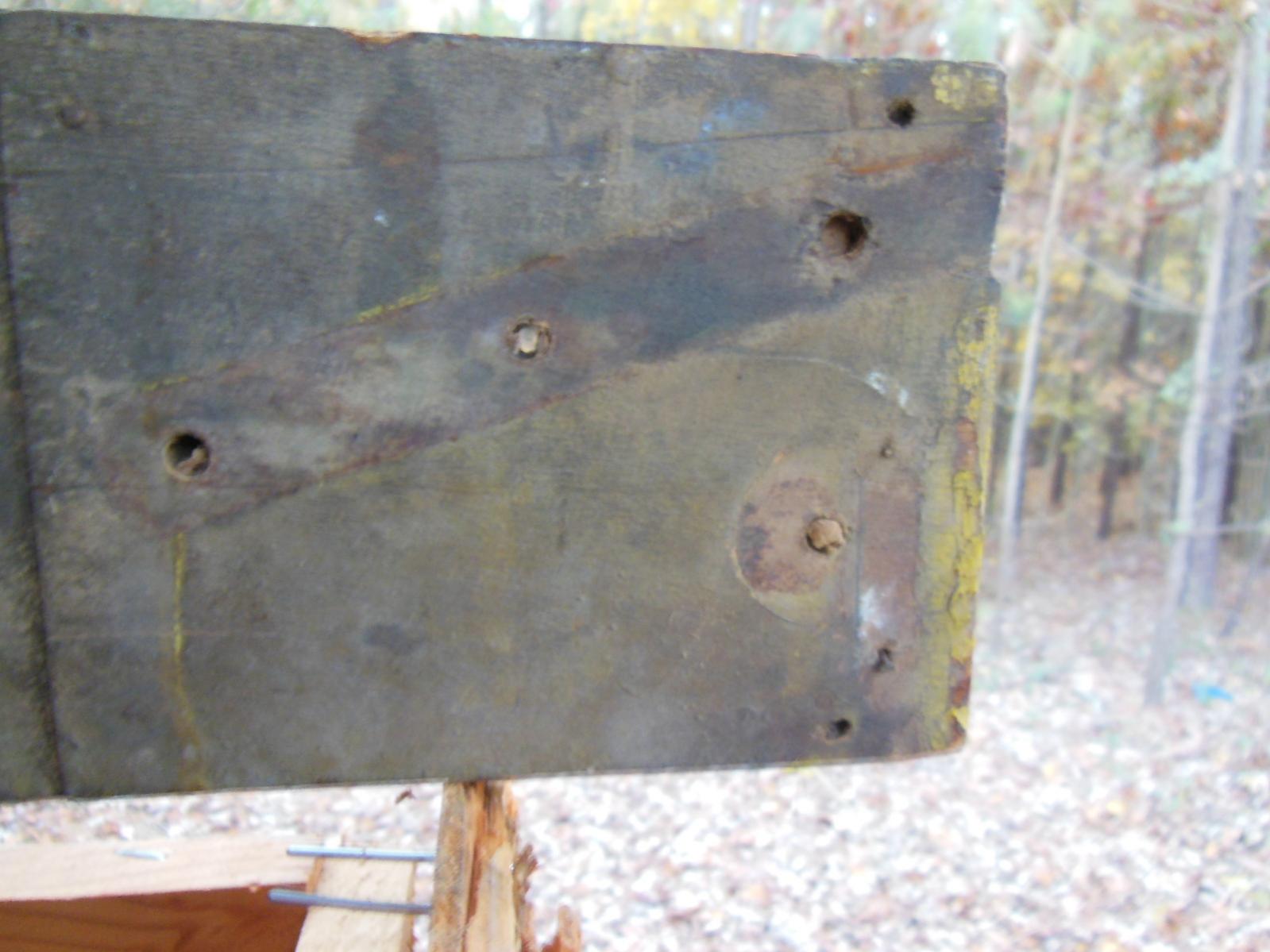

            here they are, the one at the butt has been cut from one of the others
            the "U" and rectangular ones are aileron end and middle hinge shims respectively
