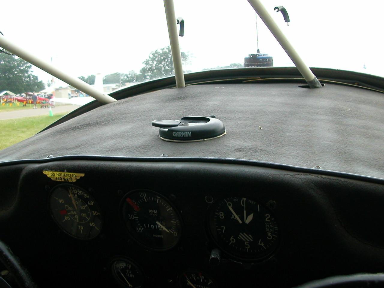

Wait a minute, I think I just found a photo of an original black cardboard glareshield. This is a photo I took at Oshkosh 2008 of Tyler Foster's 1946 BC12-D, s/n 8015. His cockpit looked mostly original, although his panel had no gloveboxes and his fuselage had no left cockpit door...Joel Severinghaus
Des Moines, Iowa
TF# 657

Re: Metal glare shield?
The cardboard one looks just like the stuff I got in Kansas City. It is really interesting that it is tucked UNDER the instrument panel in the picture. I put it on top because the pictures I had weren't clear. I like it tucked under better and may have to change that. No wonder the edge beading was so hard to get over the edge of the cardboard!
