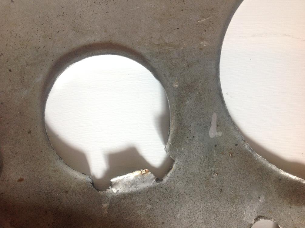

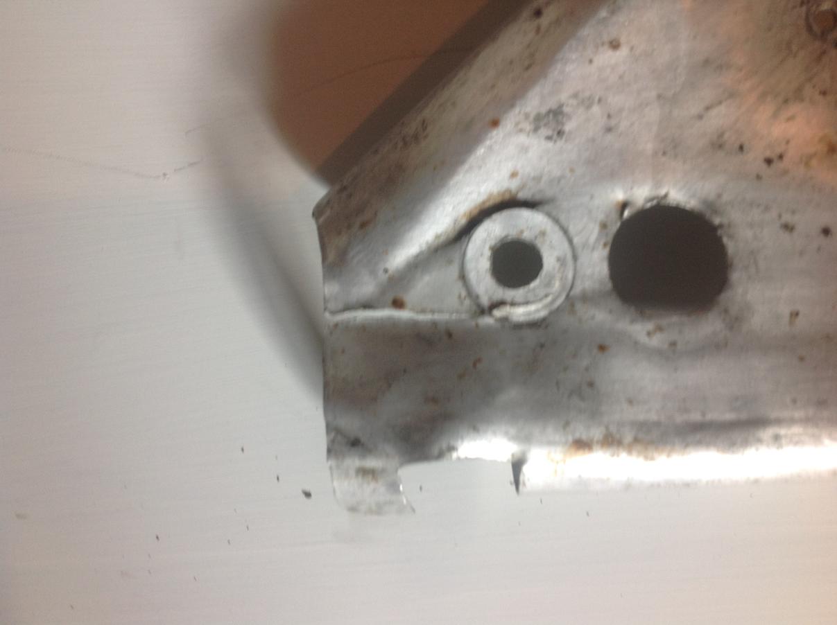

          I would add a flush riveted doubler BEHIND the panel and then do a cosmetic repair of the front aluminum. Using a SLIGHTLY flexible filler for the flush rivets and damaged areas would be pretty much invisible once painted and a lot stronger to resist future cracking.

              If they are small enough to be hard to see in a photo, a back riveted doubler with Poly-sulfide sealant between the pieces will be able to fix the panel structurally and hide the cracks completely. My cowl is repaired that way and the repair is solid with the added benefit of the sealant pushing through the cracks. Once sanded level (it is NOT easy to get it level!) and primed and painted it is almost impossible to see the old cracks.

                  Another photo. This time of altimeter hole which I wish to correct the cut out. image.jpeg

                    This is the area I'm working to correct left side, cabin and carb heat.. image.jpeg

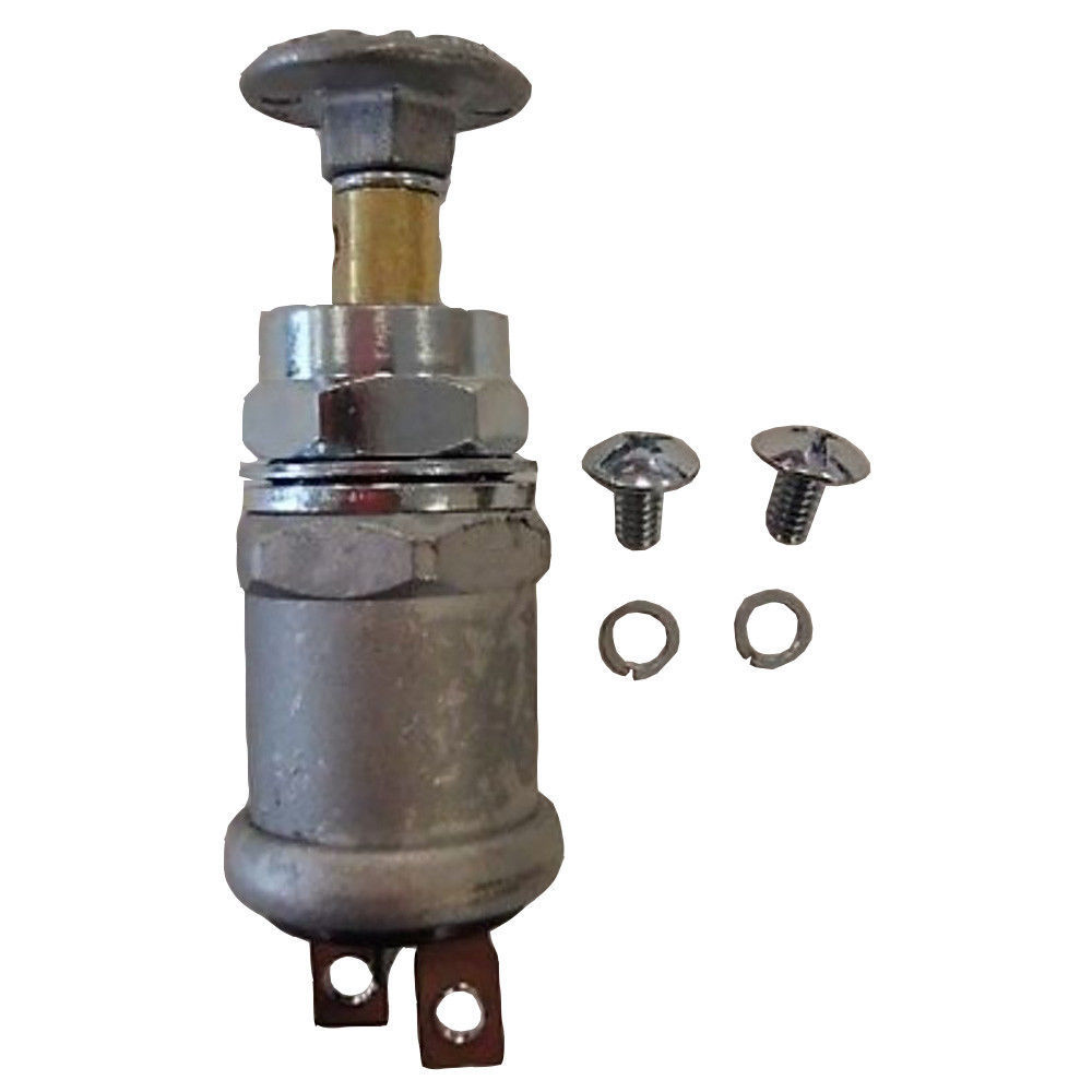

                              I have done several panels now (MUCH worse condition than yours) and made a 41 Deluxe panel from scratch. It is NOT hard to make or repair one, just time consuming. You will need PATIENCE, not skill. Really wish you were closer to SE Virginia. I would still say the best way to repair is a doubler on the BACK of the panel (forward towards the engine, not on the side facing you). One thing that is a bit harder is getting the rolled edge right around the instruments. An edge roller or form would make it easy but I didn't have one so I did it by hand. You CAN do it and it will come out looking like new. This is also your chance to go back to the original mag switches in place of the more modern (for the time) A-7 you have. The A-7 is NOT as reliable as the original or a modern mag switch. Your plane would have had two Farmal switches (one for each mag) from the factory and they are VERY reliable and inexpensive. They are STILL in use on tractors today!
