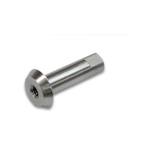

    Aircraft Spruce sell them
    Taylorcraft FAA / PMA Drag Wire Nipple These Drag Wires are made from 304 Stainless Steel, .125
