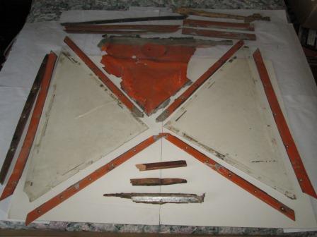

                  This is the remains of the skylight after I removed it. There are more wood pieces at the airport but they are pretty busted up. I am using them for patterns but they certainly aren't airworthy! The remains of orange fabric are the front part of the skylight. There are some damaged edge pieces for the windscreen in the photos as well.
                  One thing I have noticed when you compare a 41, 45 and 46 planes is the wood over the top longerons may NOT be the same from plane to plane. The top front cross piece (that holds the windshield top and trim indicator) are very close, but the side pieces seem to have been trimmed to match the root wing ribs. There was no wood cross member on my plane that touched the fabric (I have got to look at the wood pieces to see if there was a spreader to hold the side pieces apart and in place, it sure would make sense to have one).

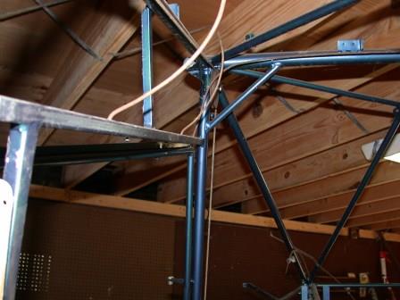

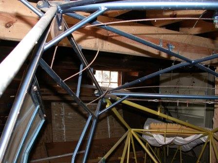

                    Another minor difference is that my plane was a "Deluxe" and had a full headliner. The sides of the original headliner were retained by a set of curved wires (between the door top and the top glass). You can see the wires in these photos.
                    Teh triangle skylights provided great viability but didn't turn the cockpit into a furnace. They also added some extra headroom. I do plan to add some small Velcro strips around the edges so I can put in a fabric shade and stick it in place if I can't find some UV filtering plexi like the Sailplane guys have. That stuff is GREAT!
