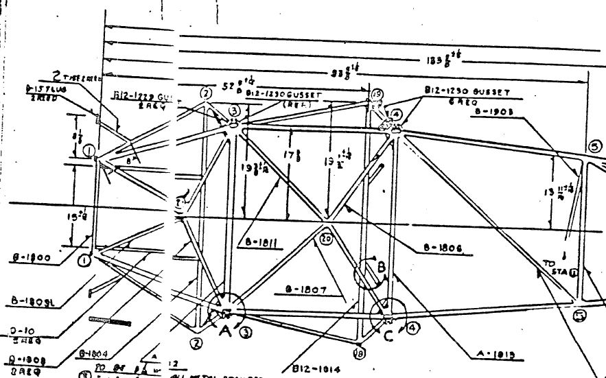

                          I just checked the drawings and it looks like 1/2 the fuselage width is 19" something.
                          So it's about 40" wide. Clearly much less than 50"
