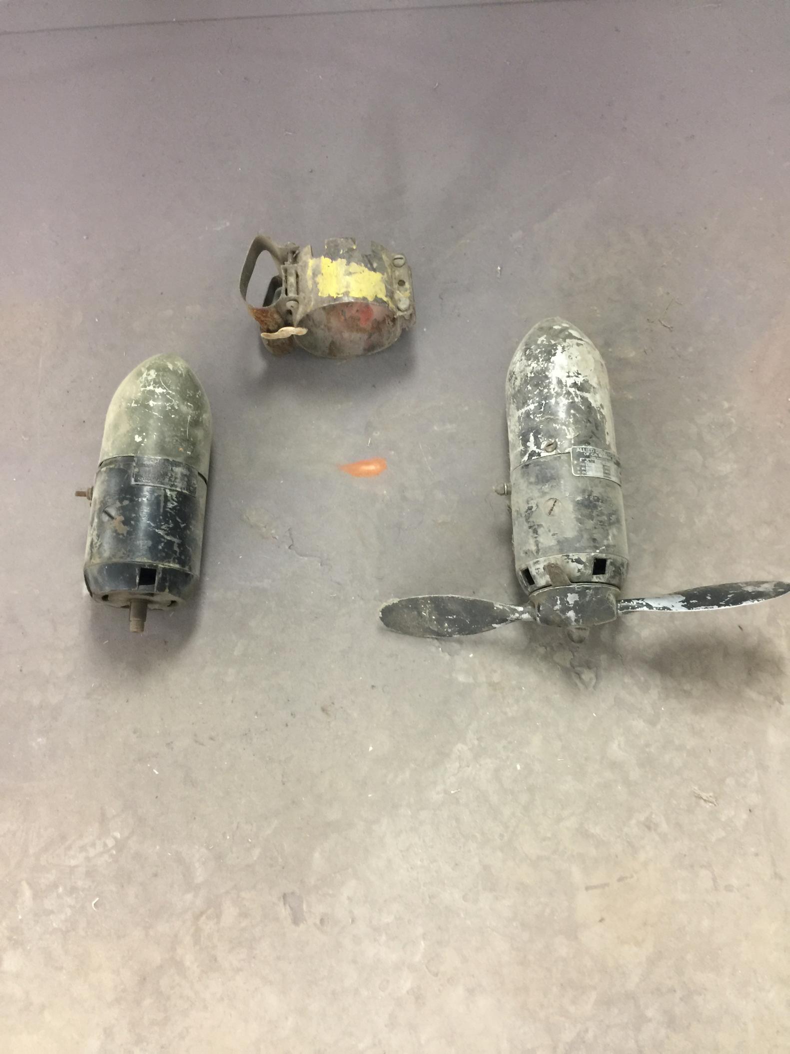

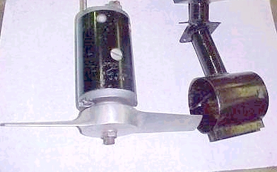

    Thought I would start a new thread for the Ward Aero generators. These were available as an option on the pre and post war Taylorcrafts (also maybe later but i haven't really looked). I will post some photos and try to find the instructions and wiring diagrams as soon as I can. I have also had one rewound and rebuilt as well as found some sources for replacement parts. We also need to discuss some of the safety issues (the cast props have been known to fail in flight and cause some damage)

                there was also champion generators and aero which looks like a champion with a different data plate

                  I have seen photos of those but never one in person. When I rewound and rebuilt the Ward Aero I have the shop found out the core was just a starter for a pre war Evenrude out board motor. Same PN and everything! Thought we had a great source for parts until we found the antique outboard guys had as big a shortage of spare parts as we do.
                  What is REALLY needed is someone with an NC machine to carve out props. The cast metal props have a tendency to shed blades. If they were milled from a billet the grain would be much stronger. I looked at making composite blades but they are so much lighter they won't spin at the same RPM. It would have needed a lot of test runs to get a new blade pitch to replace the cast aluminum ones. It was easier for me to just plug the battery in to a charger before flights that needed one. When you throw the field switch to start pulling current from a wind generator you can actually FEEL the plane slow down! Just like putting a speed brake out! They are also NOISY! In sound and in RF. The RF can be fixed with some chokes and filters, the sound is loud enough to be heard through the engine noise. Noise CNX headsets hide the sound.
