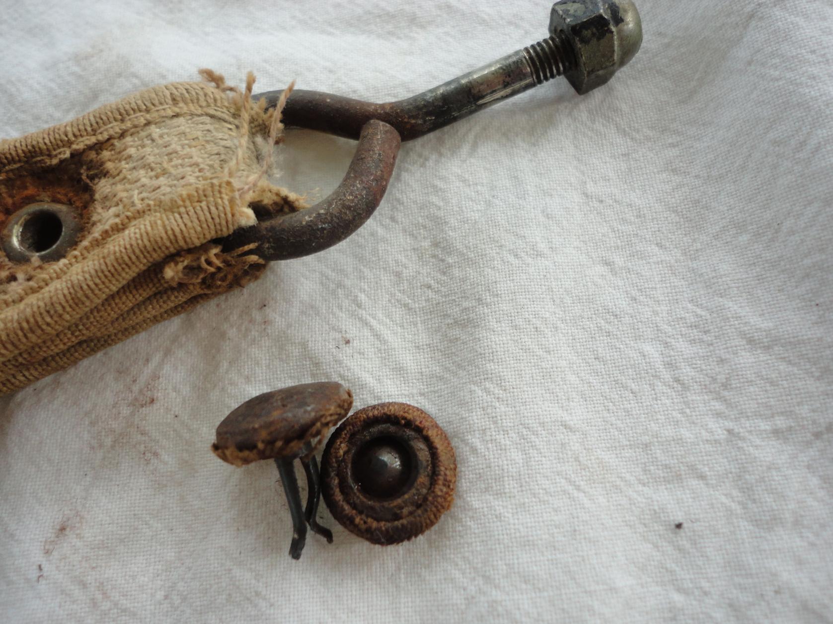

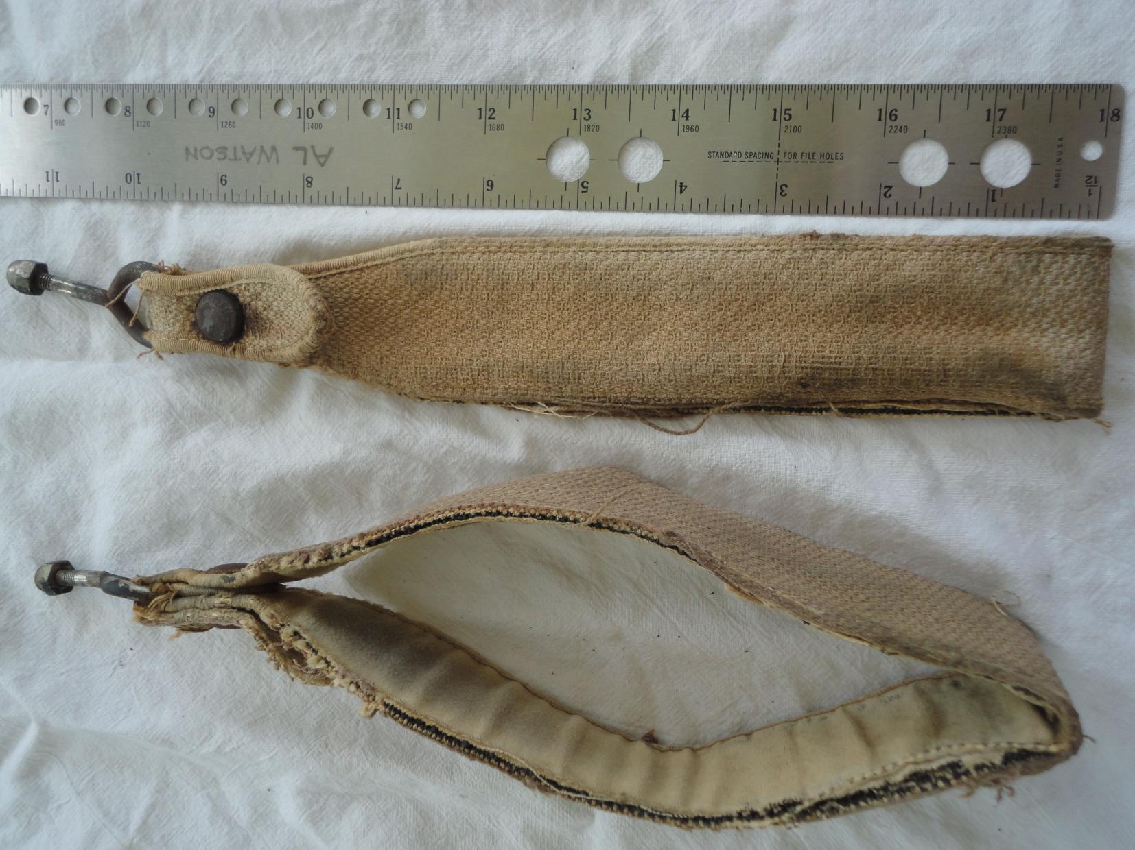

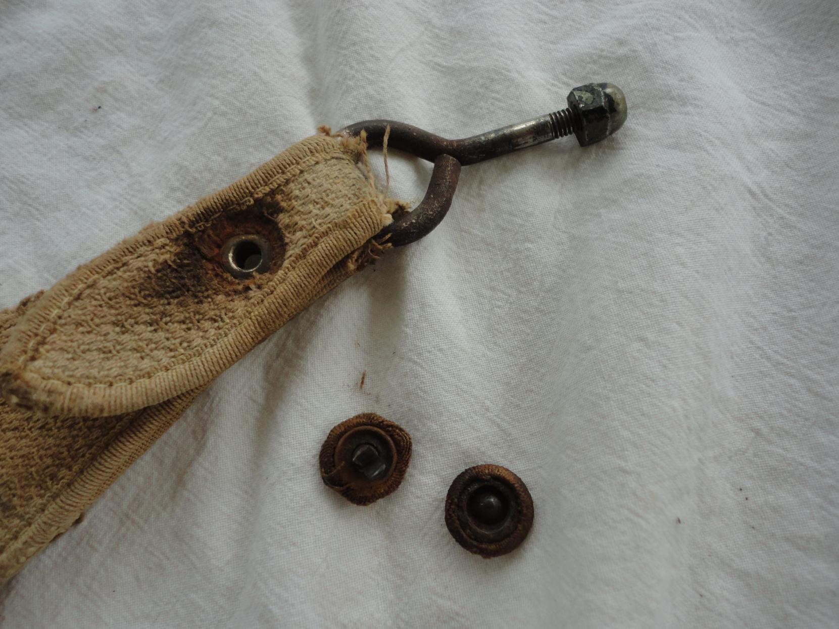

    Starting this thread so we can work together on a small project to make replacement hand straps that went at the top front of the door frame to assist in getting in and out of the tight little doors on our planes.
    We can repeat the discussion already done on the "Pre war Identification question" thread if anyone wants it.
    Photos are attached and I will post more of the new ones as soon as they are made.

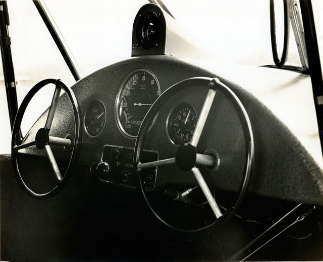

    Found another photo of a pre war with the round wheels. Note the Sissy Strap in the top right of the photo.

                        The ones shown with post 1 are supposed to be original Taylorcraft straps. They are attached through tiny span wise steel tubes welded into the fuselage frame at the top of the "A" pillar (the door hinge tube). I have an interior upholsterer who is going to make a set for me now that I have the right eye bolts. I tried to find photos of the Airtex ones but no luck.

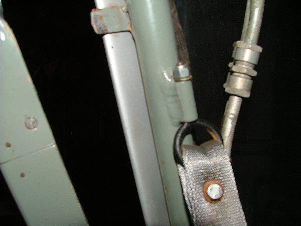

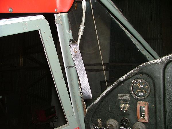

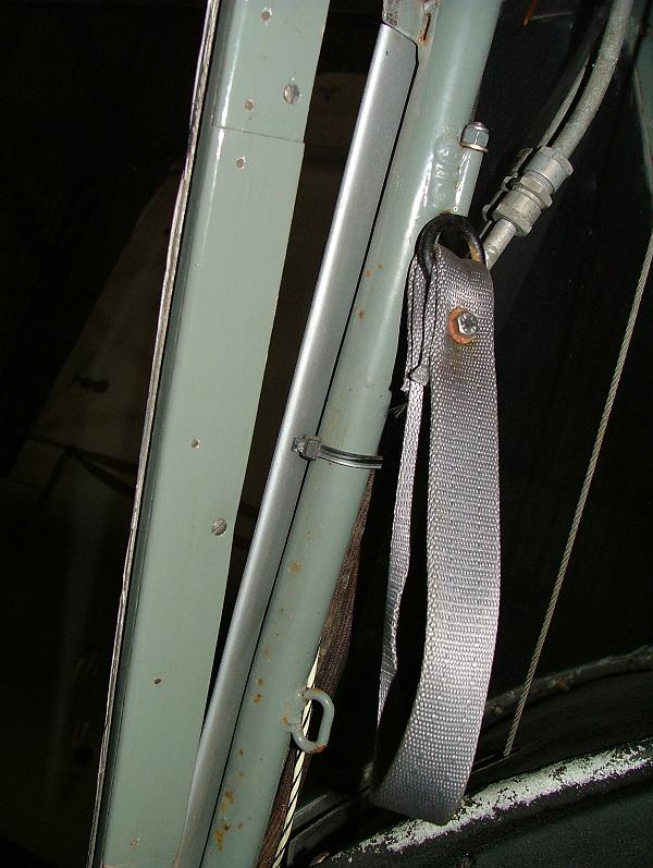

                            The attached pictures are from a 1945 Auster 5, sometimes called "Auster Alpha". This was developed from the five Model A Taylorcraft that came over from the USA (see Chet Peek's book).
                            It has the flat-pane screen, with an 0-290, and was used in military service as an AOP (Aerial Observation Platform).
                            Anyway, much of the interior is original, and these straps are made of canvas.
                              Re: Sissy Straps
                              The ring looks the same except the ones I saw used an Acorn nut and the tube was horizontal instead of vertical (which seems to result in the ring/bolt bending). That also looks like the same rivet with the fabric cover worn off through the strap. The strap looks WAY too new! Must not be many "sissy" pilots in the UK. ;-)
