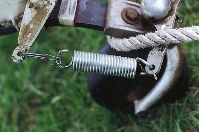

          This is what a moused spring looks like. If there is a lot of bouncing around it prevents the spring from popping loose. Click image for larger version

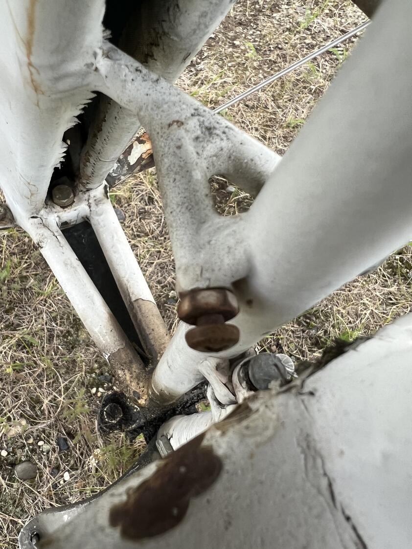

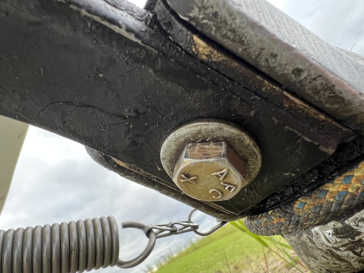

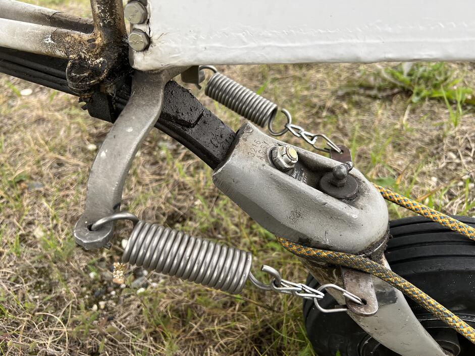

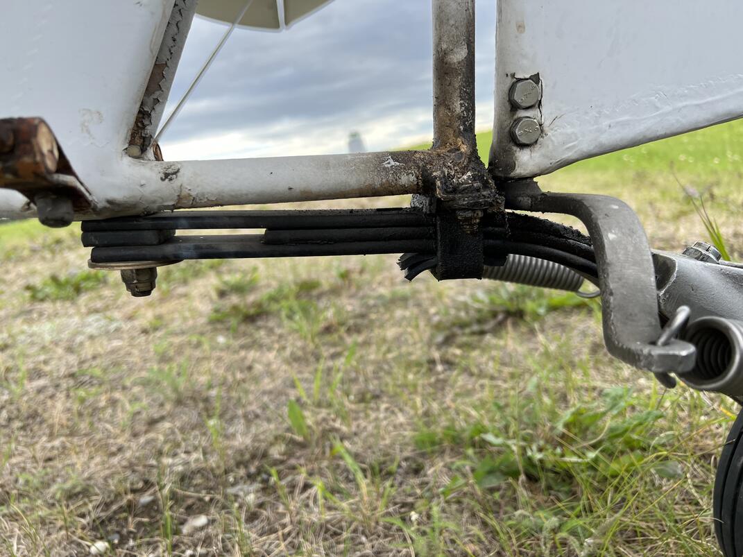

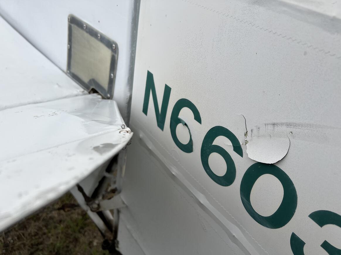

            I’m not moused (yet), that looks smart. Here’s what things look like. My thinking that the rudder stops might be off is evidenced by where the rudder slapped the elevator when the chains were slipped. I was out of town for the windstorm and didn’t get to see any of this in action, just aftermath. Weirdly the photos are pasting in above the text. Click image for larger version

              In the second photo the rudder throw bolt is not adjusted to restrict rudder movement. The rudder should NOT be able to hit the elevators. The way the rudder horns are dented this has happened before and you might want to inspect the area carefully for hidden damage. In number 2 and 3 I really like leaving the aft triangle open so trash doesn't collect there and let the fuselage tubes rust. I WOULD take the area apart and clean the area at every annual and treat any corrosion. The tail area is a really bad dirt trap area and dirt hides cracks and corrosion. I remove the tail wheel, springs and fasteners at every annual, clean, repair and repaint to check for damage. IT DOES NOT take very long and having had a tail wheel spring failure while rolling slowly I DO NOT want it failing on landing! PM sent
              Hank Jarrett
                nut for the wheel bolt should be on the bottom typically and I used castellated nuts and cotter pins, if bush flying, get the spring drilled for the bigger bolt for the 3200, if not just bush it.
                  @astjp2 Yes, all of the diagrams I can find of the 3200 have the nut on the bottom. The Taylorcraft parts manual lists a bolt that would have a 9/16ths head, the Scott diagrams indicate a bolt with a 3/4 head and mine is 11/16ths... I guess they shot the middle? Thanks for your input!
                    Well I had a spring break and a 3200 mount crack, so I went with either an an7 or 8 bolt, I believe it was the 8 and drilled the new spring drilled, there is also a spacer needed to match up the spring with to the groove in the 3200. It needs to be adequately right to not have a problem.
                      Just an update for those curious. Suspicions confirmed: bolt was wrong sized and upside down, rudder throw bolts were out of spec. All tidied up, rudder patched. Also constructed a wooden 1x3, closed cell foam lined, gust lock to slide over the vertical stabilizer and rudder to lock things down.
