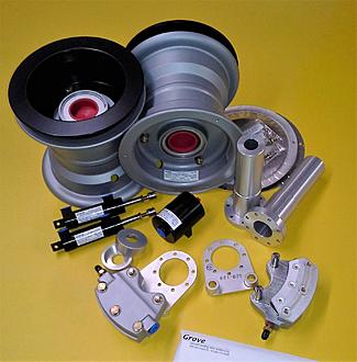

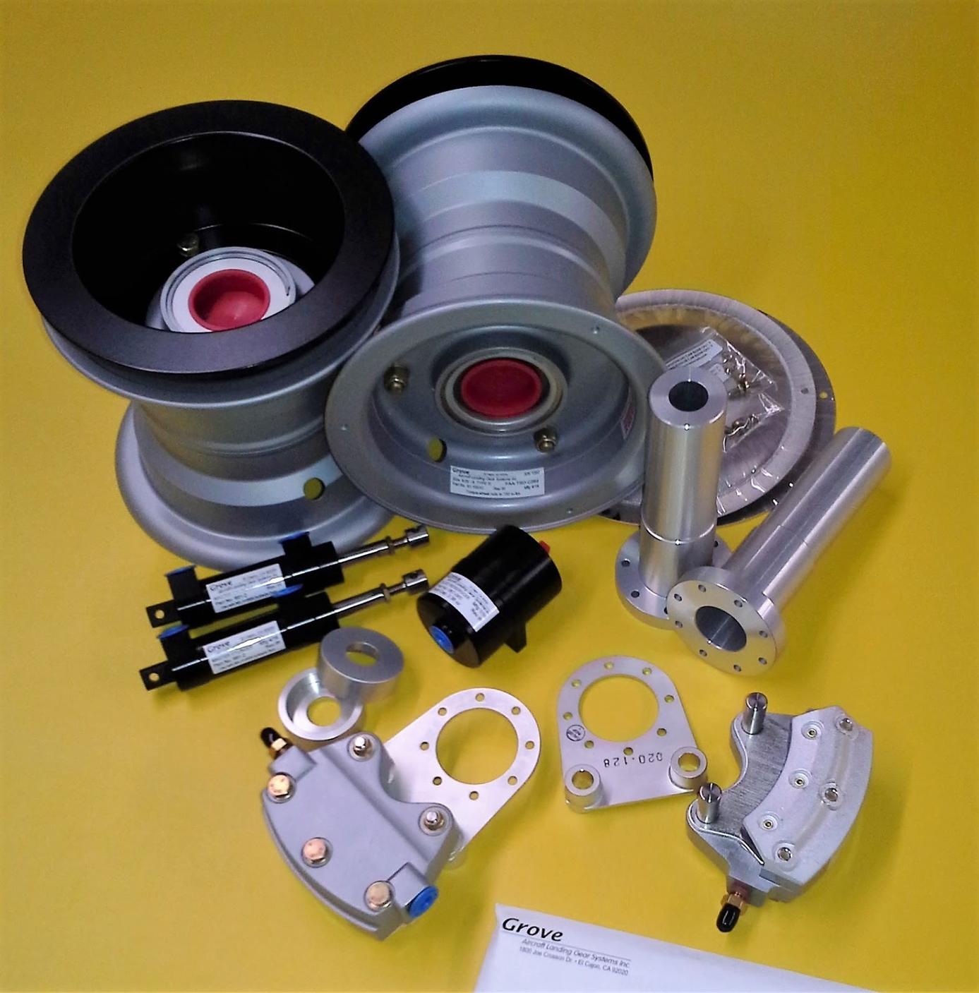

                            Both Grove, Atlee Dodge (or at least Atlee used to), and C.A.P. Terry Bowden (for his Grove wheel package) Click image for larger version
ID:	189444 offer tapered straight axle adapters. A couple of them could be used to form a fixture for both tapered and straight axles - assuming the adapters are similar to the newer fixed 1 1/2" axles. I have them bolted to my gear flanges for Grove wheels and Aero skis. They just slide over the tapered axle.
