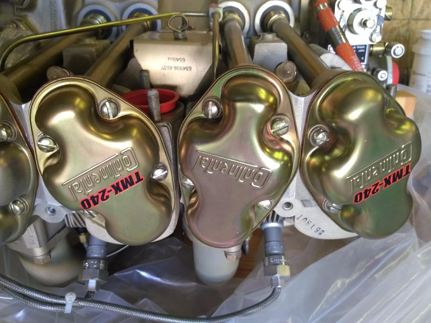

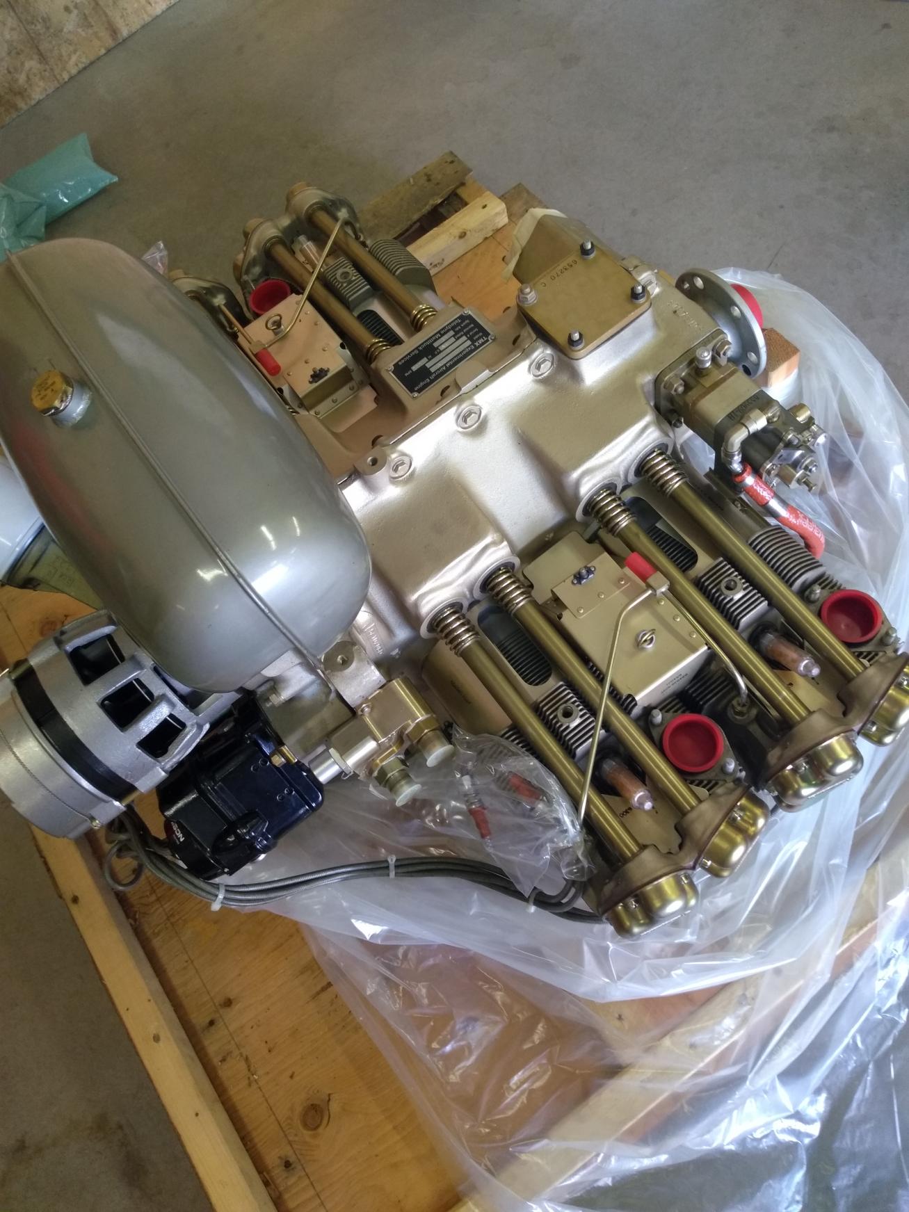

Any engineers in the house? I've got my new motor for the F22 project. The weight as pictured is about 246# and I'm wondering of the stock long mount is up to the task.

That spruce one wont work without a lot of modifications, it goes too far back as it is currently is configured. I would find out from your buddy at Vetterman about what he can do that would fit right the first time. TimOriginally posted by Nefj40 View PostIt might be a while, but I think (hope) it'll be a nice one.

I happened to see on a continental web page that the above engine is #246 while the 0-200 is listed at #216 so I might be looking at only a 30lb increase stock. If I dump that huge alternator for a B&C and then go with a catto or whirlwind it's feasible that I won't have all that much more weight hanging than a stock 0-200 F19. A couple things that did pop up that will have to be dealt with is the big plenum on top of the case, and the prop flange sticks out 3 inches from the front of the case.Dave
