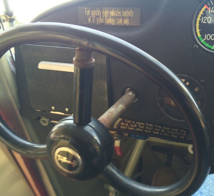

            I used Oilon when I remade mine. It's green, but this picture shows the general layout:

                      The hole is rounded or chamfered. Rob's picture shows this and it is very important.
