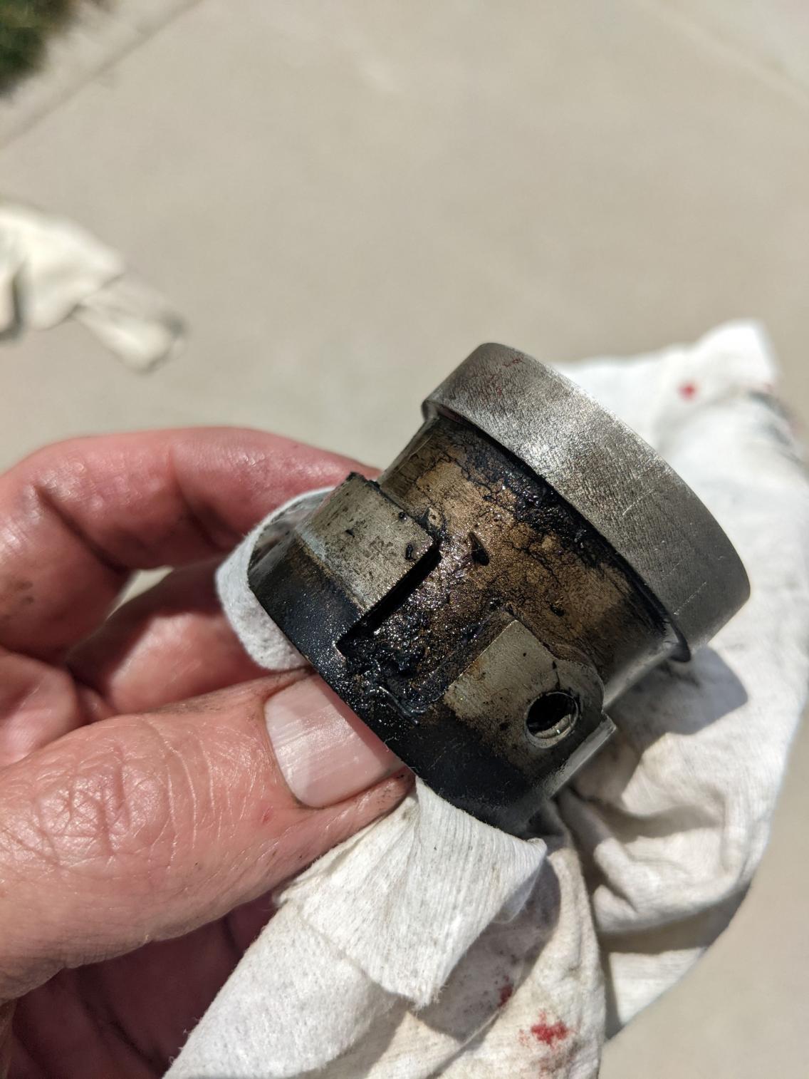

        I experineced his problem, I have a '45 and it does not have a filter element for the carb, just a screen.
        The fault was a dirty carb, if your issue is the same, you will have to dissassemble and clean it. The issue I had was the air flow chamber around the outside main venturi passage and the carb body. This core is interchangable to get to different Stromburg applications. I suspect you will find this passage comtaminated. This passage is a transition passage in use during low to mid RPM operation.
        I recommend that if you don't have an airfilter element that you need to dissassemble and clean the carb every 2-4 years, It is really quite simple and then you can check the float height, needle seat wear and fuel flow rate at the same time.

        I'll try and find some photos.
          Here is a photo of the offending passage around the outside core venturi body.
