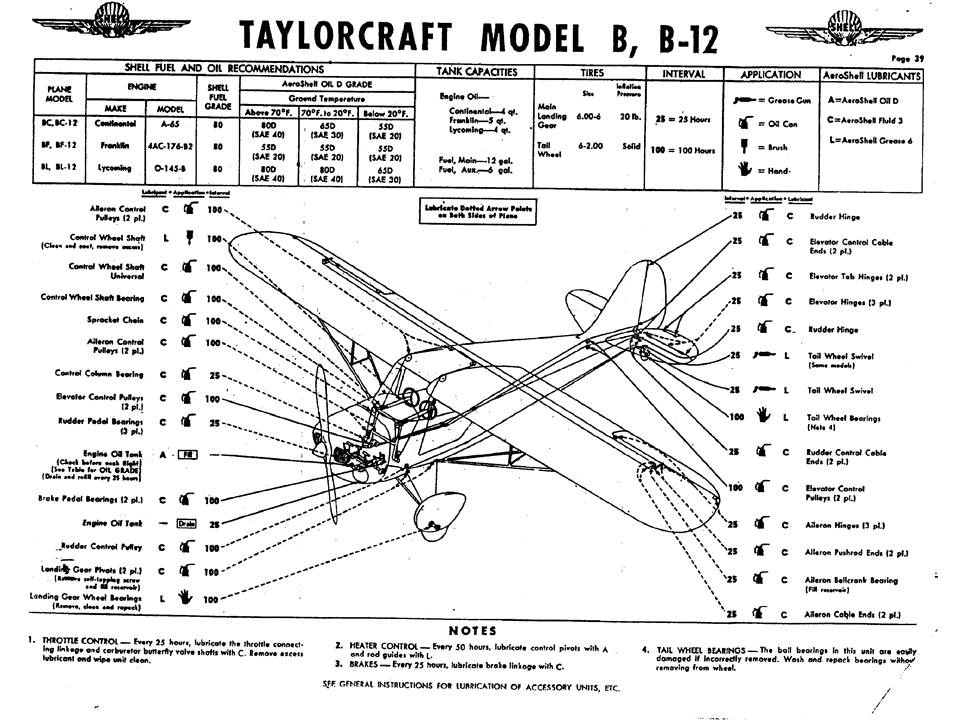

    I've got my floorboards up and the center control stick apart. What's the best lubrication for the control stick caps before reassembling? A coating of light grease? The same for the rudder pedal caps?
    Is there any recommended lube that you put on pulley bearings? I read that no coating should be put on cables. Correct?

    I am attaching a copy of the lube chart. Never had a problem using what they recommend.
