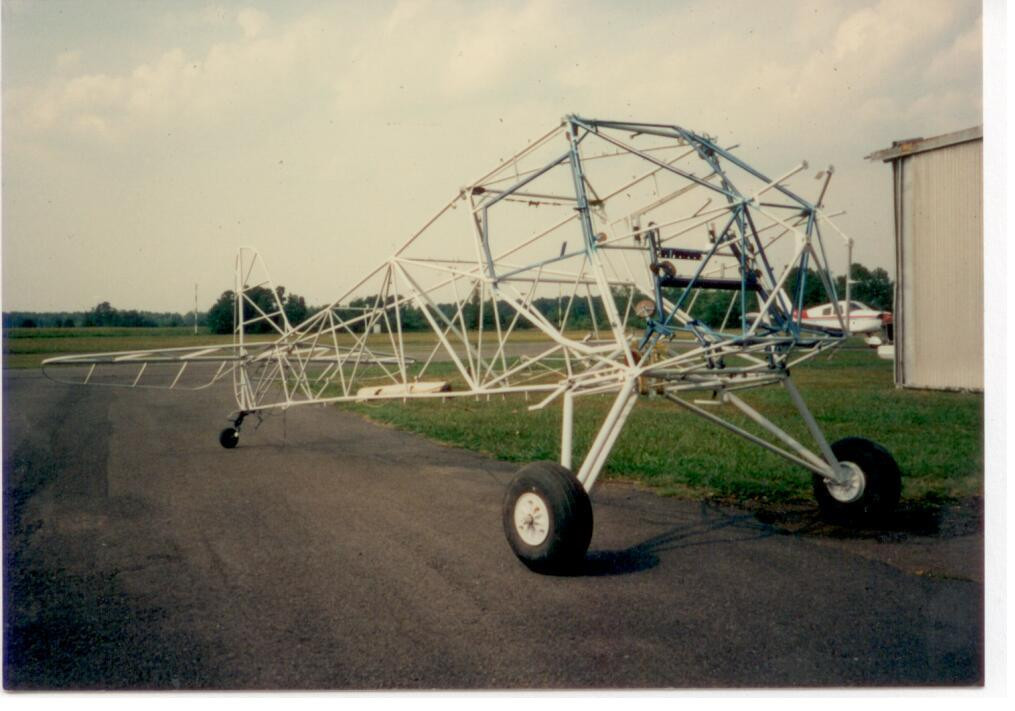

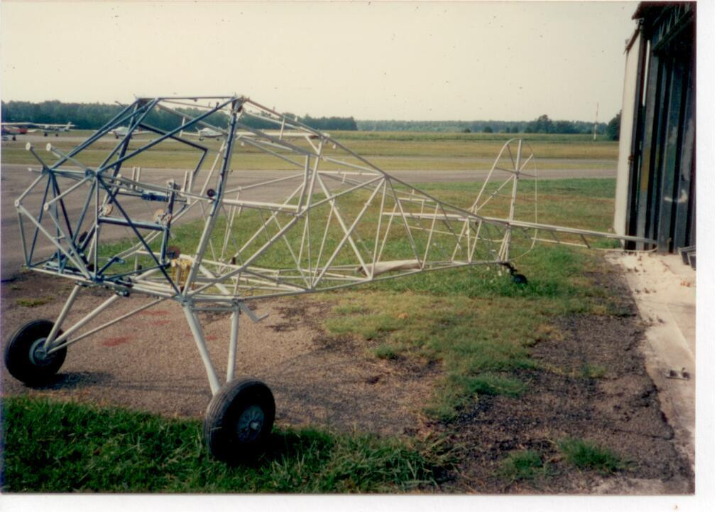

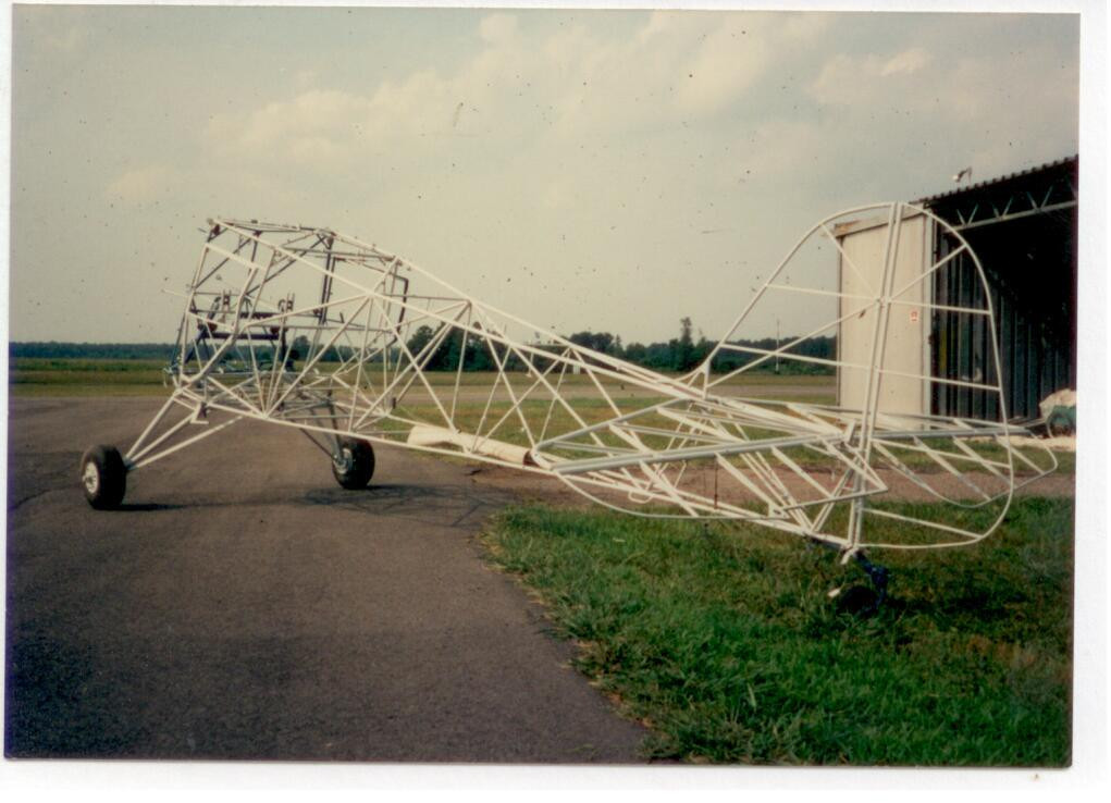

        My 45 was flipped over in a wind storm and the cabin was crushed along with longeron damage and smashed up nose. She was rebuilt WITHOUT a fuselage fixture. I would NOT recommend that path. I had a lot of experience with trammeling and verifying critical dimensions and it was a LOT of work. A fixture would have made the job a snap by comparison. This is my planes fuselage after all the welding was done and she was primed and painted. Looking back it was all worth it.

          Appreciating the personal accomplishment value 10+ !!!
          Recovering the $ invested = Sigh. For the love of the challenge! HAHAHAHAHA
          Brent N27662 SN2304 BC65
            Love of the challenge will become pride in the accomplishment! It is all worth it! The more damage, the more pride in a job well done.
