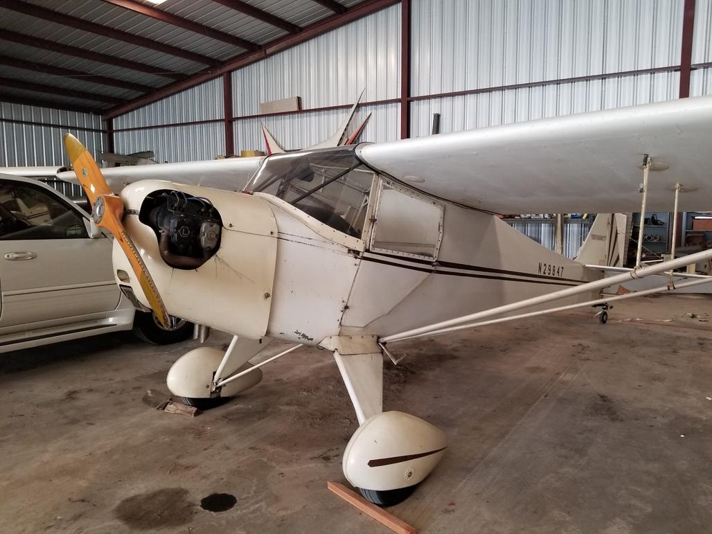

Just purchased N29847 a 1941 BL65. Still with the O-145 B2 engine. Got to do some prettying up to do but she seems solid so far. Sure the under the seat trim control will be interesting. Definitely going to need input at some point since engine parts are scarce. I'd like to keep it original rather than going to the C85 option that so many have but we will see.

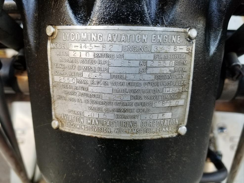

Didn't think I would be needing assistance quite so soon. The power seemed to be a bit low and an oil leak developed so had the mechanic take a look. Seems I have 1 blown head gasket and another that's iffy. Anyone have a source for gaskets? I have been pointed to a guy on the field who I am told can make anything I need. Just thought I would check if anyone has any originals. Any help or advice if I have to have some fabricated would be appreciated.
See the attached pic of the engine dataplate.
