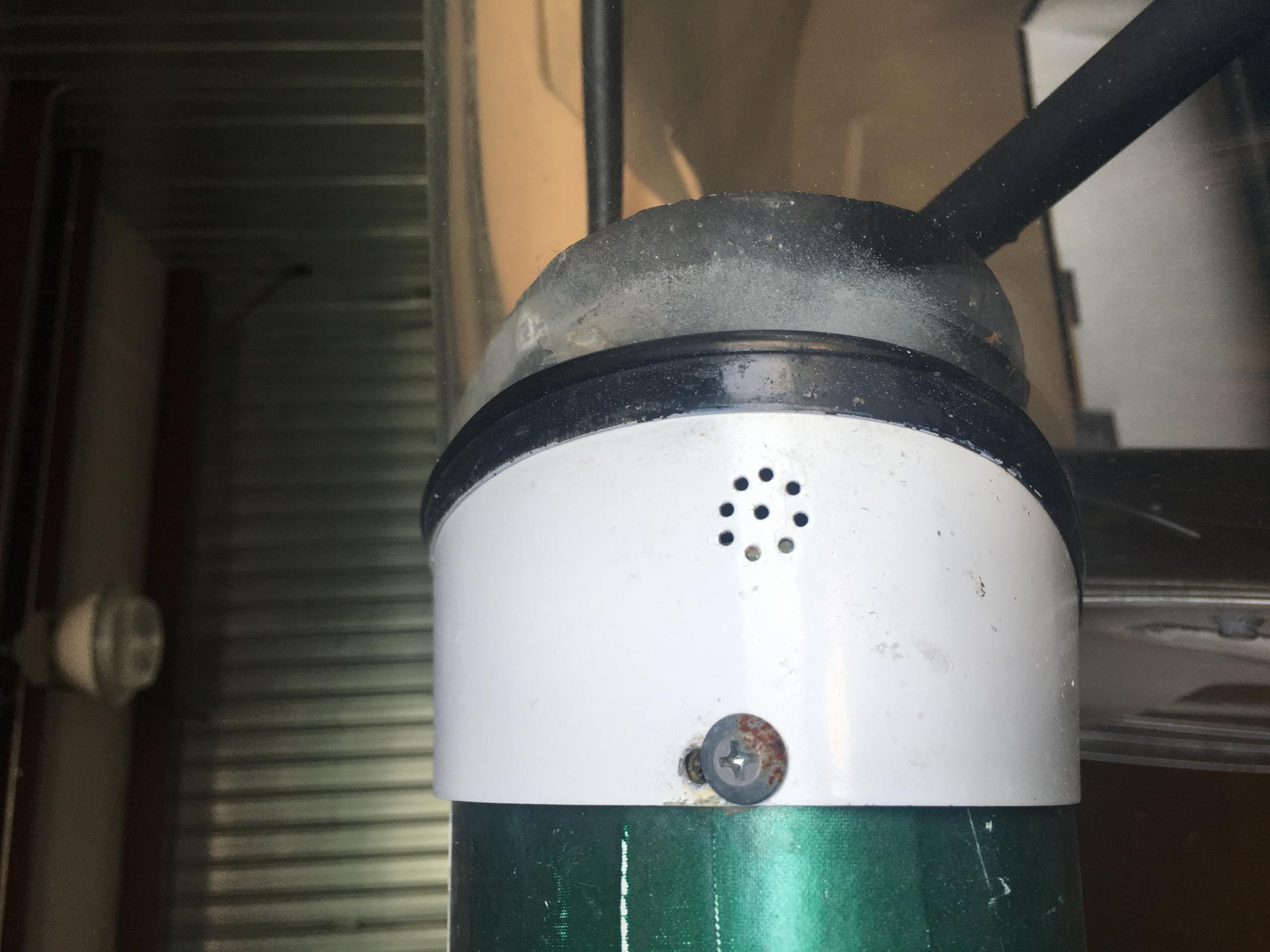

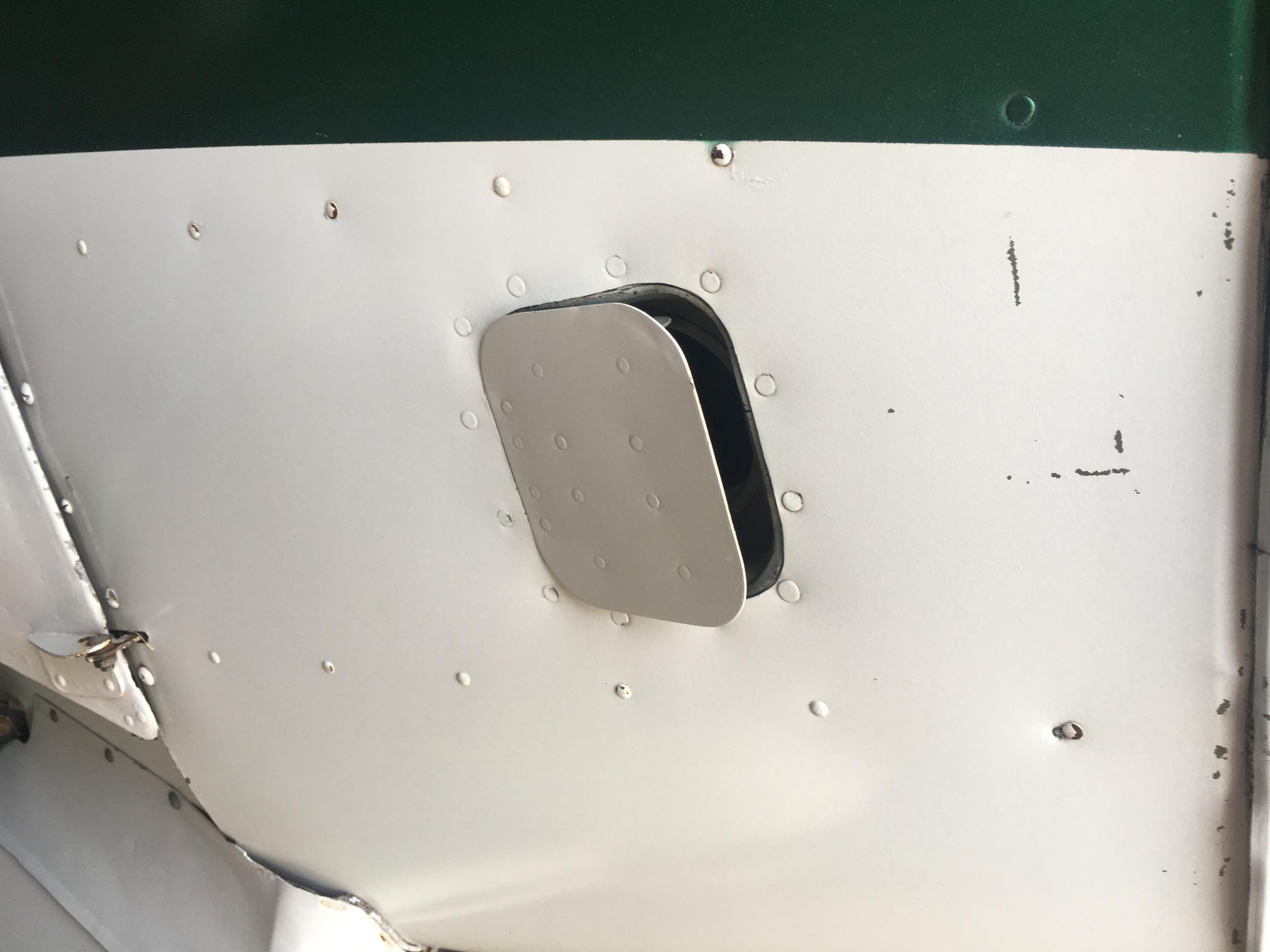

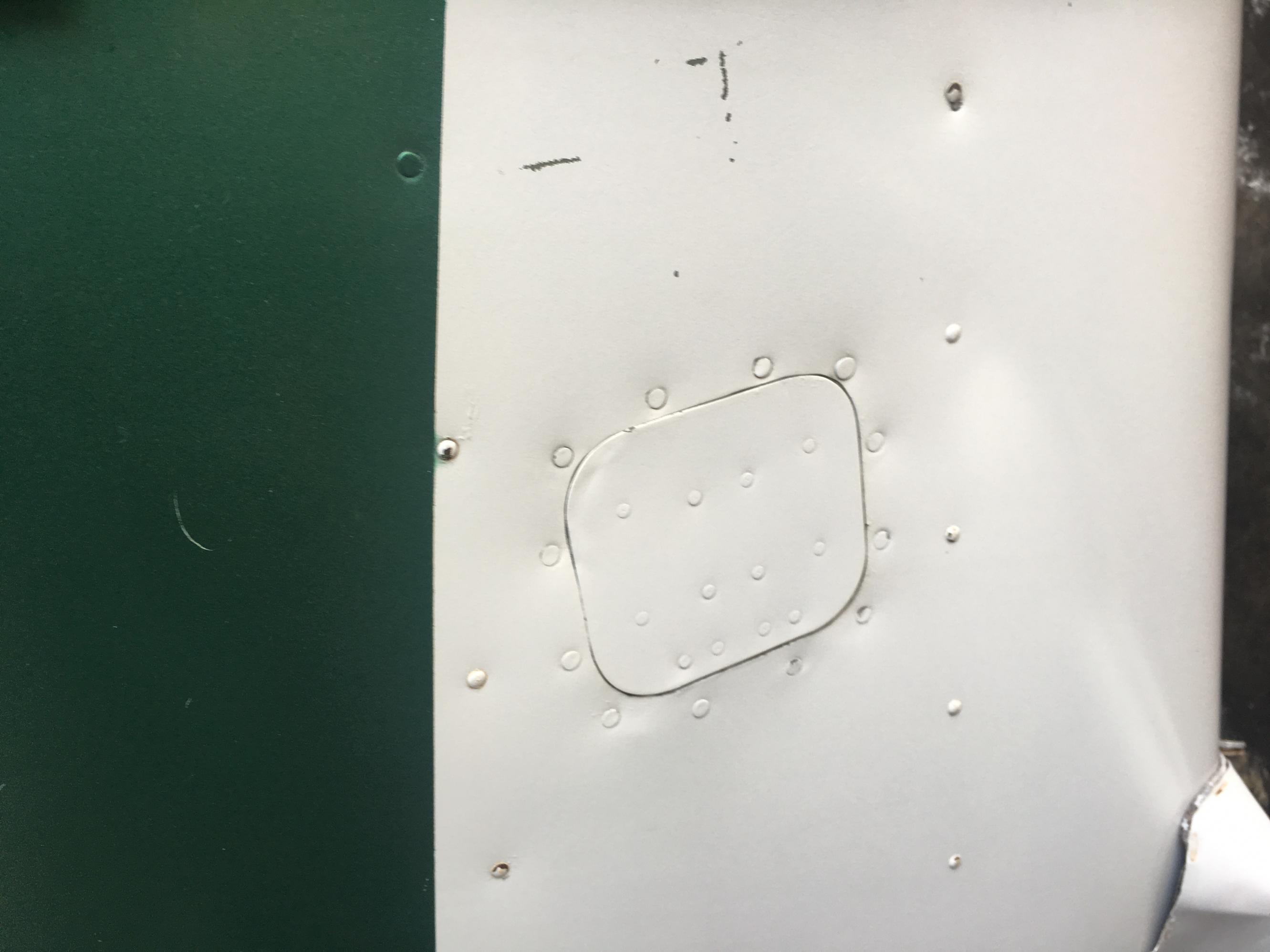

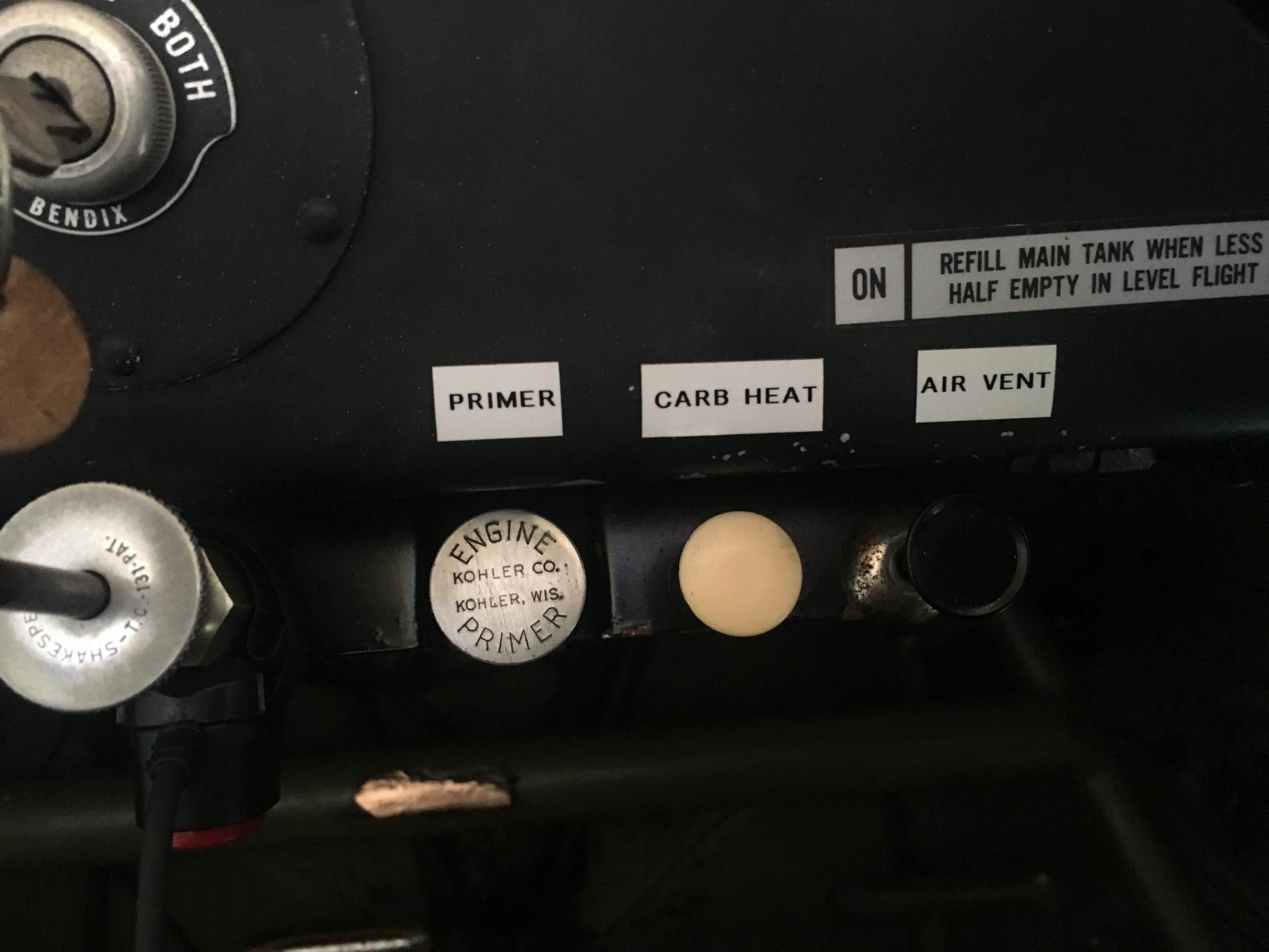

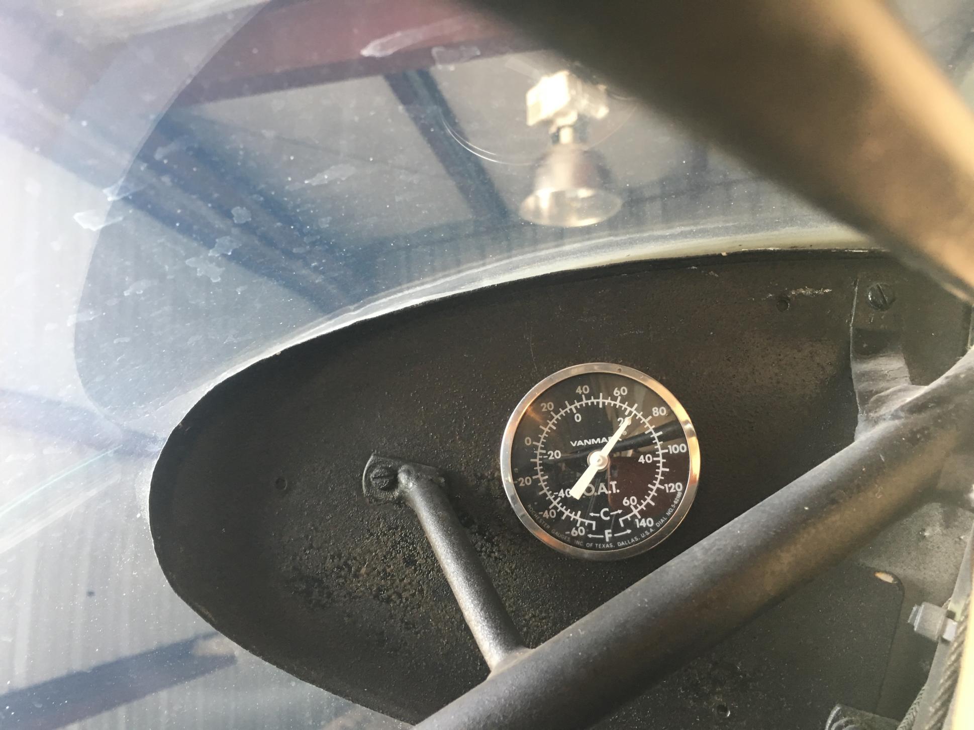

      Finally remembered to take some more pictures. First three are of the cabin air vent closed and open, along with where the pull knob is for it. The last two are of closer up of the holes in the starboard wing root and the thermometer in the cabin on the other side where the holes are.

        Hi Stuart,
        The vent door is most likely a Cessna door. If the PN is still there on the inside primer it will be in this format, 0xxxxxx-xxx. Typical single engine series start with a 0.
        Nice idea, it looks better than the bubble twisties from Spruce.
        Tcraft vents from the factory were in the upper, aft most corners of the front windshield or the door windows pop out or slide depending on model.
