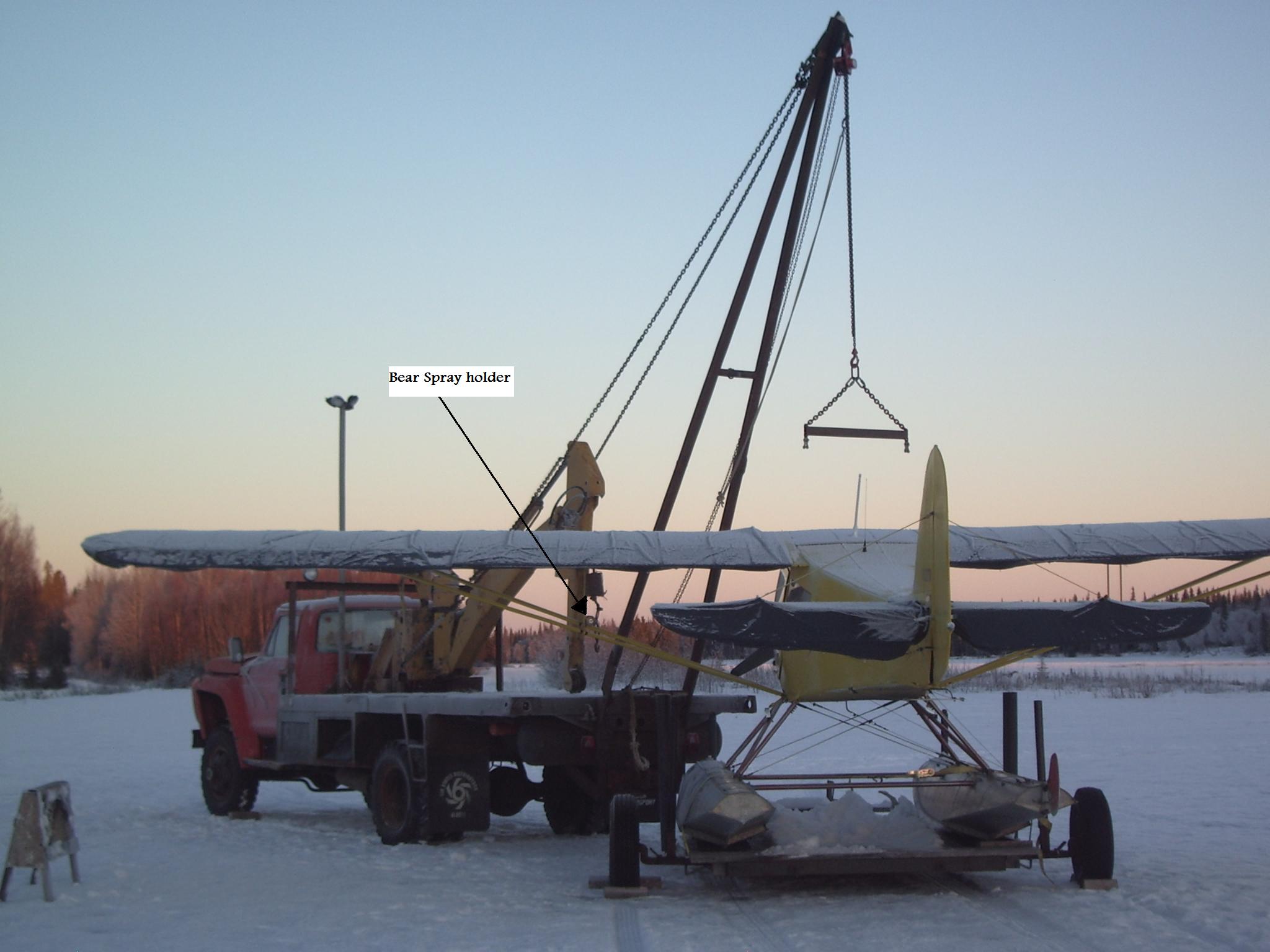

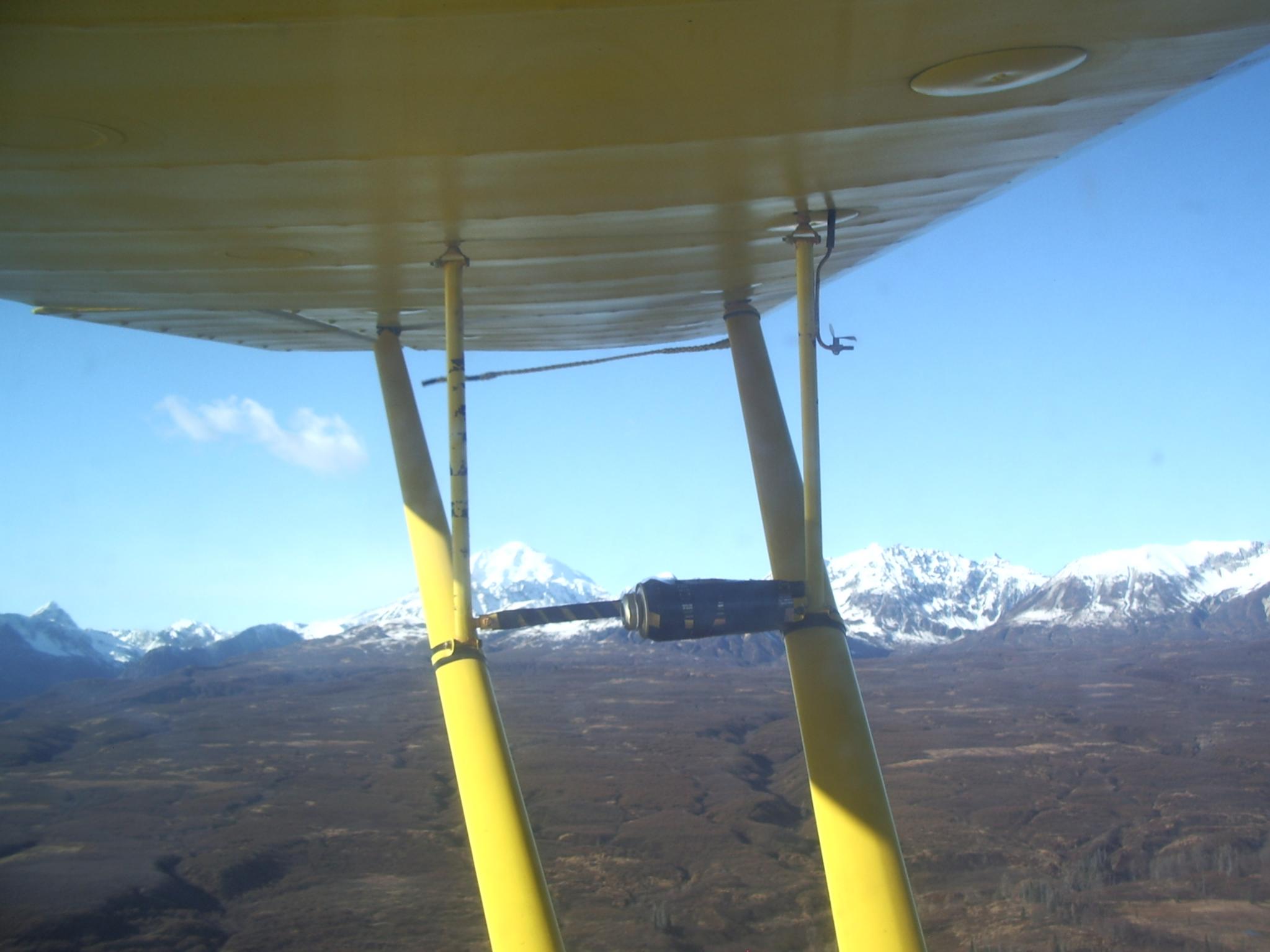

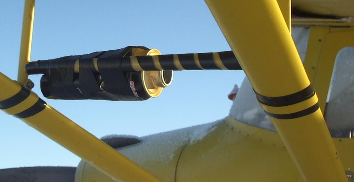

What do you think it's for?    Dick

 a Goose whistle...

 Stall Warning horn???Terry Bowden, formerly TF # 351

 Several pretty good guesses...! What it is...is an aluminum can made to package "Monster" energy drink. With the bottom cut out, it was taped to the horizontal jury strut member (which was protected from tape residue with a piece of clear Tygon tubing[split endwise]. The lid was removed, so the drag is minimal when the device is empty. What it is used for...to hold a canister of Bear Spray when flying. I could probably fly for years without having a problem with an accidental release inside the plane, but I just don't like the stuff inside. My son is a cop and has been sprayed with it several times. From what he says, you just cannot function very well after being exposed to it... basically, you can't open your eyes. The spray can we carry is larger than most and I would hate to have it discharge or be punctured inside the plane. Maybe overkill, but outside I don't think it would ever be a problem. The floats we have don't have cargo hatches so this was the next best thing I could think of. Anyone else have a suggestion? DickLast edited by Dick Smith; 01-22-2011, 10:00.Dick Smith N5207M TF#159

 That's a great gaget Dick! I like it!
