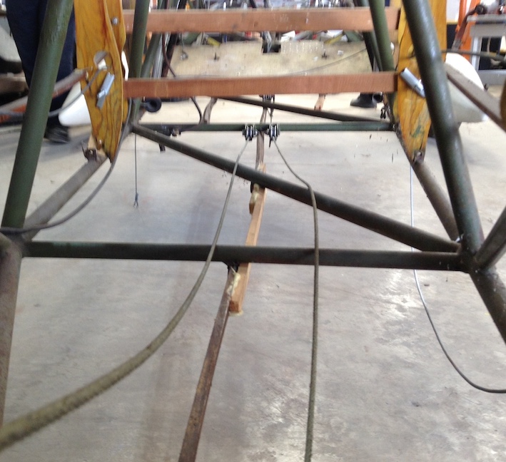

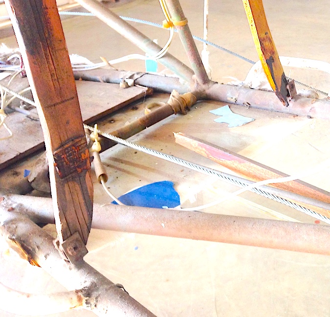

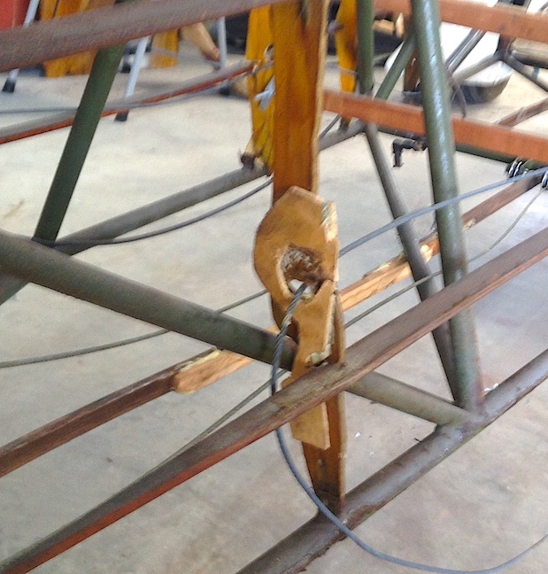

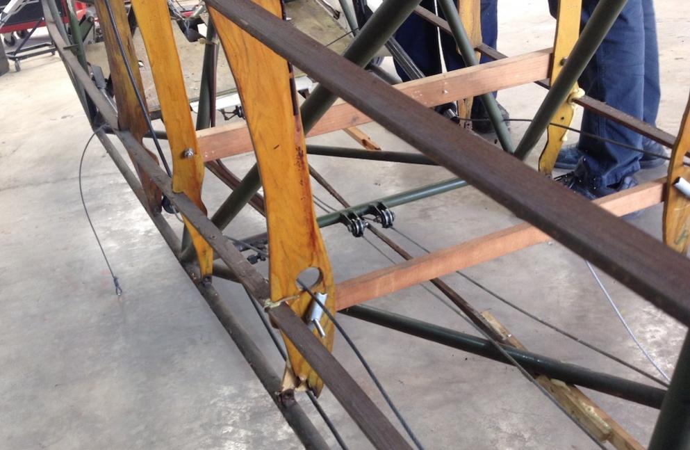

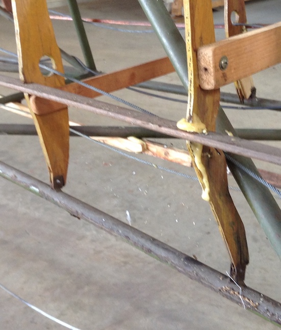

This Citabria flew to my shop. I'm still shaking my head and wondering how the pilot is alive.
Two wing spars were cracked and two others were rotted at the root.
