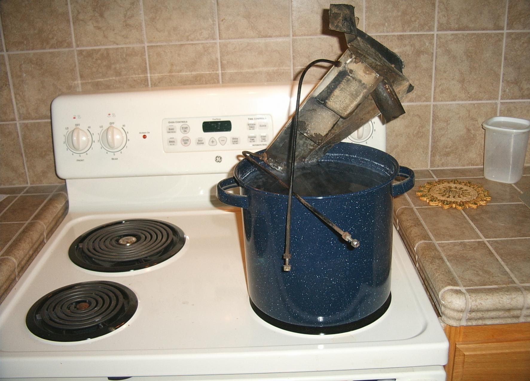

    Re: getter done
    I see your baffle boiler and raise you:
    One additional pot & pan holder.
      Re: getter done
      Looks like a really savory soup base to me.
      Hank YUM!
        Re: getter done
        Hope its 5052 alloy.Much easier to chew than that crunchy 2024 t3.
          Re: getter done
          300 series isn't bad either, but stay away from the 7000 series stuff. Almost NO flavor and REALLY boney.
            Re: getter done
