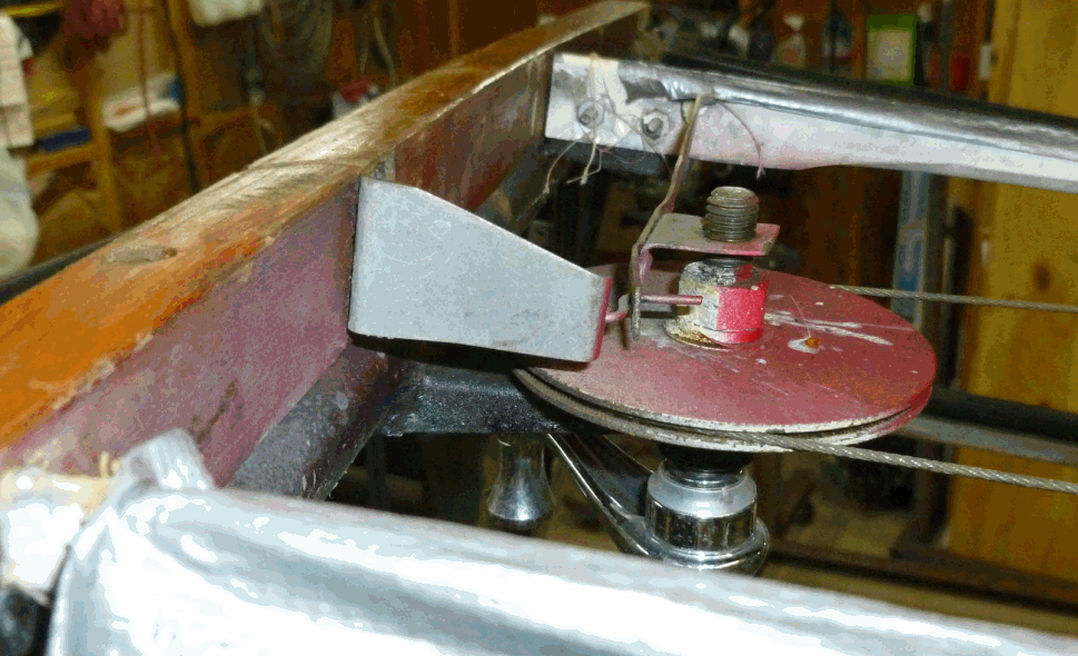

                  On a BC12D the front pulley for the trim cable has a shaft through the center of the pulley. This shaft shows a washer between the pulley and control crank brkt. This seems to put the shaft to far up, the end of the shaft is above the strings. Do I need to install a thiner washer? The picture I have shows a D-9091 washer. Need some help!!!!!!!!!!!!!1
                    Re: How does the trim cable work?

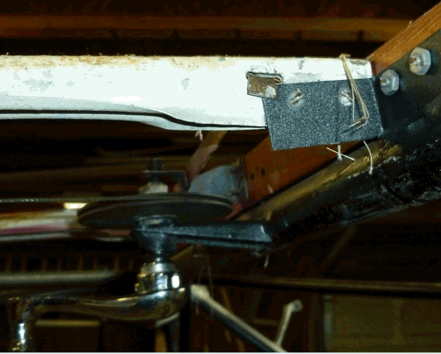

                    Not sure if you can see much in this picture. But here is my installation. '46 BC-12D
                    Tim Hicks
                    N96872
                      Tim If you put a straight edge across the top two stringers, above the trim shaft, how close does the trim cable shaft come to the straight edge? Mine is higher than the stringers. Your picture looks just like mine except mine is higher.
                      Thanks
                          Unfortunately, after I took these pictures, I dissembled the mechanism. And I didn't measure the clearance. It's close.
                          For what it's worth, I always had an inspection cover directly over the trim mechanism. I don't know if it added any clearance.
                          I don't remember seeing any evidence that the crank screw ever was rubbing the inspection cover.
