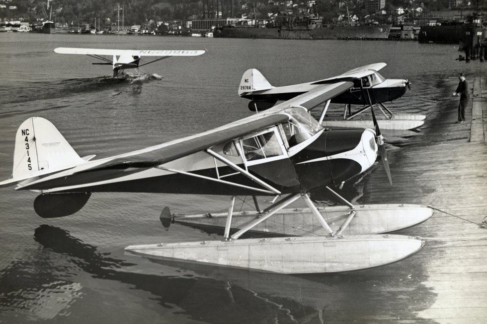

Here is a picture of a 45 Taylorcraft with a Beech Roby prop. They are especially nice for planes on floats since you can have a take off prop with a flat pitch for maximum efficiency and then go to a coarse pitch for cruise.
The flat pitch would be a joke for cruise and you couldn't get off the ground in cruise pitch. Controlling pitch is like significantly increasing your HP.
