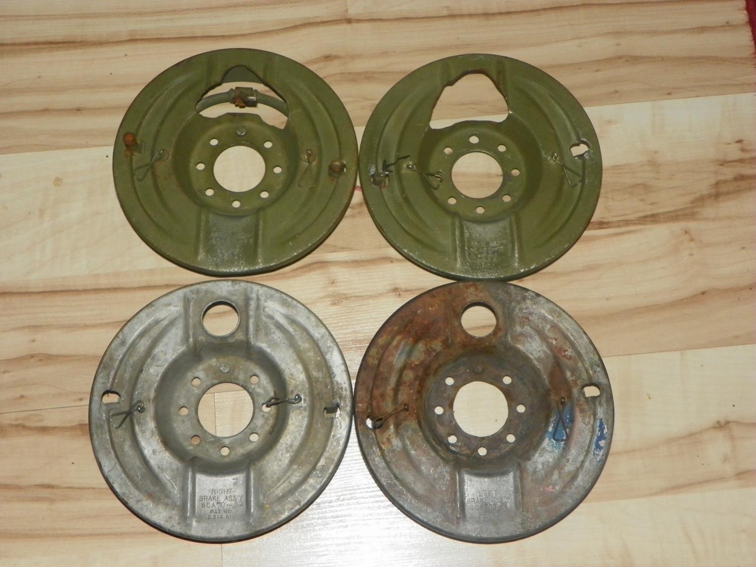

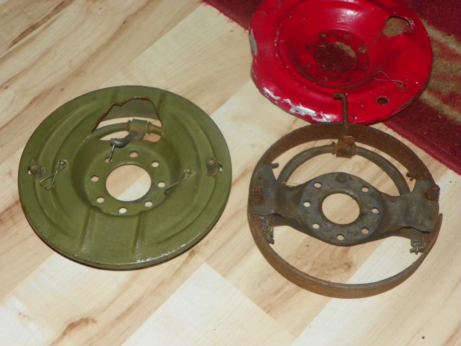

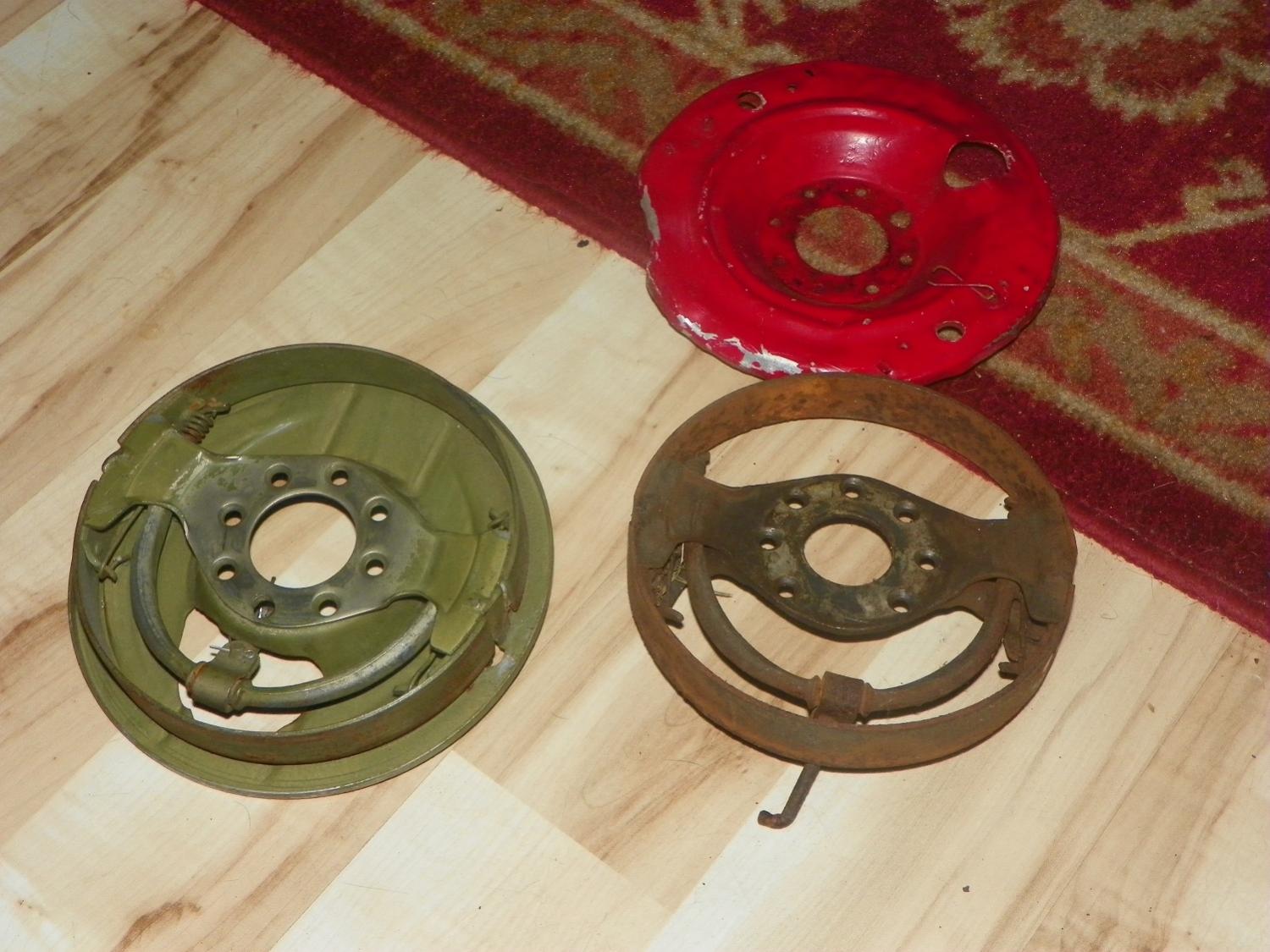

I think that the covers are tacked to the brake assembly. They will not come off. I have a couple pics. The green assembly is the one the cover will not come off. The other assembly came off my project (red cover) I think the side that is marked R or L is up against the cover.Dale

Each Shinn brake is either a "R" or "L". The light aluminum backing plate and the brake shoe operating parts are definitely only good one one side or the other, and almost every one I've seen are marked L or R. I say almost because I have an unmarked shoe plate in my parts bin. A couple of things about the green primered set in the photo: There should be a dowel set-pin in the top hole of the inner ring of holes, as you have in the shoe plate on the right. Also, unless someone got creative and glued the alum. backing plate to the shoe plate, you should be able to separate and use the back plate. It may just be that the primer paint on the pieces has glued them together over time. Try a small putty knife or thin blade. The alum. backer is super thin and ruins easily.

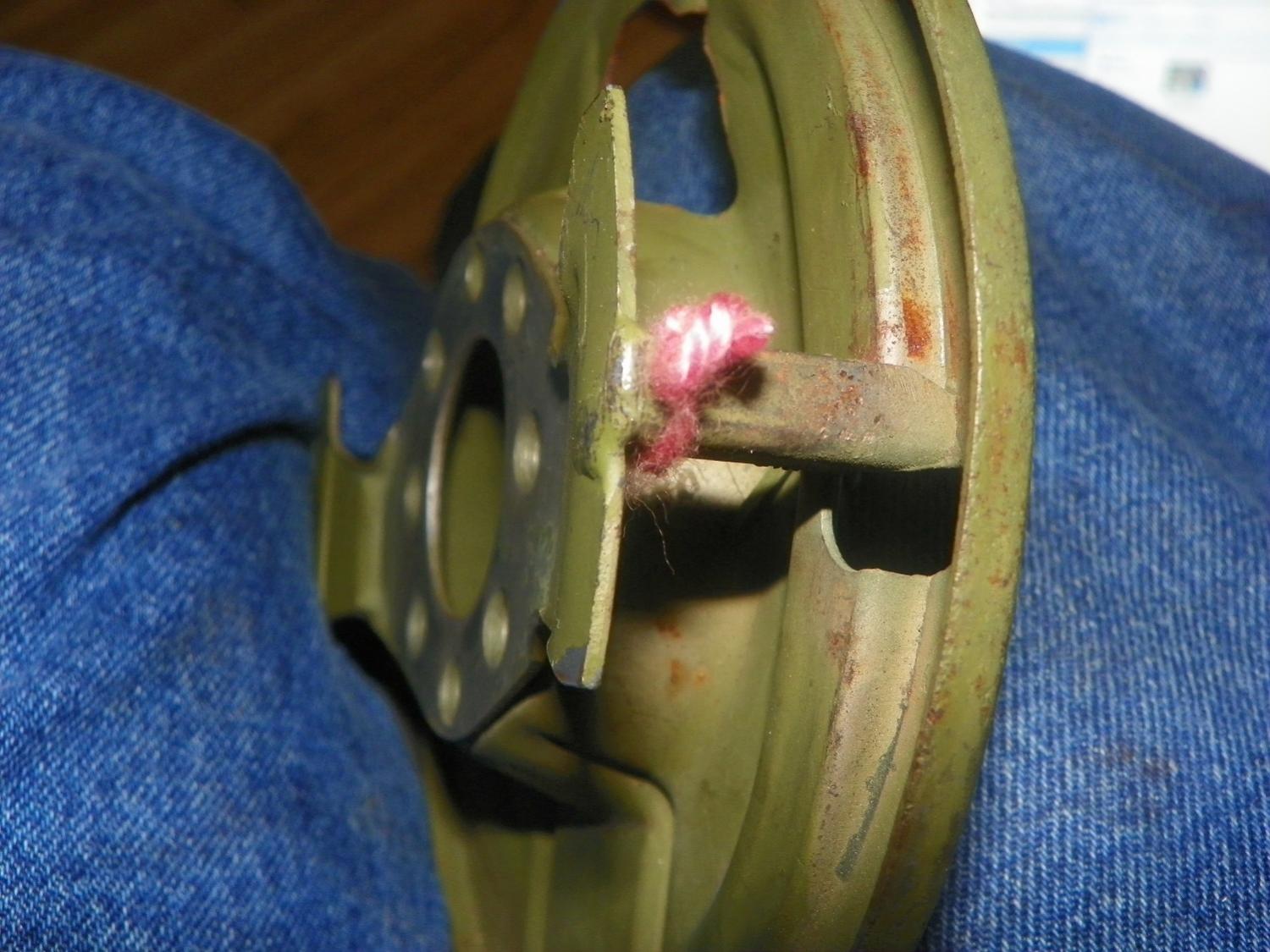

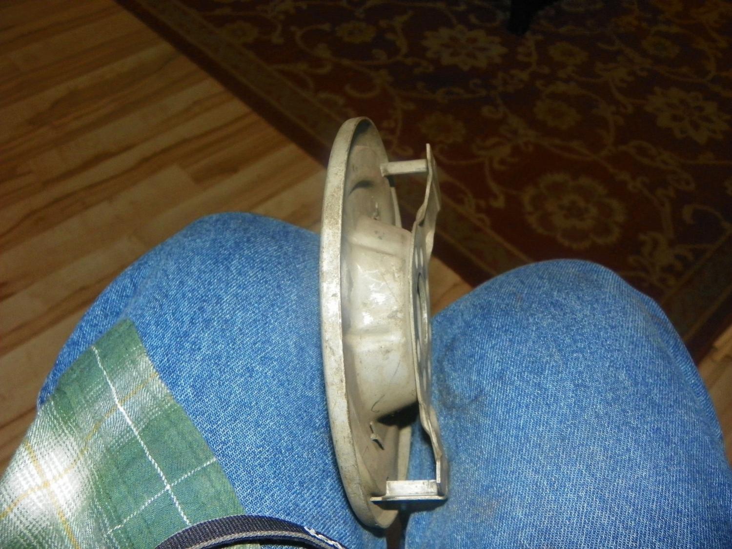

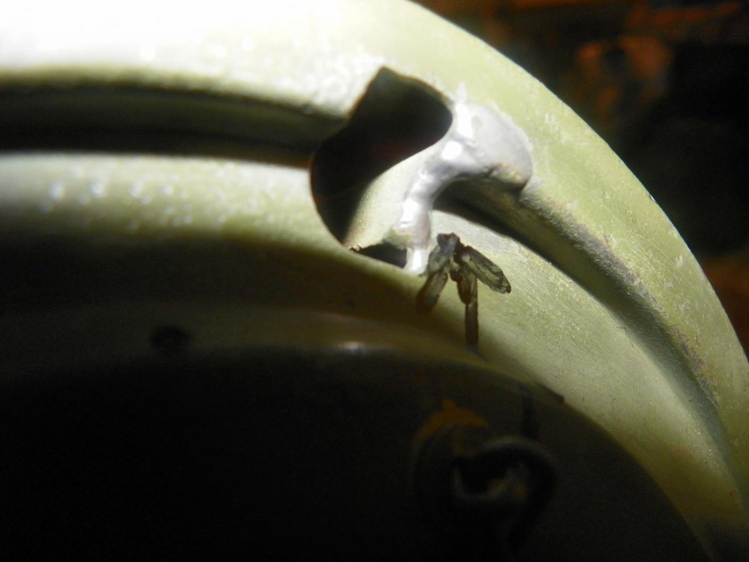

I took the assembly apart this morning and it appears someone brazed them together. short of cutting them apart is there any way to tell the difference between a right and left assembly. I have the old set to compare them to. They all look the same to me.Originally posted by NC22211 View PostEach Shinn brake is either a "R" or "L". The light aluminum backing plate and the brake shoe operating parts are definitely only good one one side or the other, and almost every one I've seen are marked L or R. I say almost because I have an unmarked shoe plate in my parts bin. A couple of things about the green primered set in the photo: There should be a dowel set-pin in the top hole of the inner ring of holes, as you have in the shoe plate on the right. Also, unless someone got creative and glued the alum. backing plate to the shoe plate, you should be able to separate and use the back plate. It may just be that the primer paint on the pieces has glued them together over time. Try a small putty knife or thin blade. The alum. backer is super thin and ruins easily.Attached FilesDale

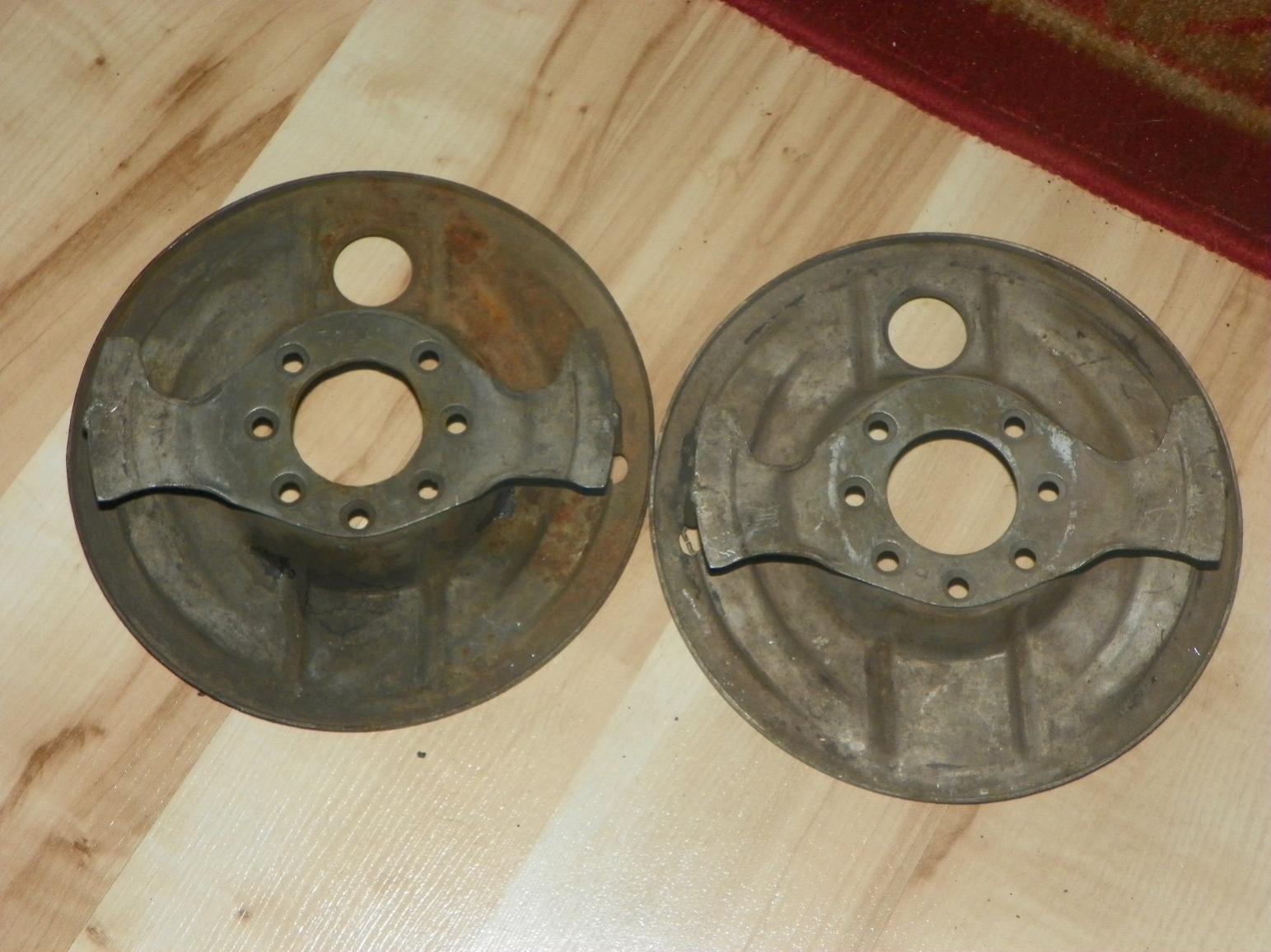

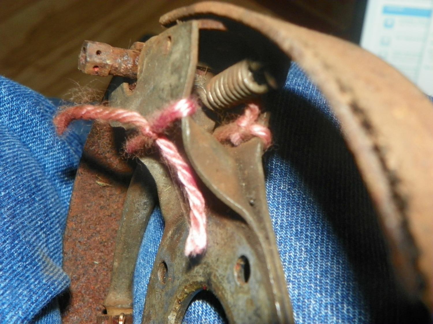

After further investigation, the the Assemblies are different. Not sure if they are from a post war and a pre war? My project is a 1946 BC12D. So maybe the green assembly is pre war?Dale

OK I went back out to the garage and looked thru my parts box again. I found another pair of assemblies that are the same as the green assemblies. These are cleaner and I did find what I think is a date stamp on one. It is stamped 7.29.41. There is no R or L stamped on them that I can see.Dale

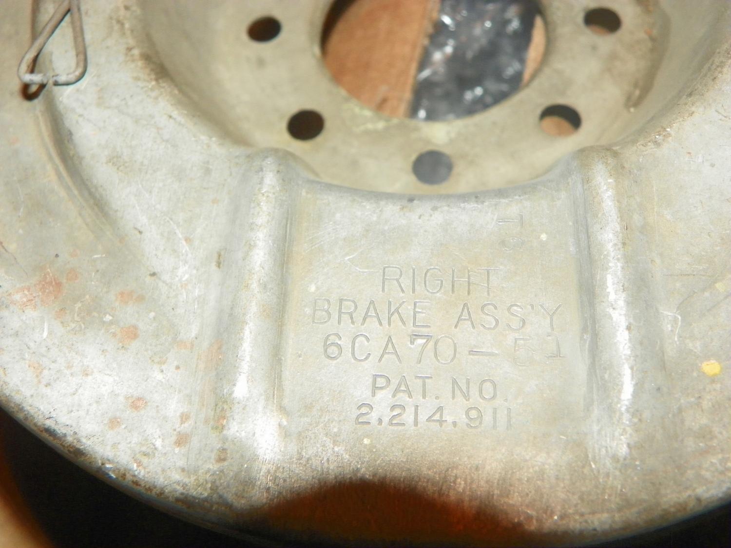

The things you find when you have a wire brush and a magnifying glass! The assemblies are stamped on the back on the cover. Both sets of assemblies are the same with the brake assembly and cover attached. I want to use one set on my project. Just would like to know if anyone else have seen assemblies like this before? From the other replies I have got, they must not be to common.Dale

The guy I bought them from said they came off a Taylorcraft. Maybe he was wrong? The band width is 1". I found a part number on one but can't find any information on it.Originally posted by Ragwing nut View PostThe steel assemblies you have are not for taylorcraft. They have to be for a different aircraft. what is the band width on the green one?Dale

The part number on it is (best that I can tell) 6CA70-51Originally posted by dejh22 View PostThe guy I bought them from said they came off a Taylorcraft. Maybe he was wrong? The band width is 1". I found a part number on one but can't find any information on it.Dale

I looked up the patent number that was stamped on it this is what I found.Originally posted by dejh22 View PostThe part number on it is (best that I can tell) 6CA70-51

I talked to the guy I bought them from (green ones) and he said they came off a 1947 BC12D. Could the assemblies been changed in 47?Originally posted by Ragwing nut View PostThe steel assemblies you have are not for taylorcraft. They have to be for a different aircraft. what is the band width on the green one?Dale

bolt pattern never changed until F-19. I suppose if you have the complete assemblies they would work.Originally posted by dejh22 View PostI talked to the guy I bought them from (green ones) and he said they came off a 1947 BC12D. Could the assemblies been changed in 47?
