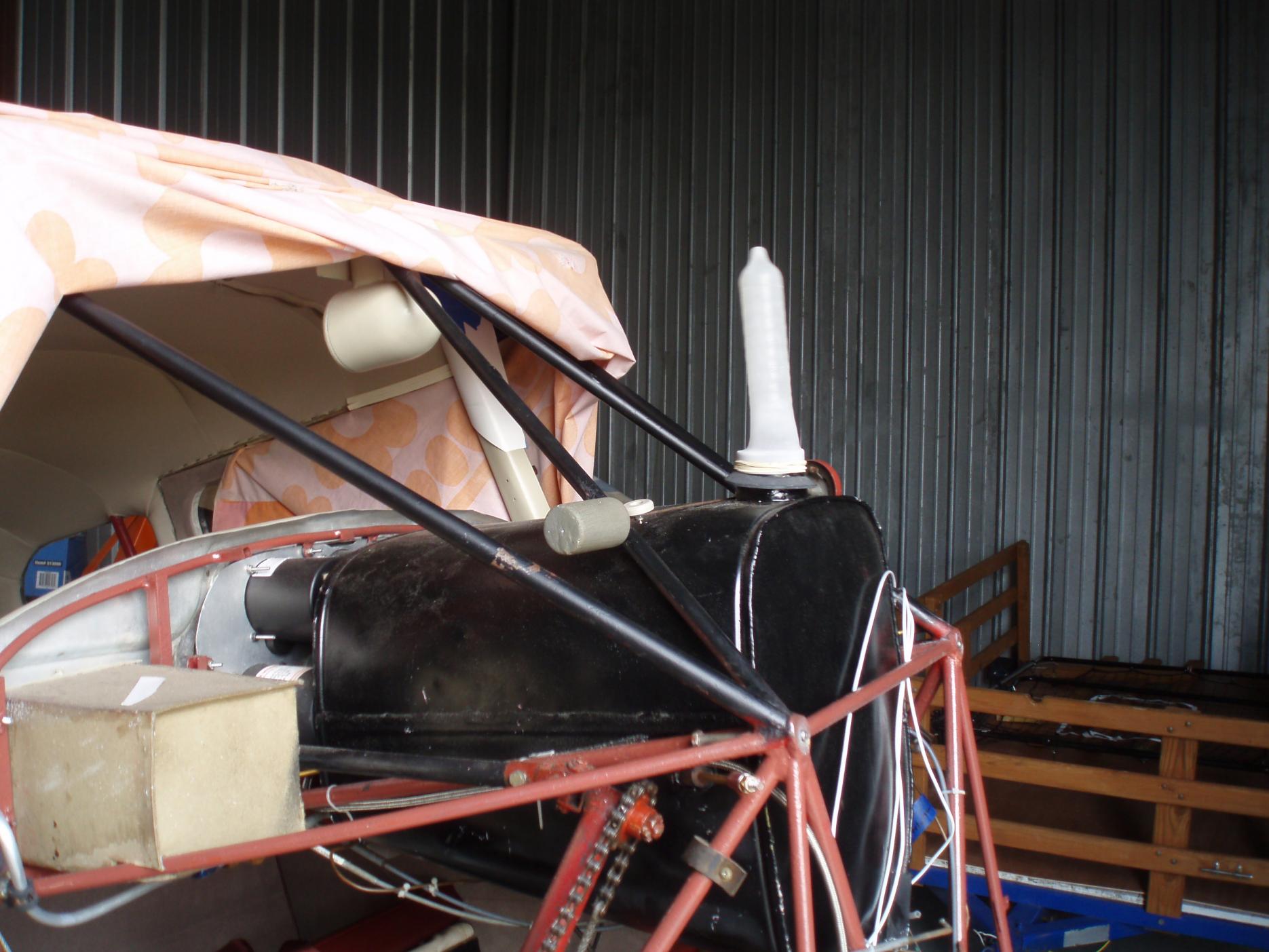

          Don't know if there enough filler neck sticking, but you might be able to use Hank's method of blowing up a condom and slipping it over the neck. If the condom holds air, the tank/filler neck are sealed and the cap seal is suspect. If this is the case, you could fill the tank, raise the tail to level, and open the valve to check flow from wing to main with the condom pressurizing the tank. If the condom doesn't hold pressure, I would suspect the seal between the tank and the filler neck.

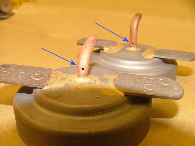

            I would bet you have an additional leak in the tank or the filler neck. Does your cap by any chance have the little hole drilled in the back of the curved breather tube? That small hole that some people put in in case the tube gets plugged totally destroys the whole reason for the curved breather tube. If it is there, SEAL IT OFF!
            The other thing to check is the condition of the filler neck contact surface. If there is a radial cut in the surface the seal may not "seal". You can test the system for leaks by putting a condom (OK, don't laugh) over each filler neck, disconnecting the fuel line from the carb and blowing back through the fuel line to "inflate" the fuel system. The condoms are to protect the fuel tanks from over pressure and NEVER (NEVER NEVER NEVER!) put shop air into the fuel system! The condoms should inflate and HOLD AIR. Then have someone shut off the firewall valve and wait. My fuel system held air with the condoms inflated for over an hour.
            Take pictures, the reactions are GREAT when you show them. I promised to show the pharmacist the pictures. I REALLY don't think he believed what I wanted them for till he saw the photos.
            Couple of hints, DON'T get any fuel (even a drop) on the condom, it will pop, and you DON'T have to put a bag over your planes head to do it like I did, I was just trying to keep the cockpit clean.

                          ...Does your cap by any chance have the little hole drilled in the back of the curved breather tube? That small hole that some people put in in case the tube gets plugged totally destroys the whole reason for the curved breather tube. If it is there, SEAL IT OFF!
                          I disagree. The pressure from airflow with the forward-facing tube will not be diminished THAT much by a tiddy hole in the back face of the tube. Lack of regular inspection of the tube (and a wasp's nest) could crumple the tank.
                          The main reason for lack of flow is (as already reported) poor sealing caps, or too-small diameter pipe to the fuselage tank; hence the Gilberti/Harer pipe size requirement).
