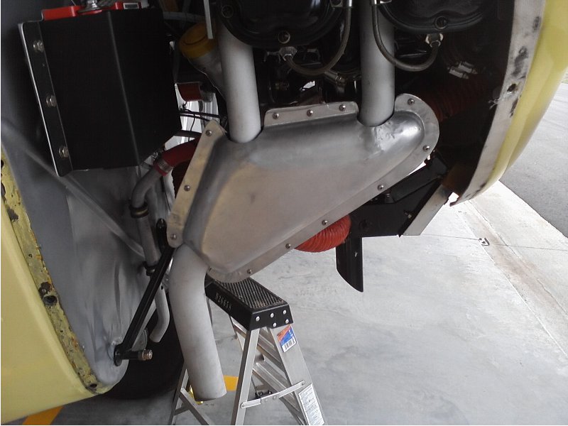

                I can't bring myself to cutting holes in the cowl. I also saw the rather cheap crap available for heat muffs for the Luscombe on a friend's plane. It looked like they used soda can aluminum to build them. Can't remember who the supplier was but they were terrible.
                    The right stack will drop in the factory hole with minor trimming. all you need to do is cut the second hole.
                      Re: Legal again

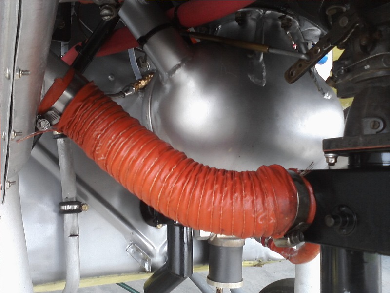

                      the heat muffs that i got from doug coombs at the luscombe foundation are made of very heavy material and also fit right very ease to inspect at annual have 2in outlets so flow to cabin heat box is increased as tcraft heat box is 1.5 in used a reducer side affect less cabim heat in summer as the exhaust is away from the fire wall and also my cowl was for a lycoming and had the hole blocked off with a doubler 3 in hole saw in the old hole and perfect fit

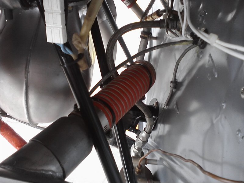

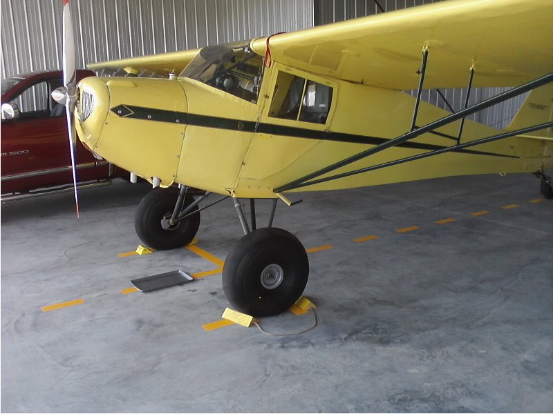

                        Here are some pix of what it looks like on my plane.Oh i did use terrys paperwork to make it legal chuck

                          The feed-through hole in the firewall was 1.25 inches on my plane, but the heat box could easily accommodate a 1.5 inch opening. I opened the fire wall hole to 1.5 inches and that improved things a bit. I was in Illinois at that time. I don't much need heat here in S. Texas.
                            Re: Legal again
                            Read something some were that there were two part numbers for cabin heat controls maybe 1.25 and 1.50 as my heater is 1.5 at fire wall southern and northern
                            1940 BLT/BC65 N26658 SER#2000
