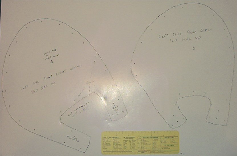

There are, but they are different for every different size strut (and there are a BUNCH of different size struts). You need the measurement of the major and minor axis of each strut. Don't be surprised if they are different from right to left on your plane. If I happen to have the pattern for the size strut you have you are welcome to a copy of them. They are simple to make and difficult to get to fit perfect. It is pretty easy to cut the fabric with the edge of the metal while you are fitting them so I put a layer of cardboard over the fabric for fitting. Once you get them to fit they look great and go on and off really easy.
If I don't have the right size (and no body else does) you can enlarge or reduce the pattern to fit but it will take some time.
Make the first ones from poster board or you will waste a LOT of sheet aluminum.

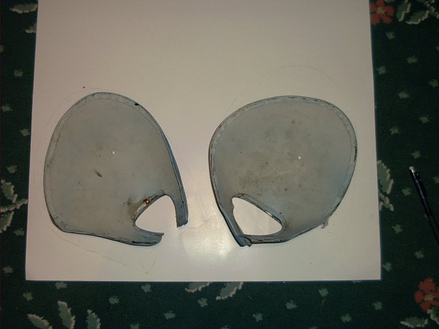

Excuse the poor photo. but it does show the outline of the cuff
As Hank said, cut several out of posterboard before cutting the aluminum. Flat pattern, When the ears are wrapped around the strut the whole thing becomes dish shaped.
cut the opening to fit your strut. rivet rubber flashing around the edges.
hole in center is for screw to attach to strut mount.
wrap ears around strut and screw together.

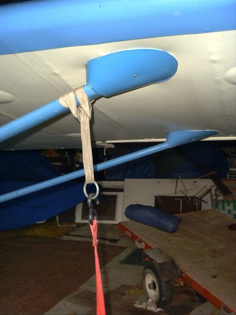

Make a 'c' shaped clamp to attach to the lips of the attach bracket and drill a hole in the center. Piper used this method. I have also seen a drilled and tapped a #4 hole in the lip of the attach bracket.Originally posted by whake View PostYou mention a screw attached to the strut mount,,,did you drill and tap a hole in the mount...I made cuffs but I do not Know what to do with that center hole

I guess I assumed all strut mounts on the wing already had a factory drilled hole for the center cuff screw?
Cut a cardboard template. Form it around the strut. Trim the outside of the template until its center fits flush on the strut mount, keeping in mind that the finished product will have the rubber trim attached. Then drill a hole for a PK screw.
A spacer could be used but that would make the cuff larger than necessary. Adds more drag.
