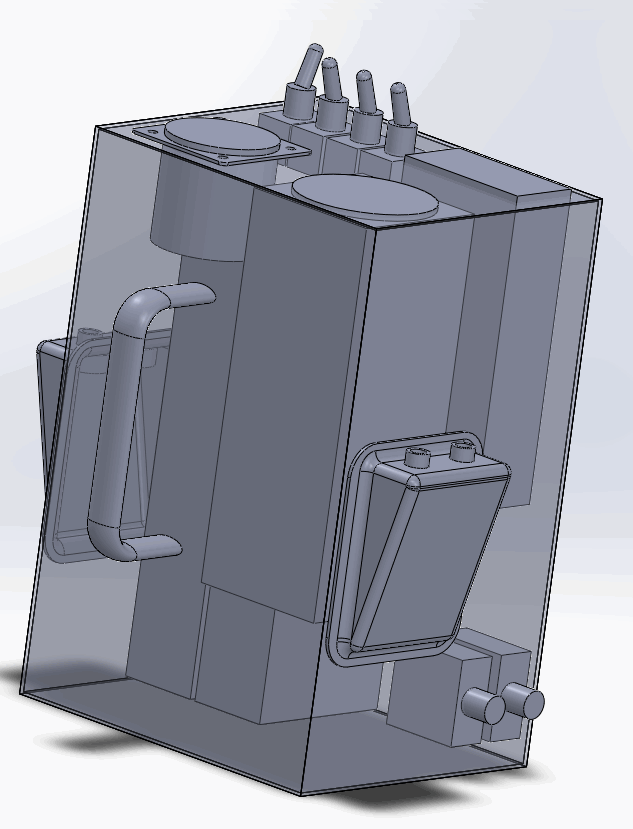

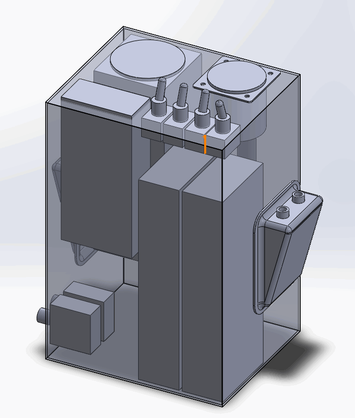

    I'm planning to make a box to hold a 5Watt radio and intercom.
    Similar to what several other members have done.
    The big rectangular component with a round face is a MicroAir M760 radio.
    The rectangular-faced component below that is the intercom (probably PS Engineering PM1200)
    The round-faced component with a round body is a voltmeter. But the one I planned to put in there is no longer available. So the actual one probably won't look like this.
    The two rectangular components completely inside the box are 2.3 Ah batteries.
    Two circuit breakers are peeking out of the pilot side of the box.
    Missing from the sketches below are several ports in the box. I'll have two charge ports probably on the co-pilot side. One is a cigarette-lighter jack.
    Also a music input. And the antenna connection comes out the pilot side near the circuit breakers.
    I'm interested in any feedback. Anything look like it won't fit / work?
    I imagiine that it is a fairly self-contained unit that I can remove from the airplane for battery charging.
    I imagine strapping it to the kickplate below the front of the seat. But I don't have a concrete plan for how to make a strap, yet.

    When you actually make it try and stack components to make it as flat to the kick plate as you can. I built mine to go into an original pre-war size battery box and once in a while I bump a shin against the box. A half inch further back and I would always miss it.
    If you are always going to take it out to charge it you could put the charge plug on the aft side where it would be covered by the kick plate when in use and leave useful face space.
    You also want to dummy up a box and put all the connections into it before you freeze the design. The wires and jacks for the headsets got moved a few times on mine before I was happy. Also don't forget you will need two PTT jacks somewhere and a switch so you can isolate the passenger to intercom only so they don't start chatting to you and it goes out on the radio. I ran the radio connections from the pilots "A" pillar where the radio clips through the pilots under door cover and behind the kick plate to a hole right at the battery box. There were a LOT of zip-ties to make sure nothing got in the way of the gear. I wanted a volt meter and an amp meter, but haven't found any of a decent size (small enough to fit in but big enough to read).
    The original batteries before the war were held to the floor by two bolts through tangs on the box, but since mine will be charged in place I plan to add a fastener through the case so it can be tied to the steel tube behind the kick too. Mine is also designed to connect to a wind generator so I have a field, master and accessory switches as well as fuses and several hidden 12V Cigar jacks for hand held devices. Of course all of this is put in with FAA Velcro and zip ties. ;-) I was lucky that the original design hold down bolts were on an old floor board I measured so I could put the box in the original position. Funny thing is the box isn't even in the plane right now since I really don't use it yet. It's all in one of the boxes in the hangar.

              Hank, my current design (seen above) uses a cabinet that is 5" deep (that's how far it juts out forward from the kickplate). How deep was yours?

                The pre-war boxes were approximately 4.5 x 4.25 x 7.5 with the box sticking forward of the kick plate by 4.25.
                These are NOT accurate dimensions, just something taken with a cheap ruler on the run. I do have the pattern to make them.
