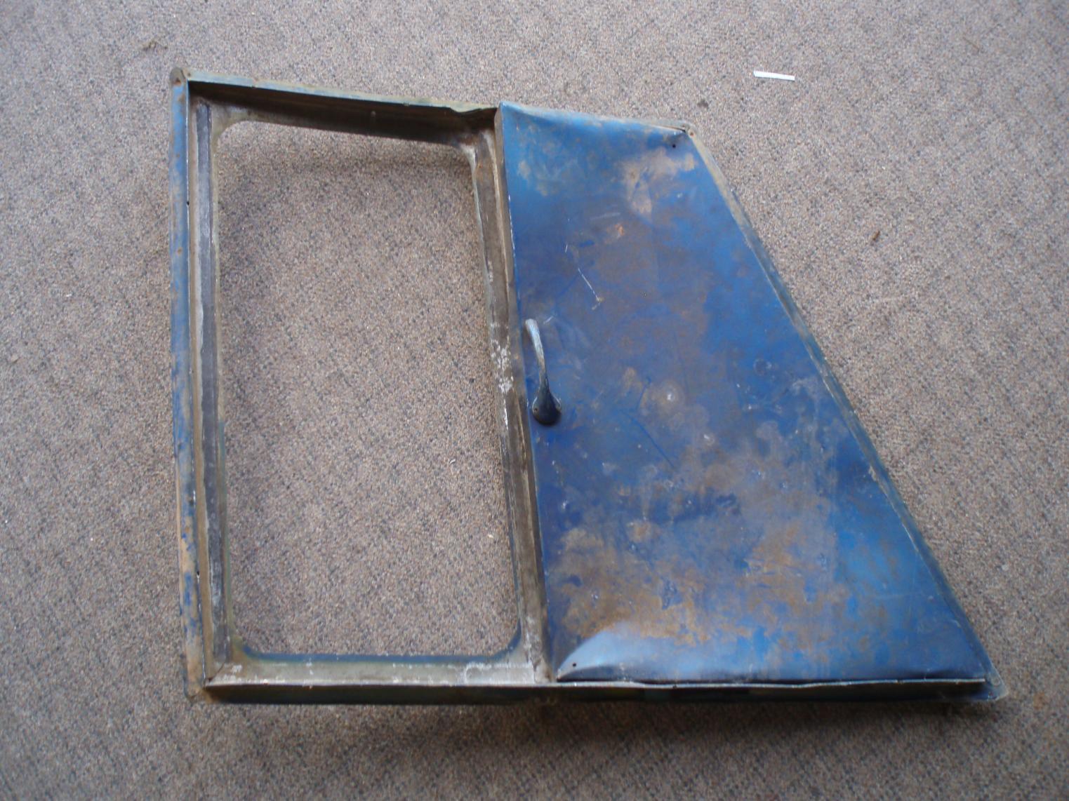

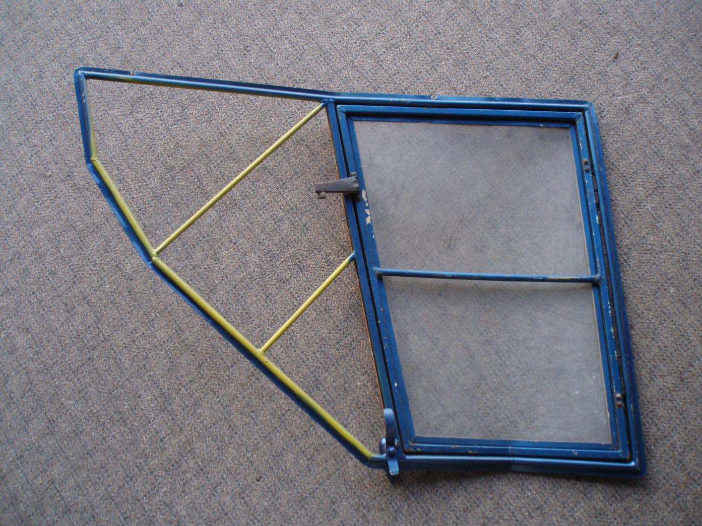

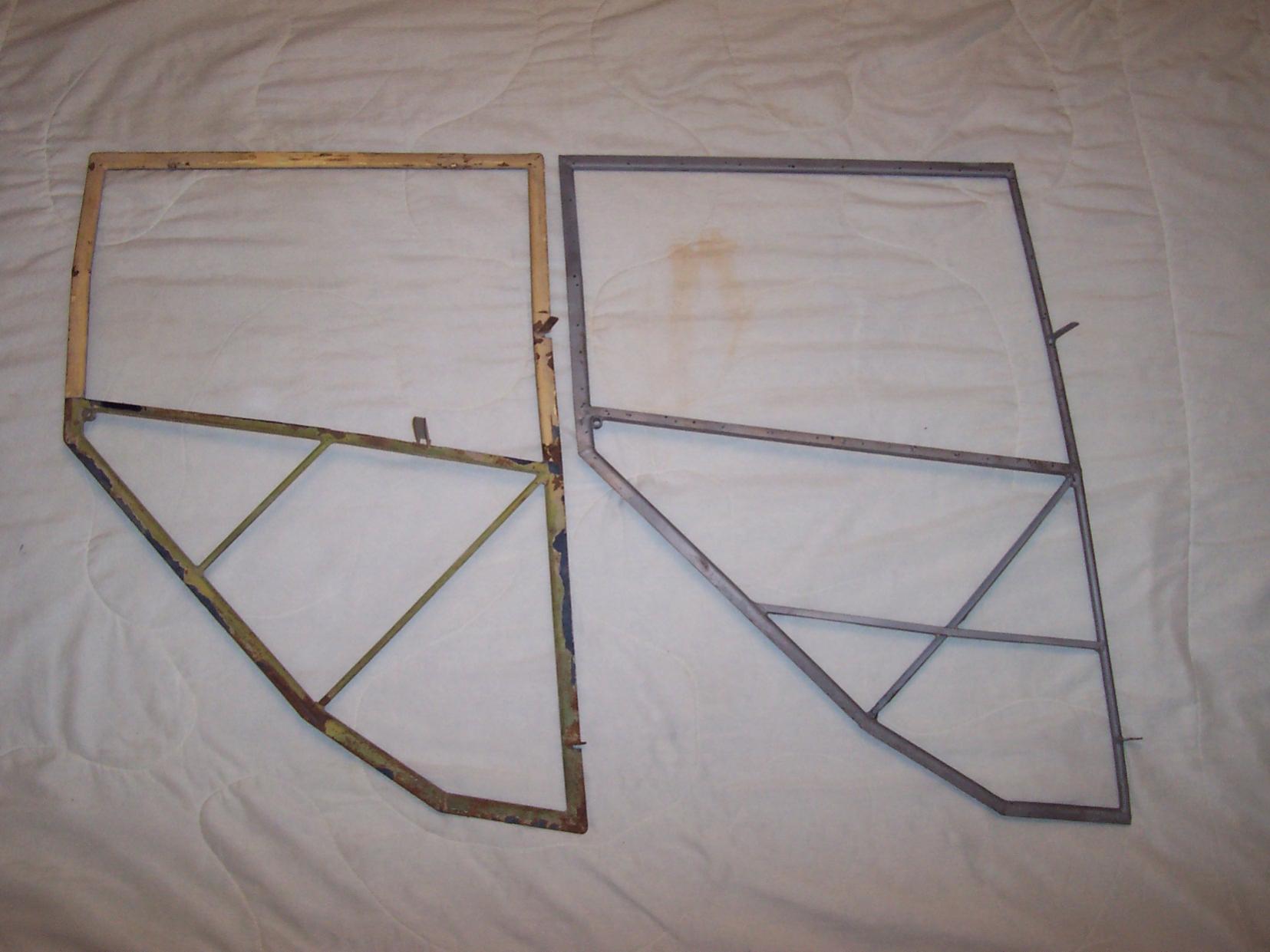

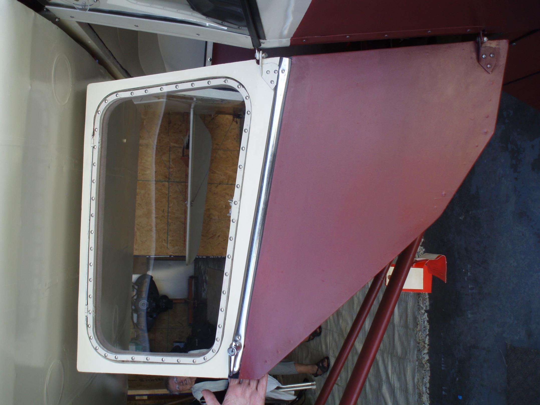

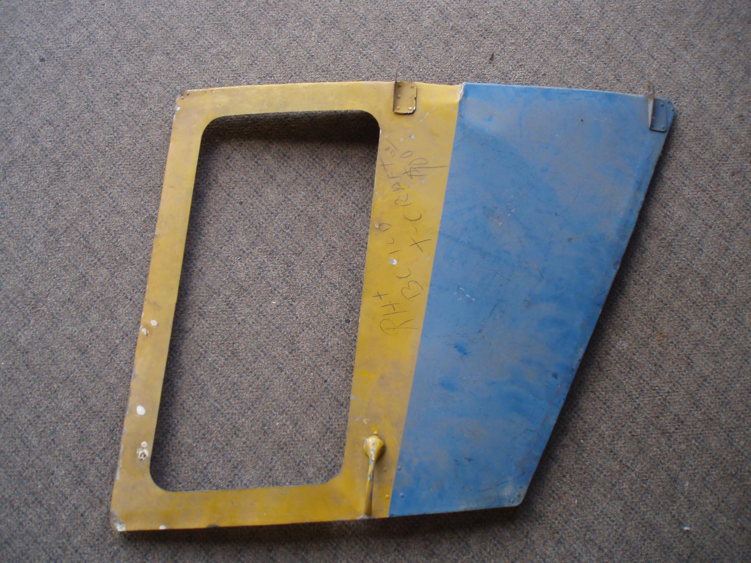

                        The tube frames in these pictures are pre-war. The ones with two diagonal tubes are from my 45 Deluxe (I tend to lump the 45 planes in with the pre-war ones since there are SO MANY pre-war parts on them)
                        The door with the front edge up (Ivory over Red) is a 41 Deluxe wood door. Really nice feel, quiet and almost impossible to build. Feels like an antique car door when it closes.
                        The inner and outer pictures of the sheet metal doors are from a post war (~1946) plane.
                        There are loads of other differences in handles and windows too and this is just the side by side planes.
