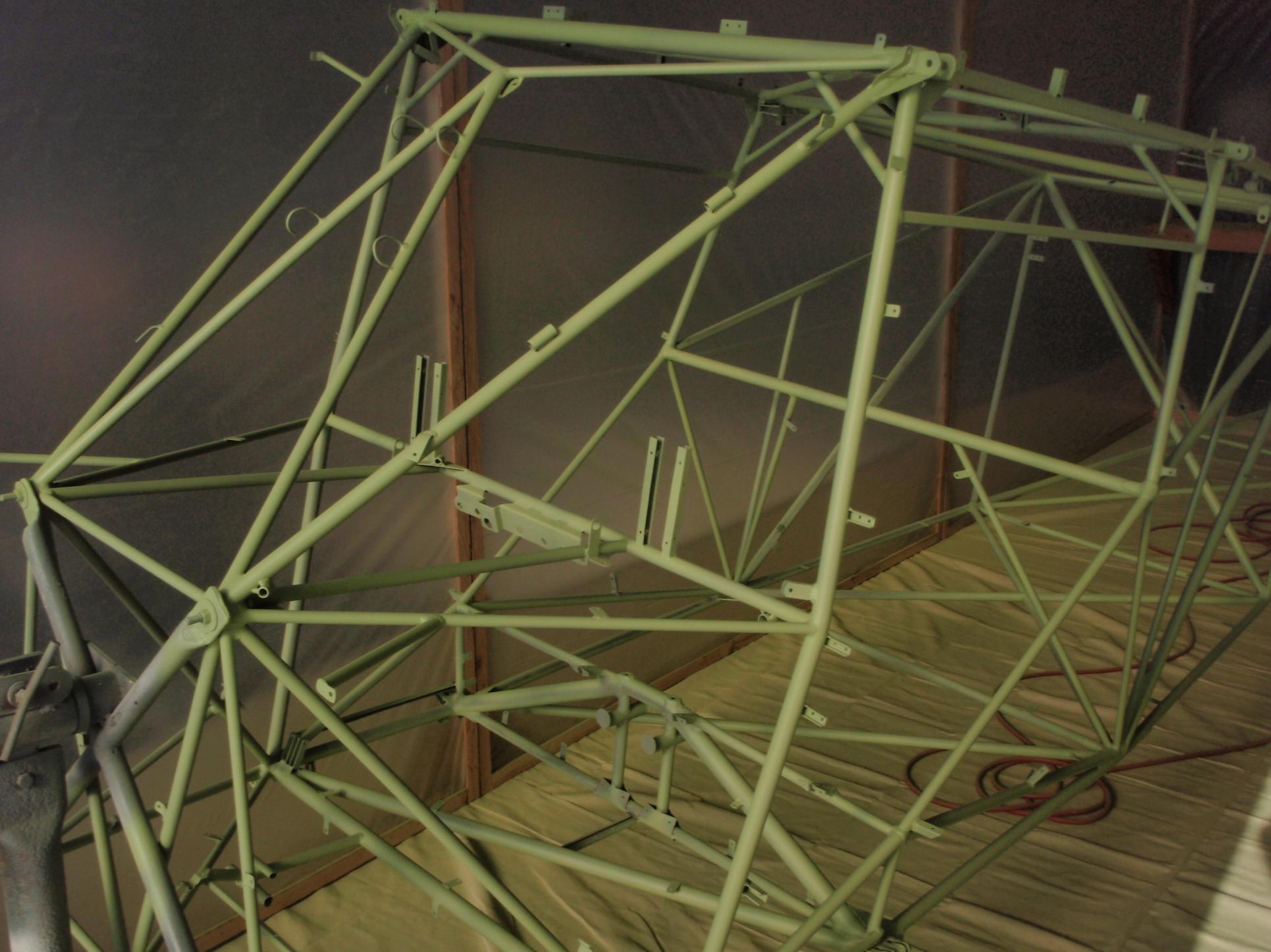

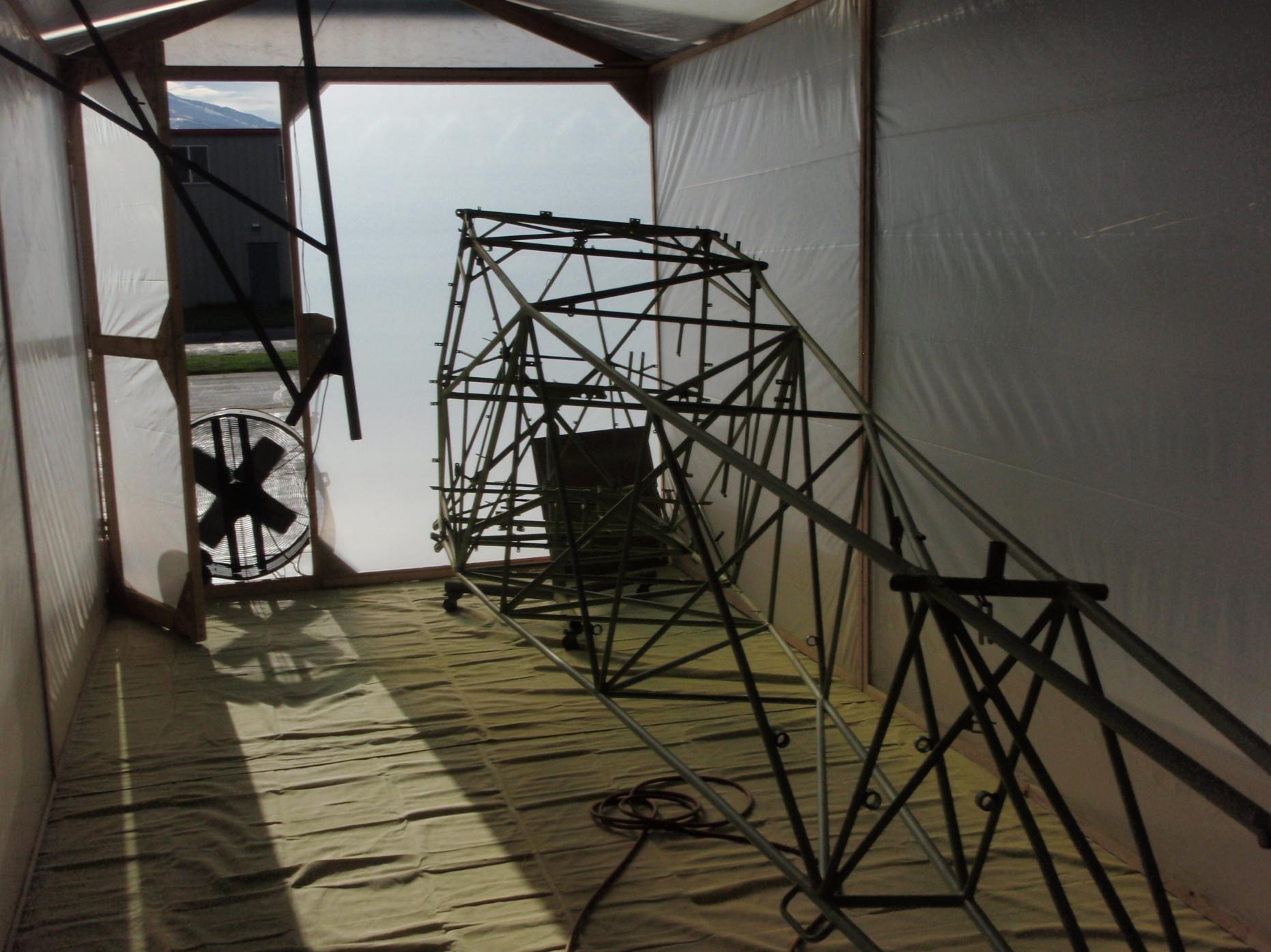

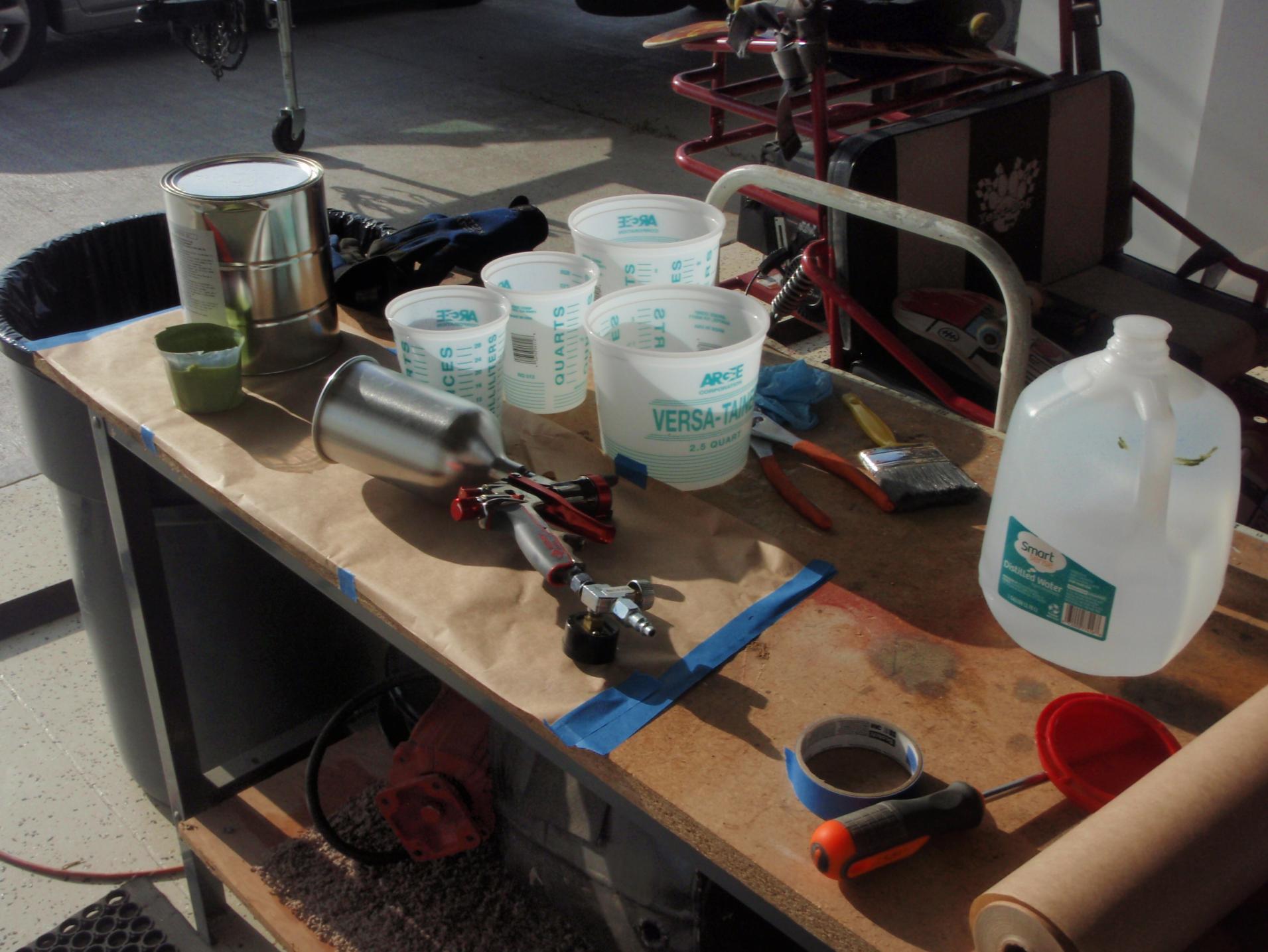

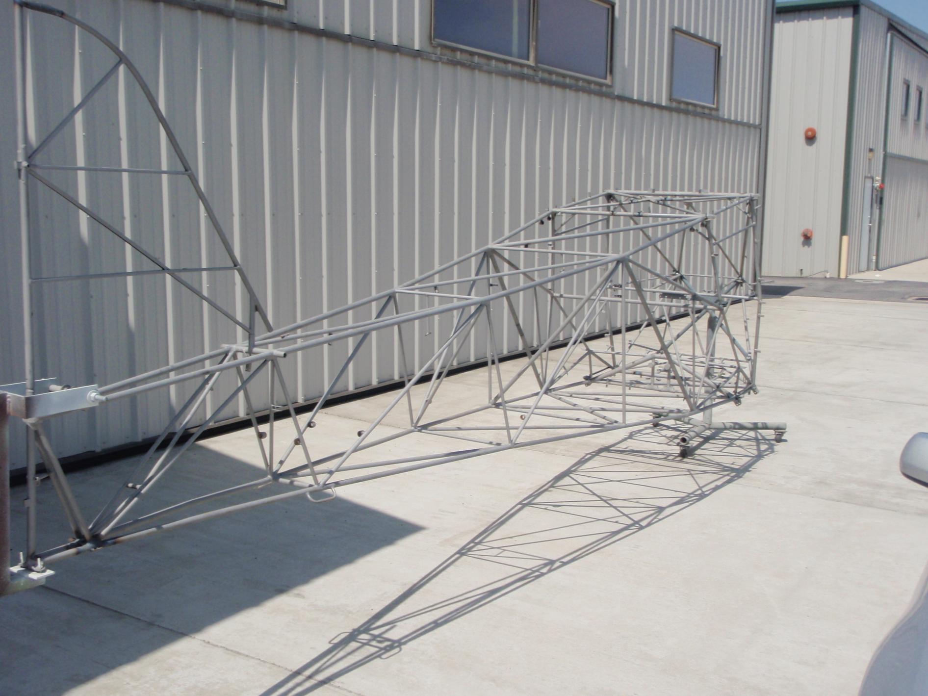

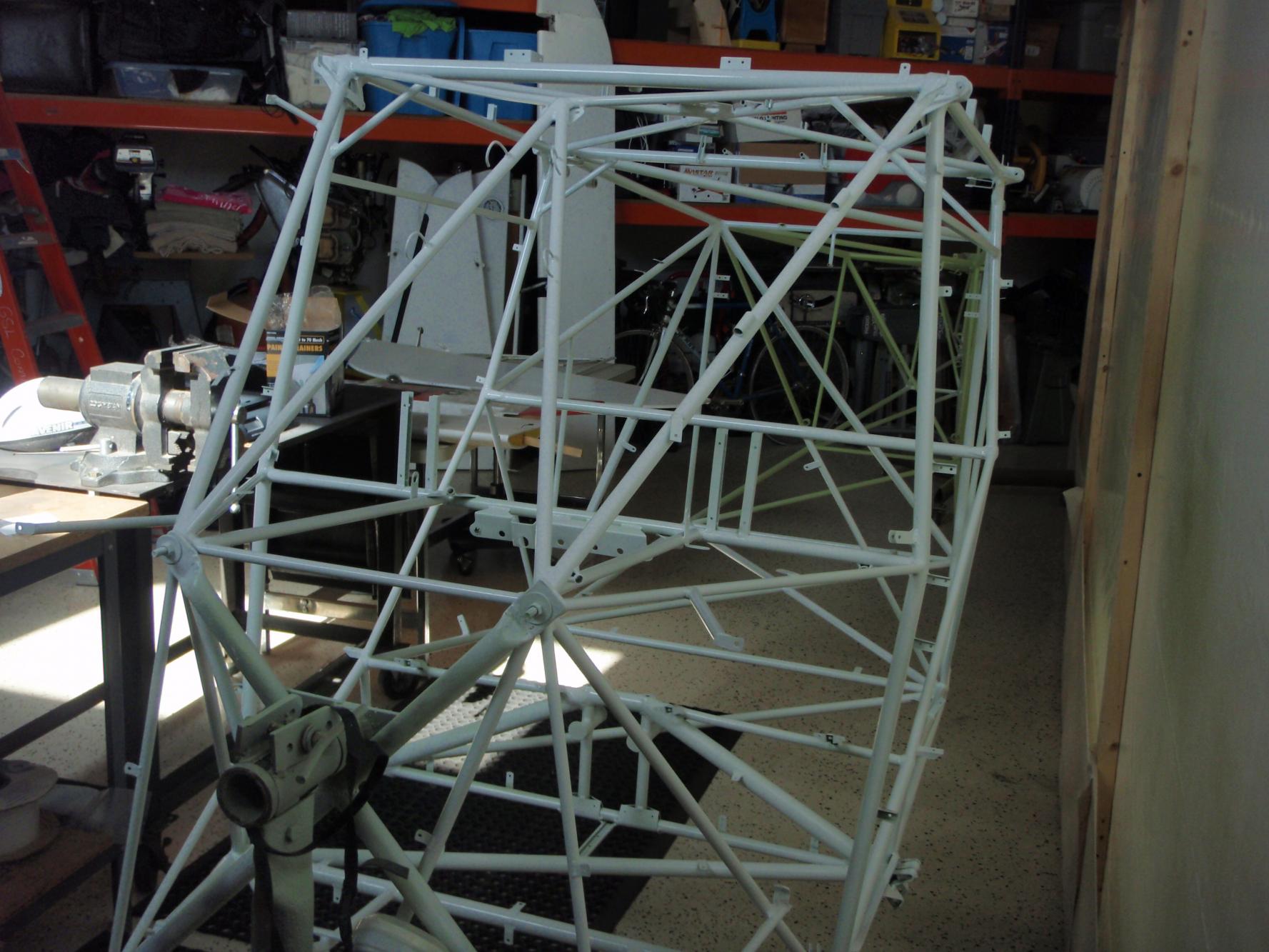

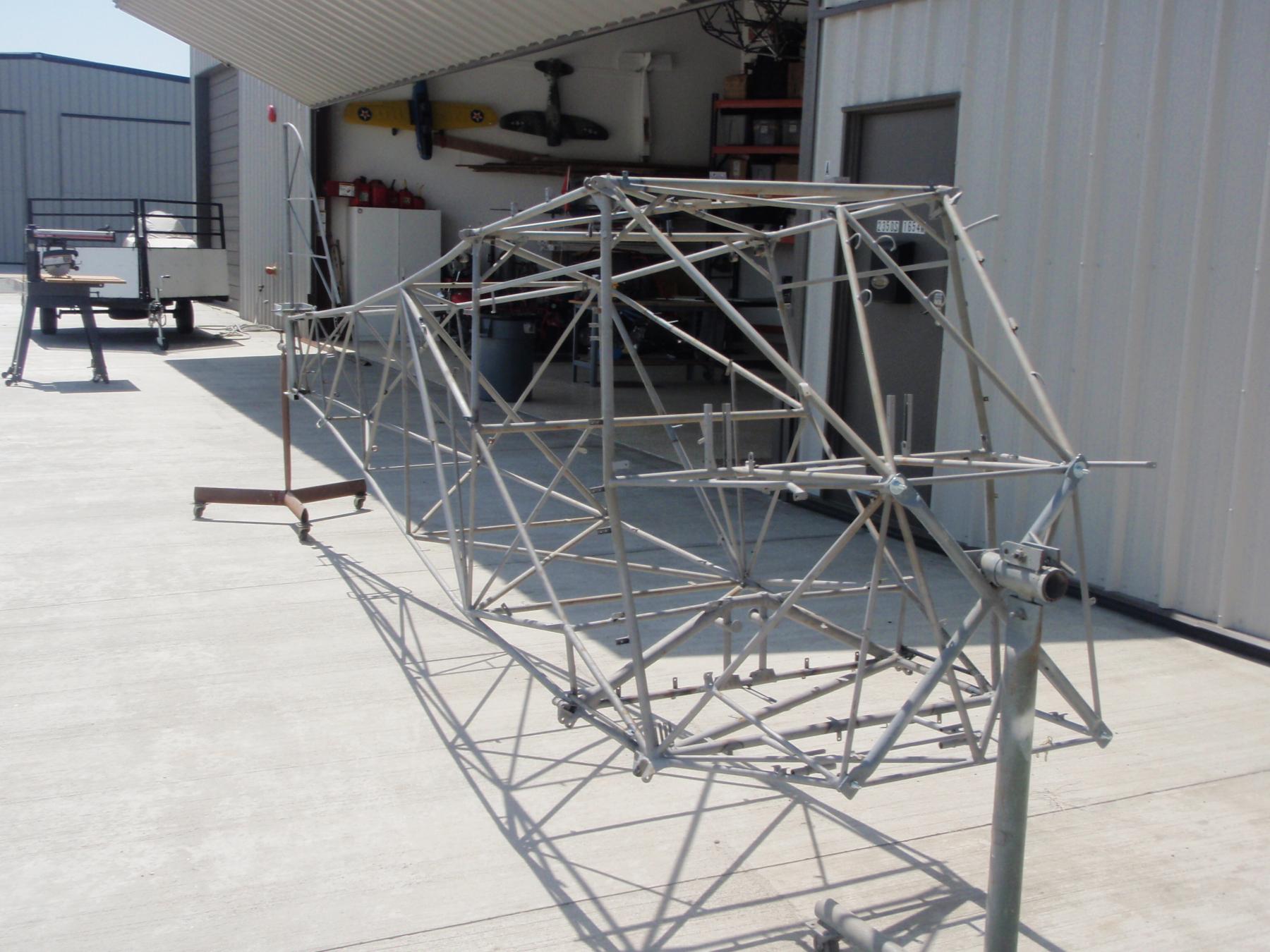

    Here are a few more pics of my sandblasted fuse. I used the Stewart system for my priming and painting. I followed their directions, watched their DVD's for product use as well as safety equipment down to the brand name of respirator. I had no issues and was very pleased with Stewart systems products and it is very user friendly. My hangar is attached to my home and after all that painting I had no odor or unpleasant smells in the house and all clean up was done in 5 minutes with warm water. When I visit my buddy's hangar down the way, you can tell if he has opened a can of the "other" kind of covering products, it lingers for hours.
