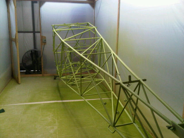

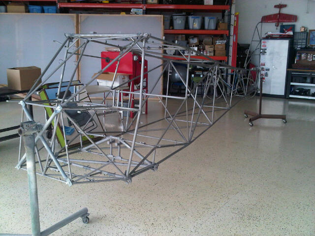

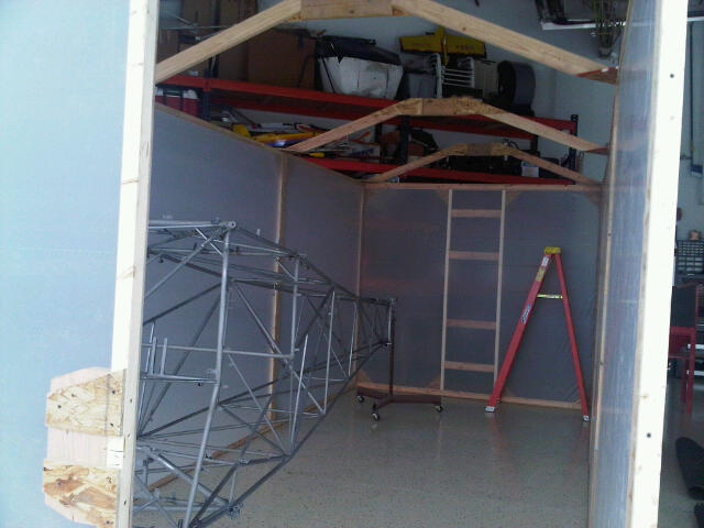

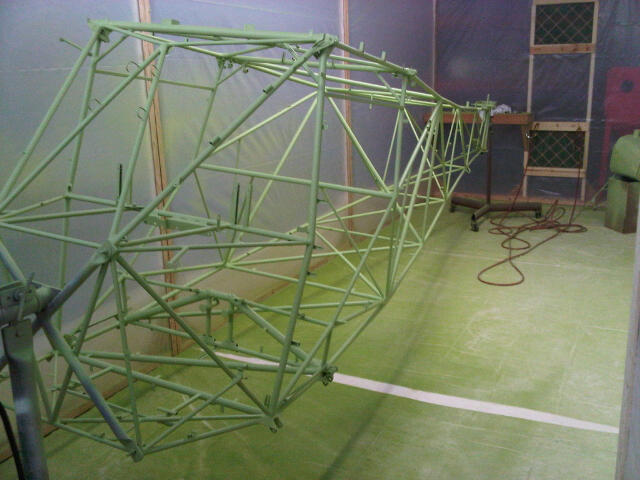

I have the Harbor freight blast cabinet and portable pot.... I use them for small projects and works great. I have an 80 gallon compressor with an a water separator and have never had any problems. However, I took my fuse to a local guy here that has done many vintage planes and old cars, I dropped my fuse off on a Wednesday and picked it up on Monday and wrote a check for $300. It was a bit of money but there is a lot of tubing there and I got mine back without a spec of old paint on it. I was really happy with his blasting and glad I didn't have to spend the hours flipping the fuse around to blast all that tubing. I built a spray booth in my hangar and I had it primed and painted within 2 days so it didn't rust. My 2 cents, attached are a few pics.
Brian
SLC-UT
TF#1023Attached Files

Nice looking paining setup, I really like your hangar floor. You sort of look like Charlie Sheen in the photo with the painting mask.
Are you using an epoxy primer / paint? If you are it is recommended to use a fresh air breather as a standard mask does not remove Cyanoacrylates in the paint mist.
No sense screwing up your lungs so you can not enjoy the fruits of your labor.
Happy FlyingRichard Herzberger
