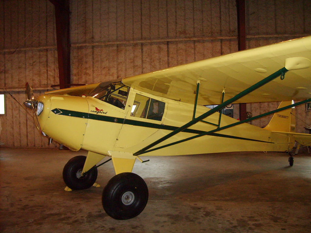

                I finally got it to upload!
                I took some pics at the fly in at Barber field last year. I have a pis of a step from Marty's Taylorcraft. I think?

                  It's red, but Paul Nuss had his there too.
                    Re: Step
                    I think it is yours Marty. My wife and I were talking to you and you offered to take my son for his first Taylorcraft ride, but Ken M. beat you to it. My project was disassembled when I got it. So I was taking pics of how things went together,tail feathers, steps etc.

                      Thanks, Dale. Miss Scarlett is a good girl!

                        Thanks guys one last question, from the picture it looks like the step angles back towards the fuselage is that correct? I don't want to do the right left thing.
                        Joe
                          Re: Step
                          When the step is on the correct side the step strut will angle away from the fuselage. If it is on the wrong side it will tend to roll down and under the longeron more and be harder to use. It isn't a huge difference....until you are trying to use it.
                          I don't remember looking that close, but I thought the step itself was pretty much parallel to the bolt holes so it will look like it is angled out from the longeron because of the curve of the longeron just aft of the strut attach.
                          If That description doesn't confuse you, nothing will.

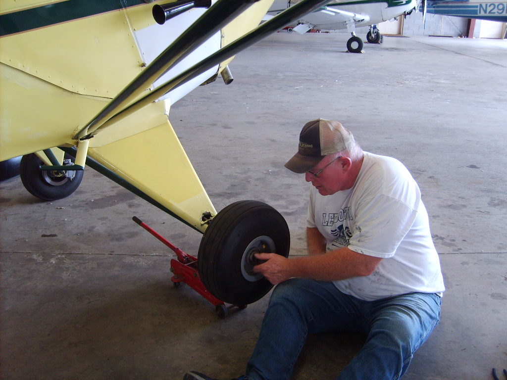

                            Here are a left and right side of the steps
