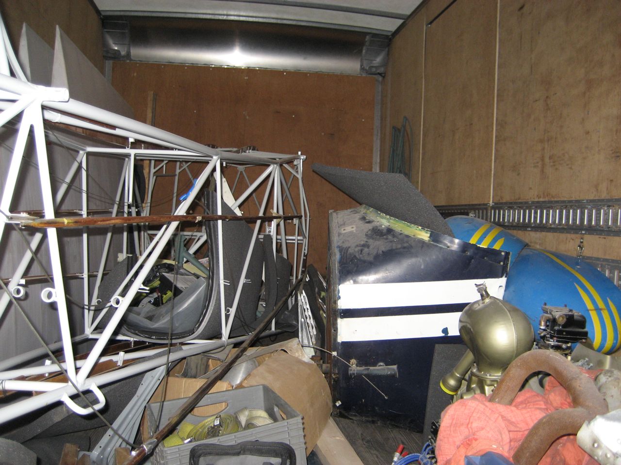

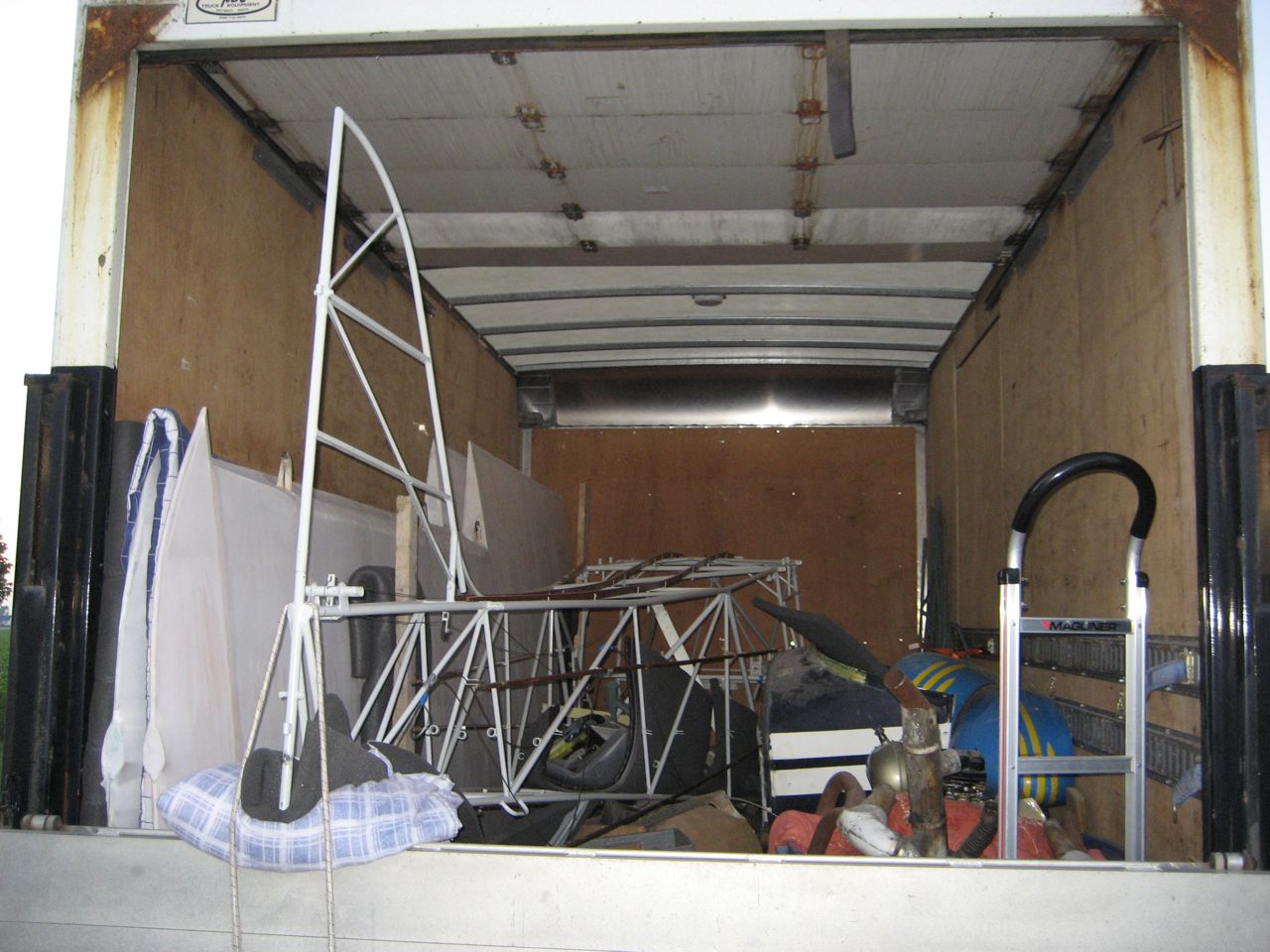

If you have access to a cube van it keeps every thing out of the wind, here is how I transported my entire project. Truck has a 17' box inside dimensions, when the door was left open there was 17' 6" to the lift gate. We just put some clamps on the door to keep it from slamming down. Here are a couple of pics.
