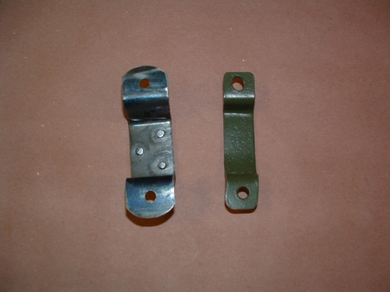

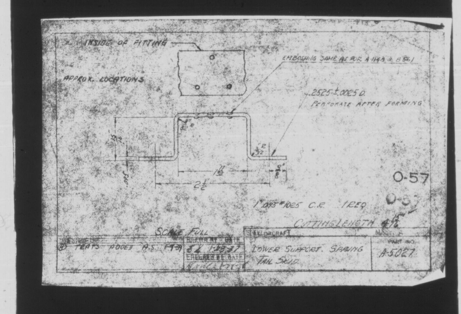

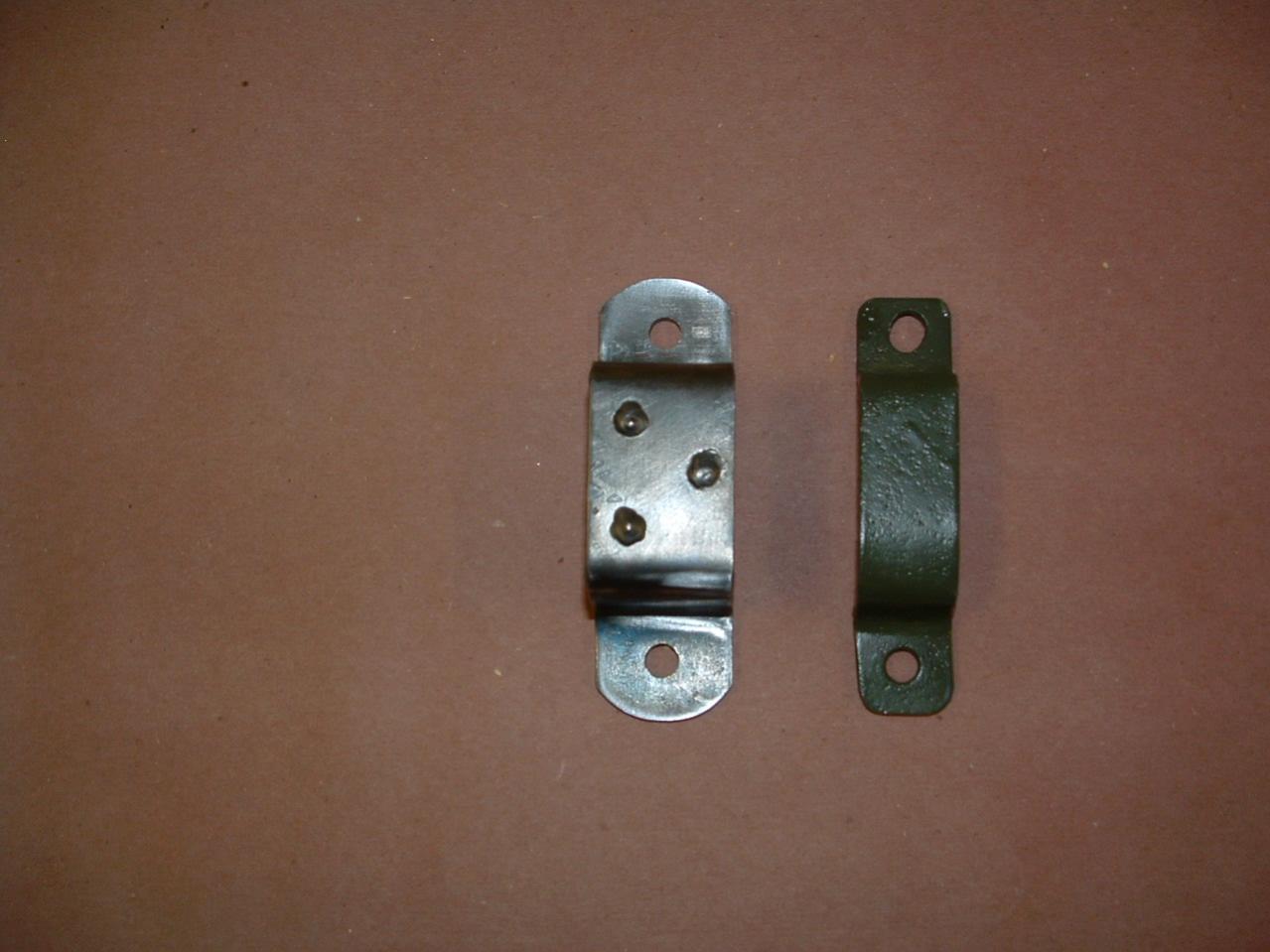

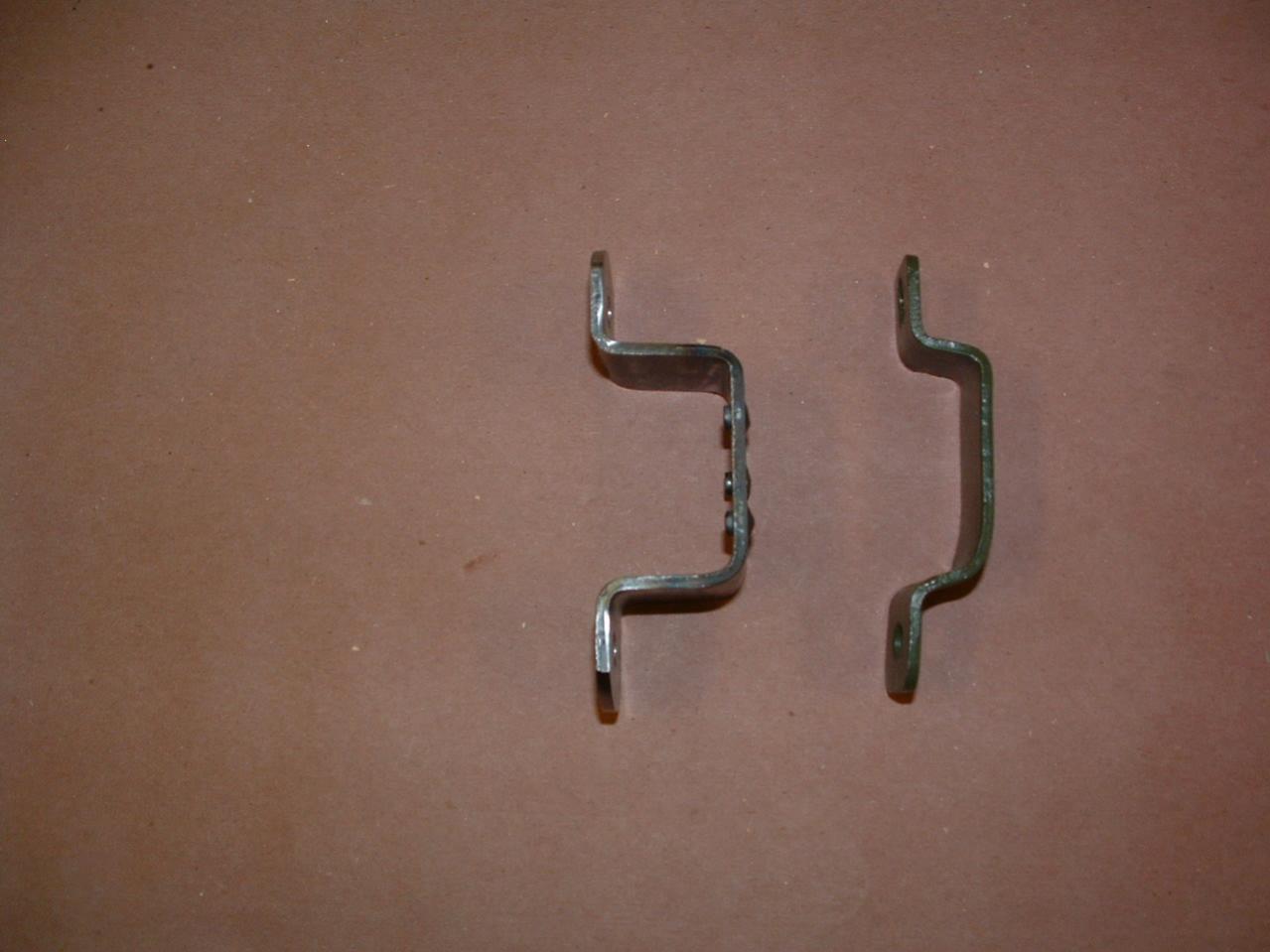

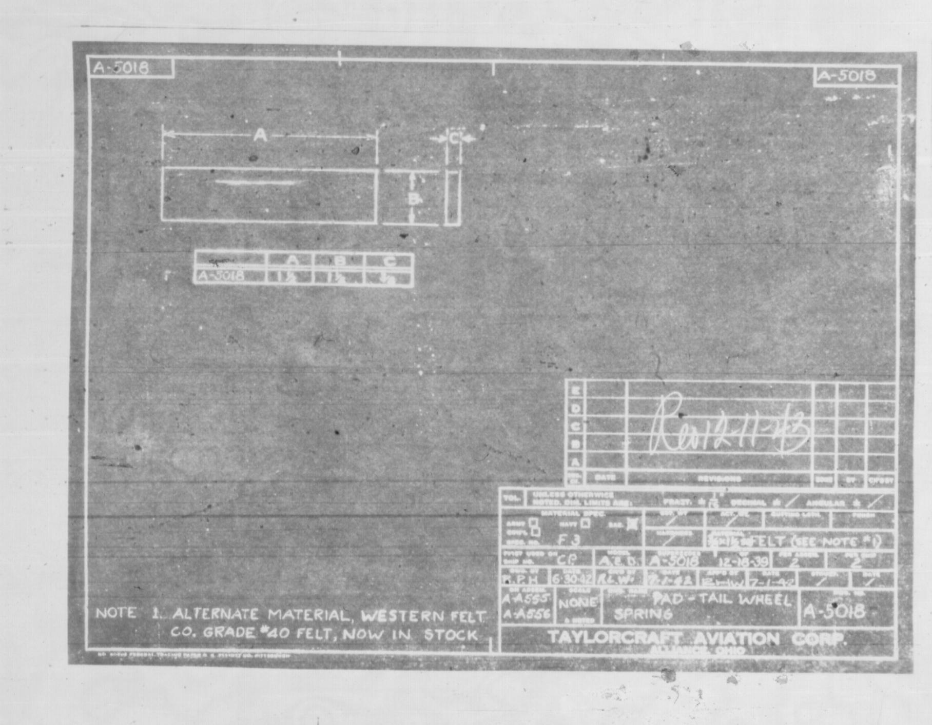

Here are some pics of my fabrication of the tail wheel spring bracket made to the factory drawings Forest posted on the web. The only thing I had to change was the 3 bumps that were pressed in at the factory. I welded small pins in instead.

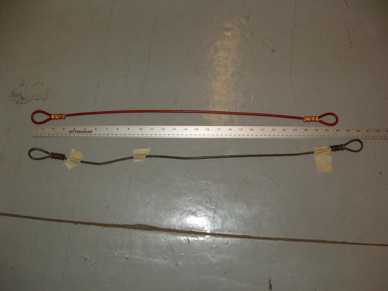

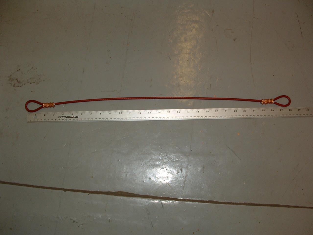

The last two pictures are of the my new Safety cables. According to what I found on the forum, they are supposed to be 27 3/4 inside to inside. The one I had was a full 2 inches longer. Any guess why mine was so Long? It appears to be original but who knows.
