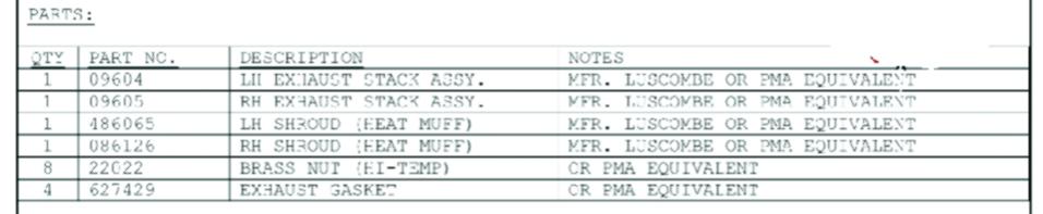

                            5. Attached is a parts listing for the installation
