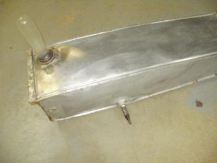

    I put a Schraeder valve on the fuel line and pumped it up with a bicycle pump.

    Suggest you use a ASI to tell the pressure in the tank.
    Doesn't take much to convert to scrap.

      I use the "condom trick" on my fuel system. Put the condom over the fill hole and then blow into the fuel line with the valve open. Close the valve and see of the tank holds air. You can see the condom inflate so there is no danger of damaging the tank. My main tank held air for well over a day and got some really interesting comments from the local "ramp rats".
      You don't see someone blowing into a fuel line and a condom inflating on a cowl very often. Sure works great though.

        I have seen someone pressurize a tank & assure there were no leaks.
        While walking away after disconnecting pressure & venting the tank a "crumpling" sound was heard.
        The tank was doing a slow implosion & crumpled up in a ball.
        Those 172 tanks do strange things.
