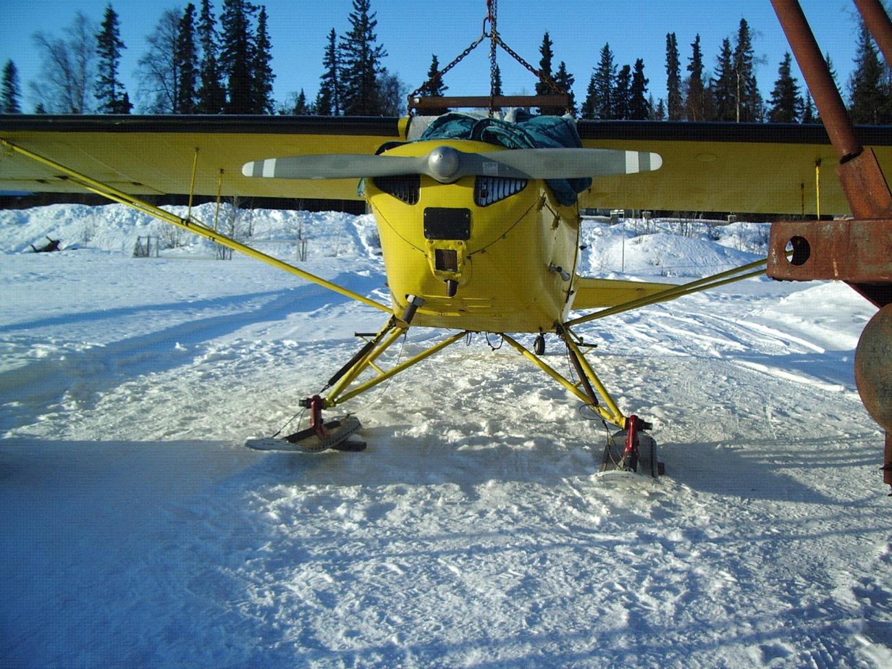

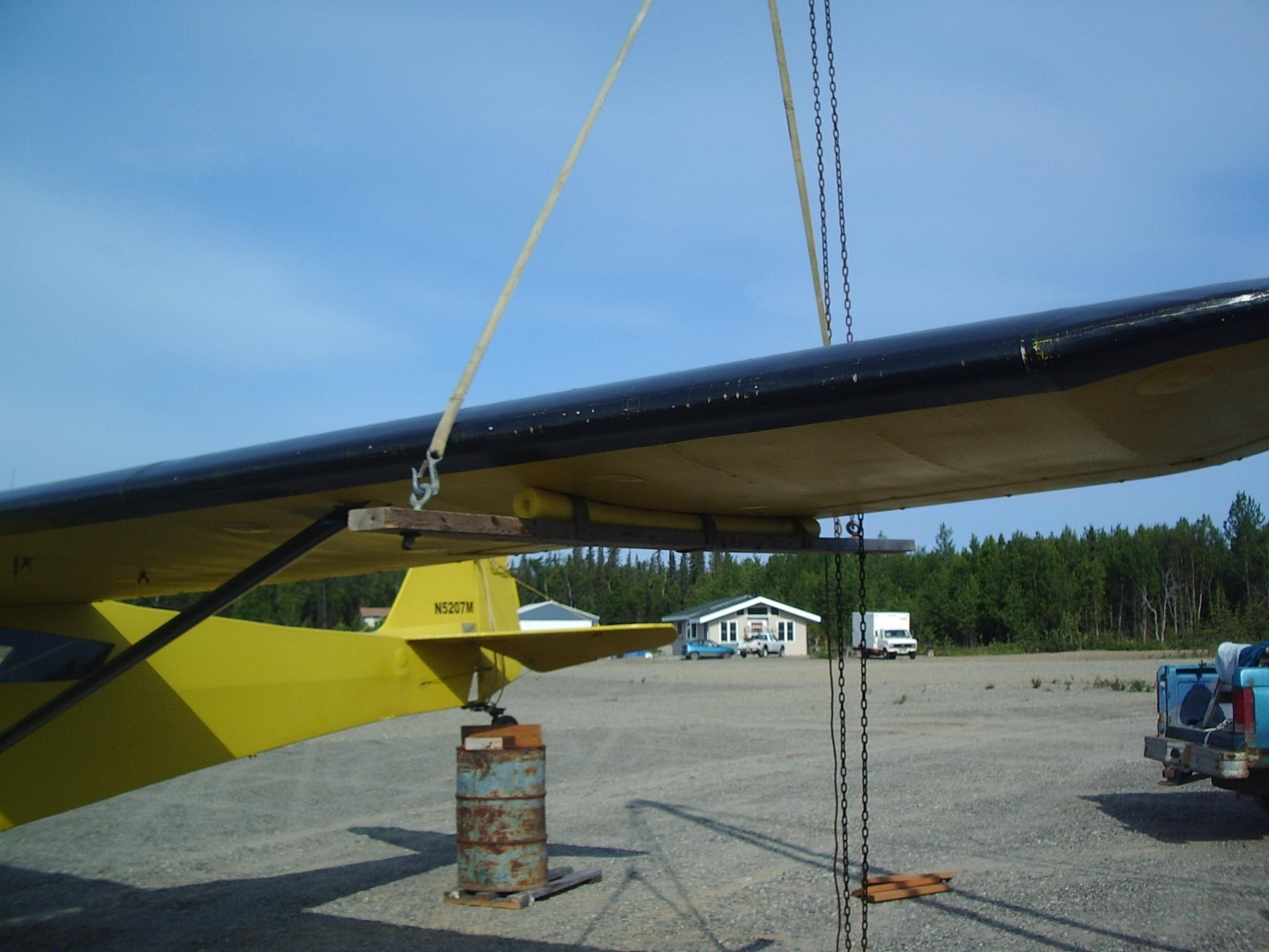

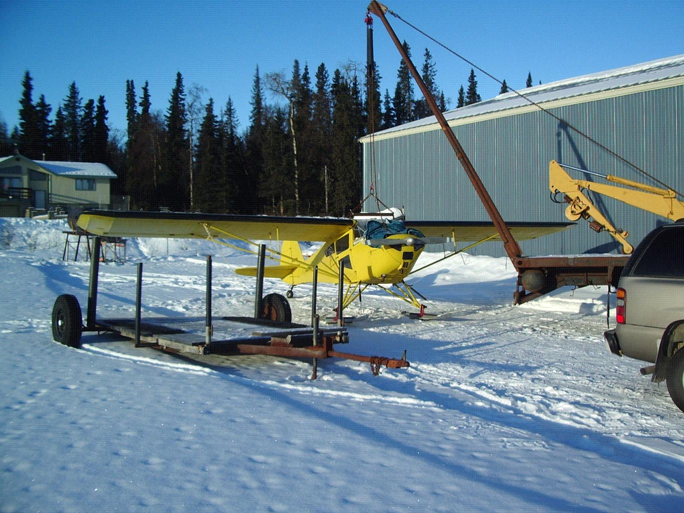

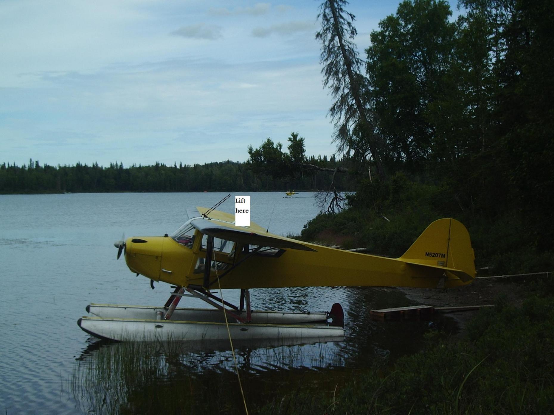

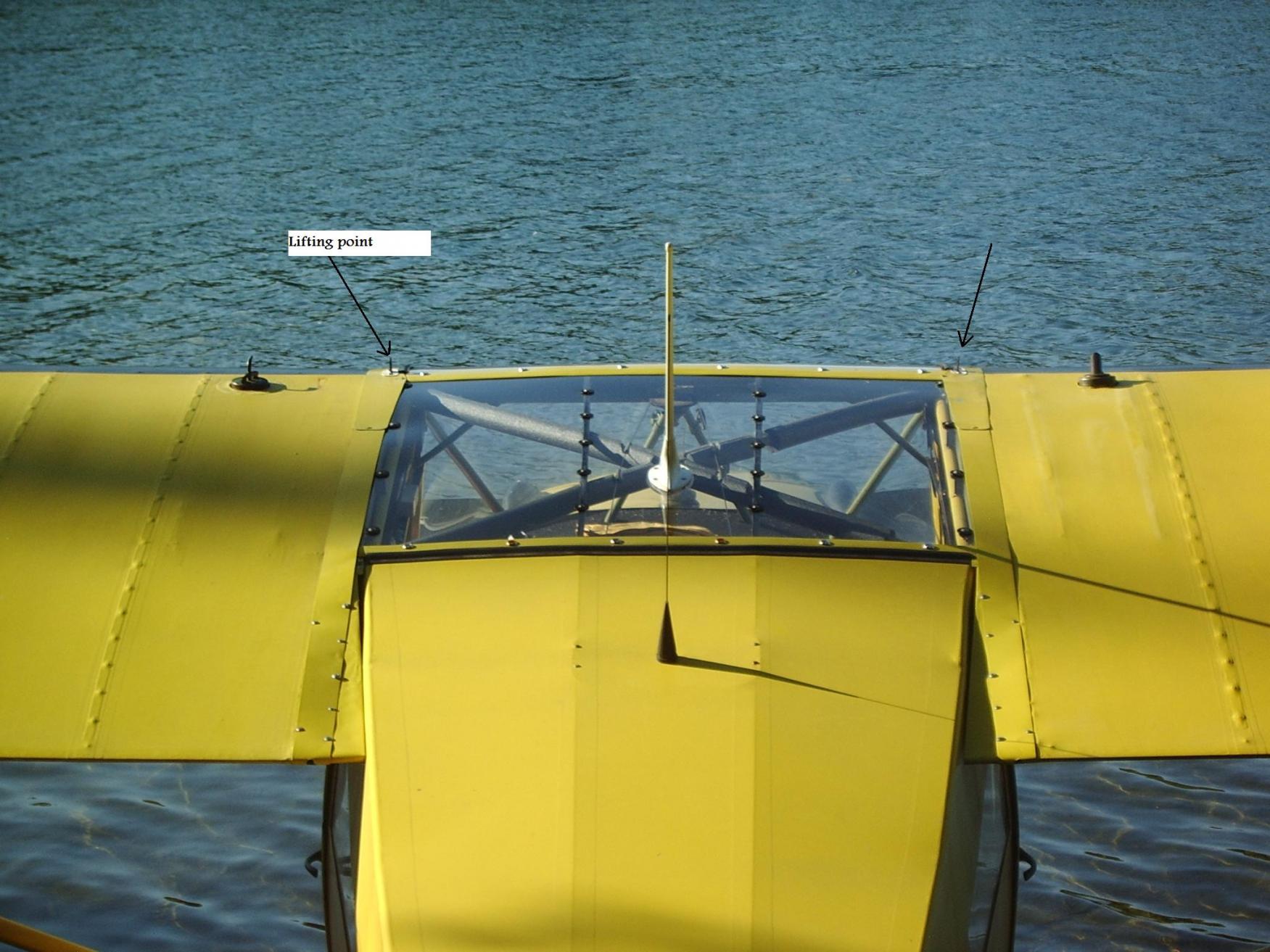

        When changing from floats to wheels or skiis, I use these Lifting points. Dick

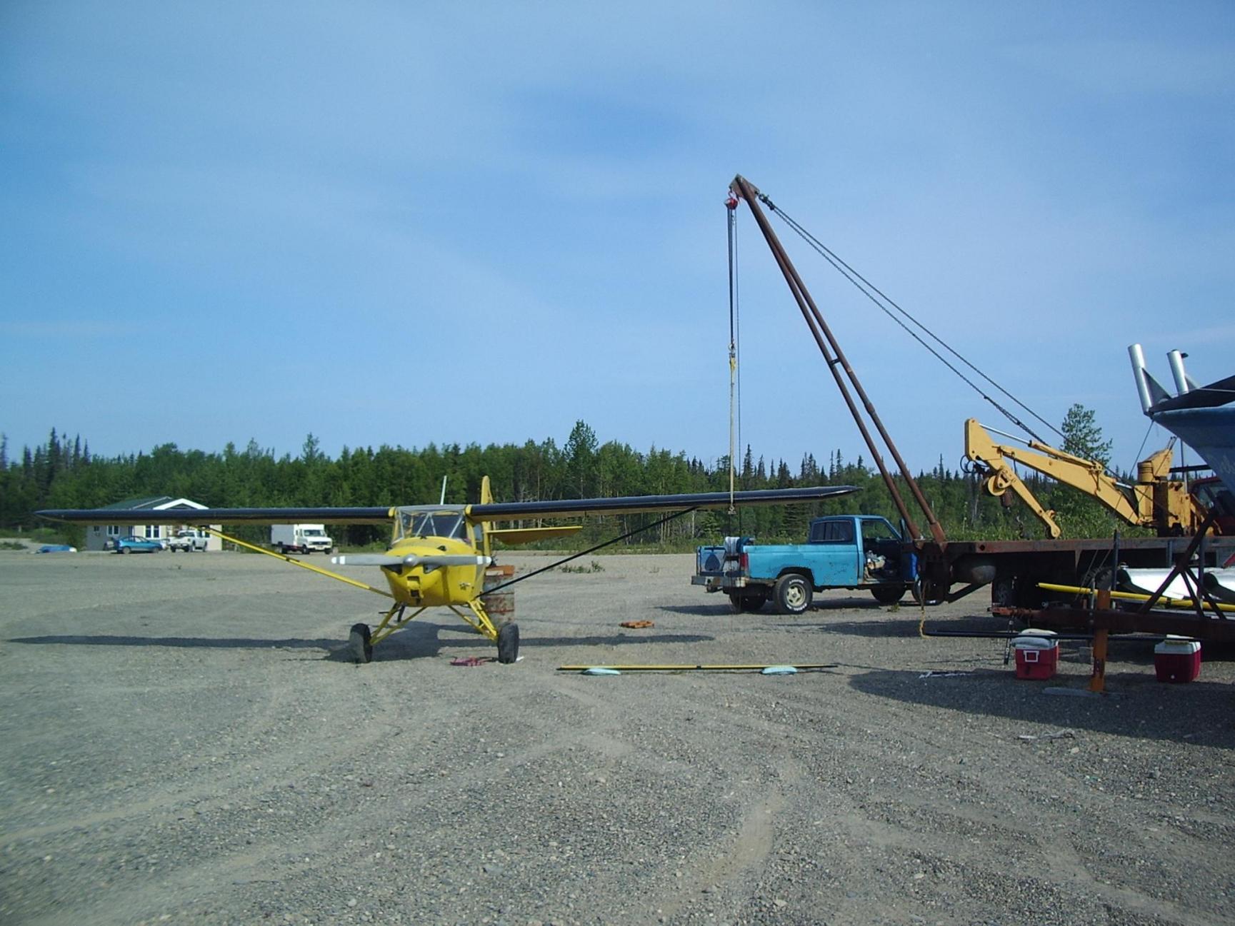

          Re: lifting eyes

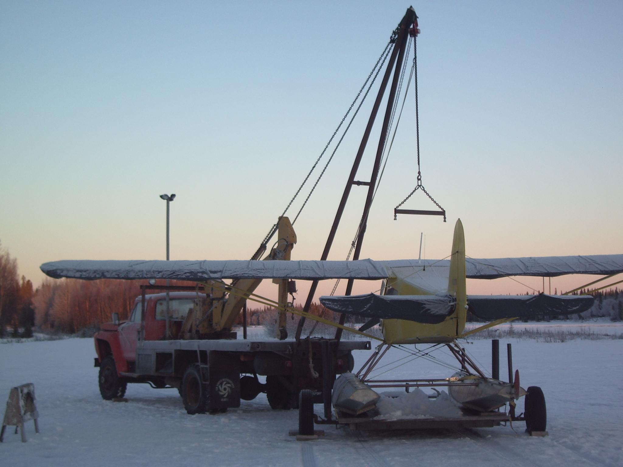

          Love those multi-purpose boom trucks. Ours has a Tulsa bed and has seen some strange things hanging behind! L
            Re: lifting eyes
            Larry, that old rig is really handy. I used it recently to install new Airframes Alaska LLC sealed lift struts. It has an old Case backhoe mounted on it that has a hydraulically- driven winch instead of a bucket. For the plane, I usually use the chainfall on the A-frame boom. It gives you control to the fraction of an inch. My 4 boys are really subtle when it come to that rig..."Dad, when you die, can we have the boomtruck?" Dick

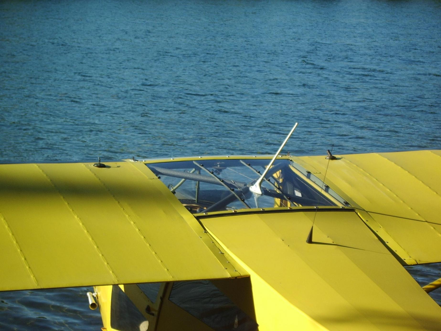

              Atlee Dodge has lifting eyes for the spar attach fittings. Tim

                  Re: lifting eyes
                  These are F Atlee Dodge lifting eyes, They work great, I also make them Myself when I have to.
