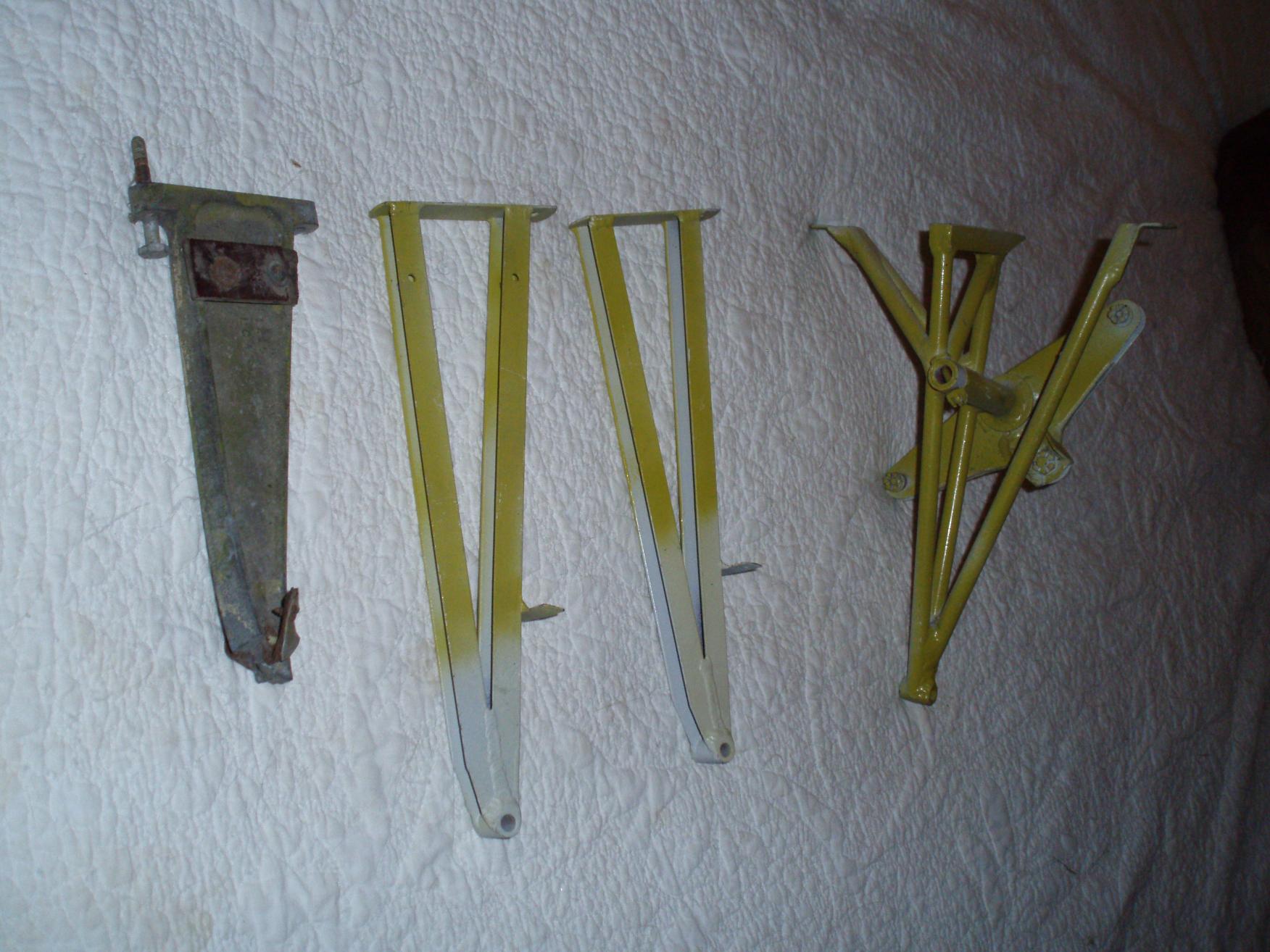

            The aileron hinge bracket I saw fractured where there is a metal tab bolted through at the rear of the bracket. Disimilar metals corrosion started in this area where it finally weakened it and finally fractured.
            Though probably hard to find now, I remember from years ago pictures of the two types of brackets being posted on the forum. I will do a little searching later to try and find them.
            After a quick search I found these pictures. I am sure I can find more later.
            The second picture of a bracket is on an L-2, I believe. The first picture shows where the break can occur with the magnesium bracket. Where you see the tabs attach to the bracket that attaches to the aileron cove sheet metal is the location.

                  prewar welded brackets look like the l-2, just a different dimension where they bolt to the spar. the mag brackets crack through the bolt holes where the hinge bracket is attached, and is usually the end bolt that breaks off

                    All of the JUNK BOX Magnesium brackets are cracked (in other word I have no spare post war parts). I have some of what I think are good ones in the extra set of wings I have. I haven't opened them up to inspect the fittings. If I can, I want to replace the cast ones with welded ones. I brought a sample set of welded ones from the airport today and found one old broken magnesium one in the junk box. There should be more broken ones in the barn. I remember having a whole box of them but since they were all broken I didn't pay much attention to them.
                    I got pictures of the cast Magnesium and welded ones and will post them as soon as I get them down loaded.

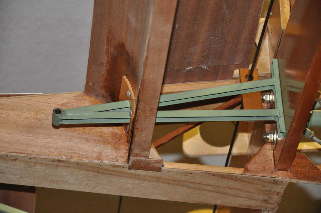

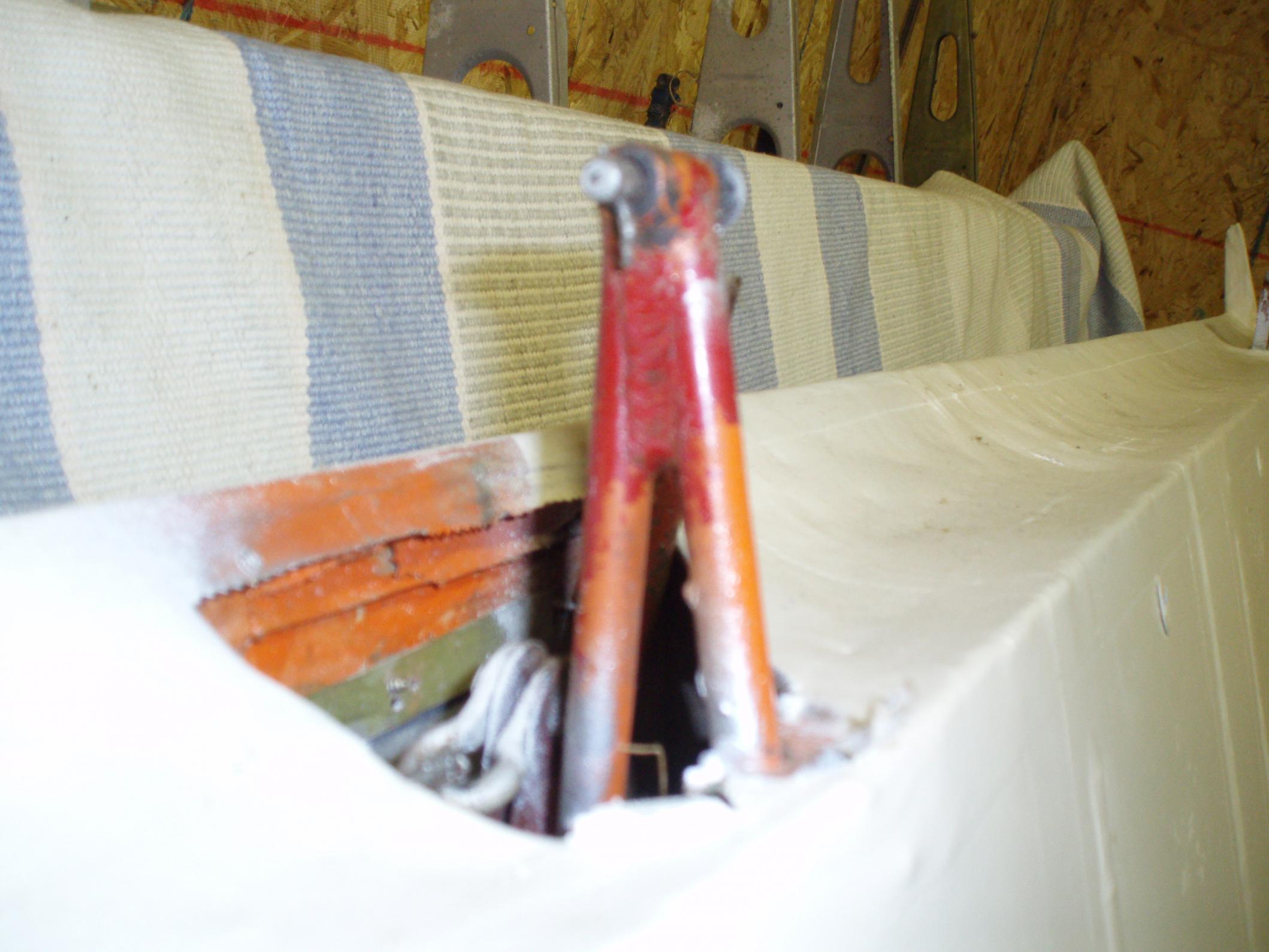

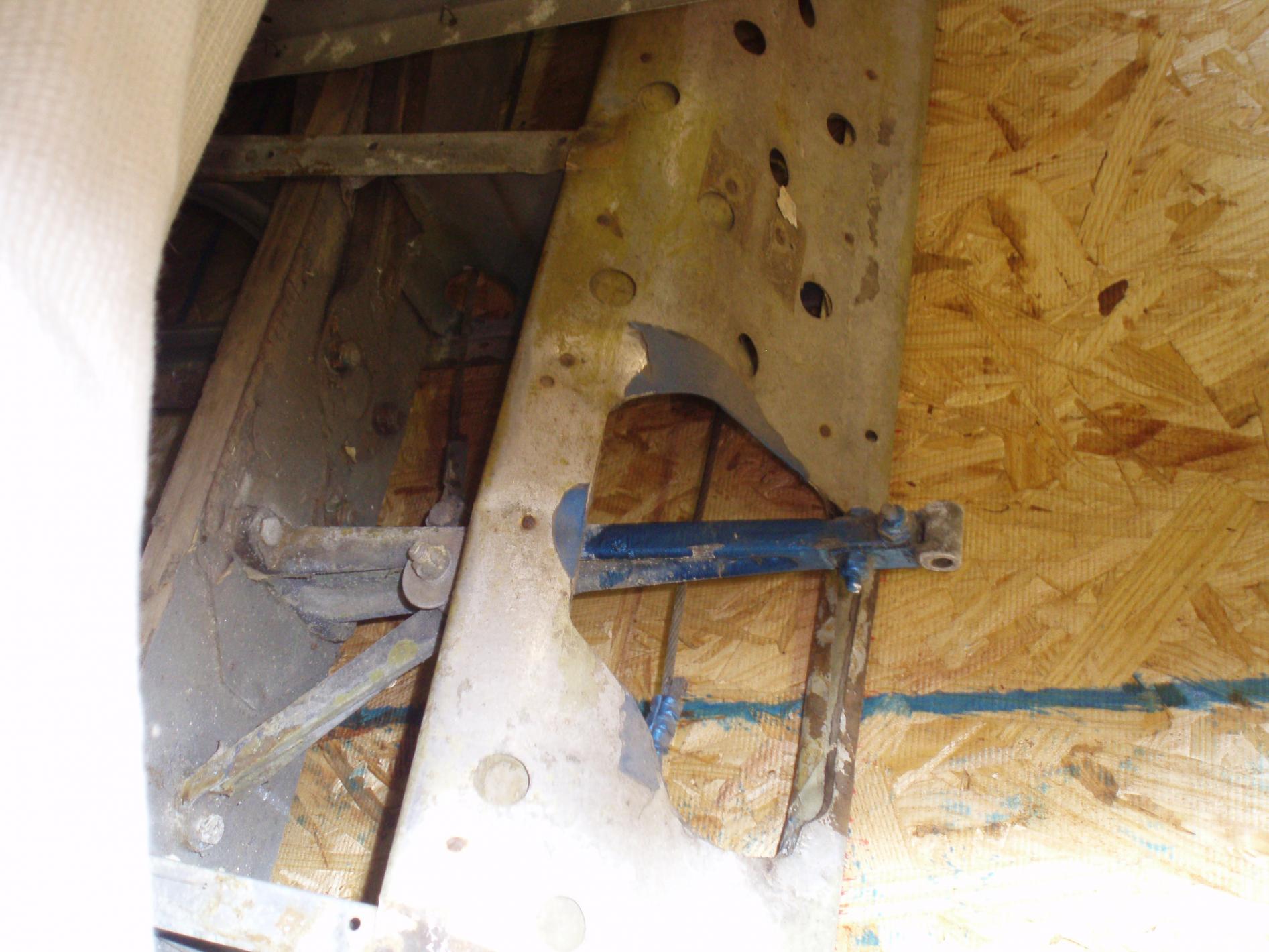

                      Here are some photos of the aileron attach fittings. First shot is of the steel crank fitting in a covered wing with the aileron off. Second is a cast crank fitting. The third one is of the broken cast one I found in my junk box with the set of NOS welded steel ones. Note that the cast one is snapped off where it came through the wing aileron cove piece. The steel bolts in the cast one are solidly corroded in place into the magnesium and the flanges where the bolts go through the rear spar are heavily corroded, but amazingly I didn't see any cracks there. I seem to remember the common failure in the box was broken off lugs for the spar bolts.
