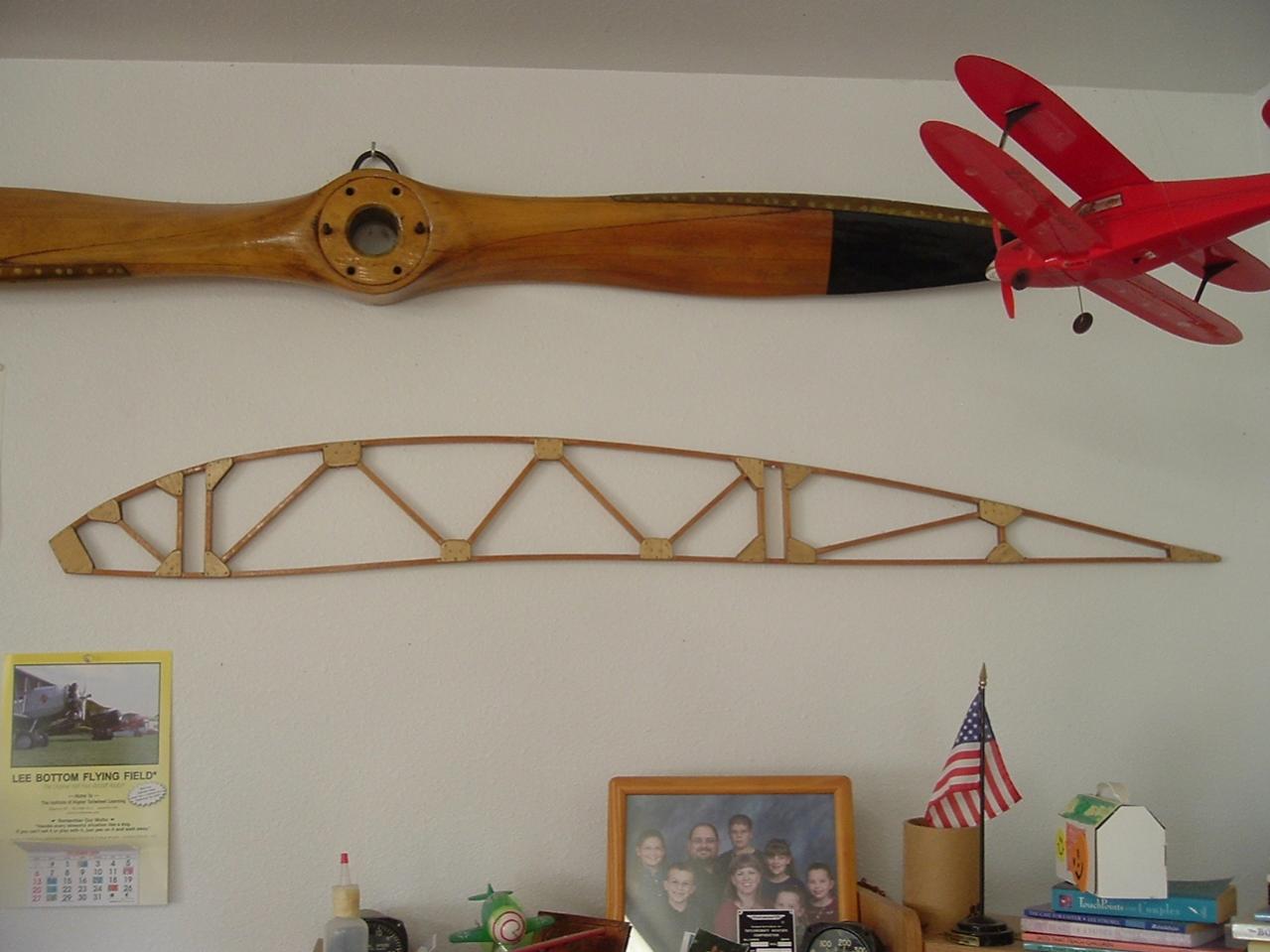

            Seeing this helps me confirm that my old Sensenich needs to remain a wall-hanger. Most of the solder pools over the rivets (through the brass leading edge) have some signs of cracking but the prop is otherwise pretty good looking. The first lamination layer also has a few weather cracks that started from flaked varnish as the prop was on an outdoor airplane for a few years. At times I have thought it might make a good prop for the Pietenpol (someday). However, I sense that I must take heed and learn from your experience to resist the temptation to use it unless I send it out for re-tipping. By the way... did your prop have any signs that the tips were in need of some attention?
            Here's a photo of mine. From 5 ft. away it looks great. But the close-up visual inspection reveals too much.
            BC12D, s/n 7898, N95598

              There were absolutely no signs of any internal/external damage on the prop. I had given it a good look just a week before the incident as well as running my hand/eyes over the leading and trailing edges before the subject flight. If you look back at the pics, you will see a darkened area at a couple of the rivits. It even looks to me that there is an "extra" rivit hole at one location. I was especially sad that I have now lost an important part of the planes history....that prop has been on this plane since 1946. It was sent to be retipped and balanced in 1985(yellow tagged for same) by Whirlwind Propeller Service.
