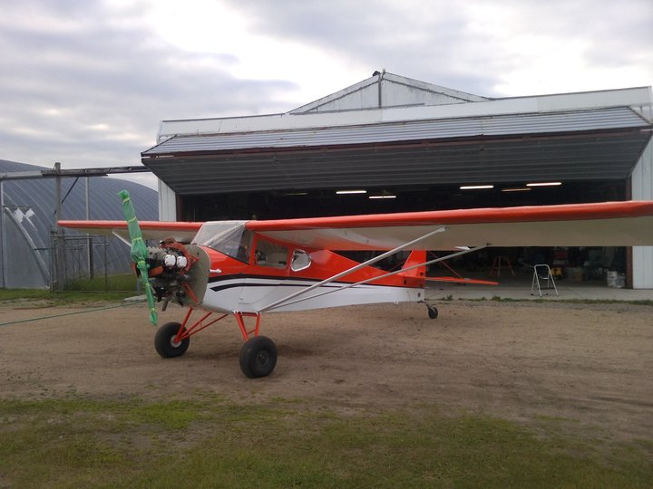

    I need a good exhaust for my 41, 65 hp. Was told to stay away from wag aeros, heard it is poor material. I have the old one, it is thin and has a few blown out spots along with thin flanges. What is the best route to take? The best deal?
