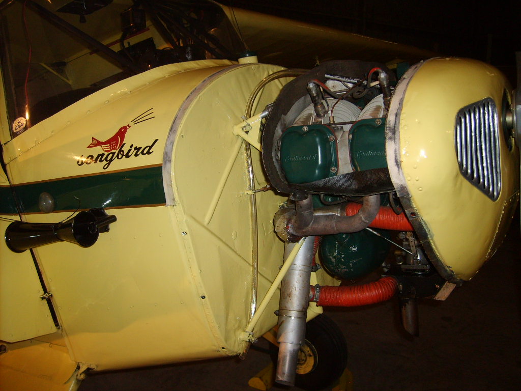

                It seems to me like this is another part that could be easily and CHEAPLY made in the shop. No outsourcing required. Just me talking. Looking at the photo of the original, I can't decide whether there is a missing piece or not. Seems like there ought to be a way to shut off the air altogether.

                  I am thinking it must have been a set of pieces to that when you rotate it so the opening is faced aft it is closed off. When it is pointed down rain would be kept out but it would only be half open to ventilate. I will need to look at it to figure out how you turned it. Time to get the jewelers loop out to look at the photos again.

                        You DO know that first picture is up-side-down! That is the sissy strap hanging behind it (which I have been looking all over for a picture of! THANK YOU!!!)
                        'Looks like to me there are actually TWO of the "scoops" facing opposite ways riveted together with a space between them the thickness of the windscreen. There are 6 rivets and 2 screws and knobs. Too bad there is no way to shut it completely in really cold weather.
                        It also looks like VERY thin material that probably COULD be home vacuum formed.
