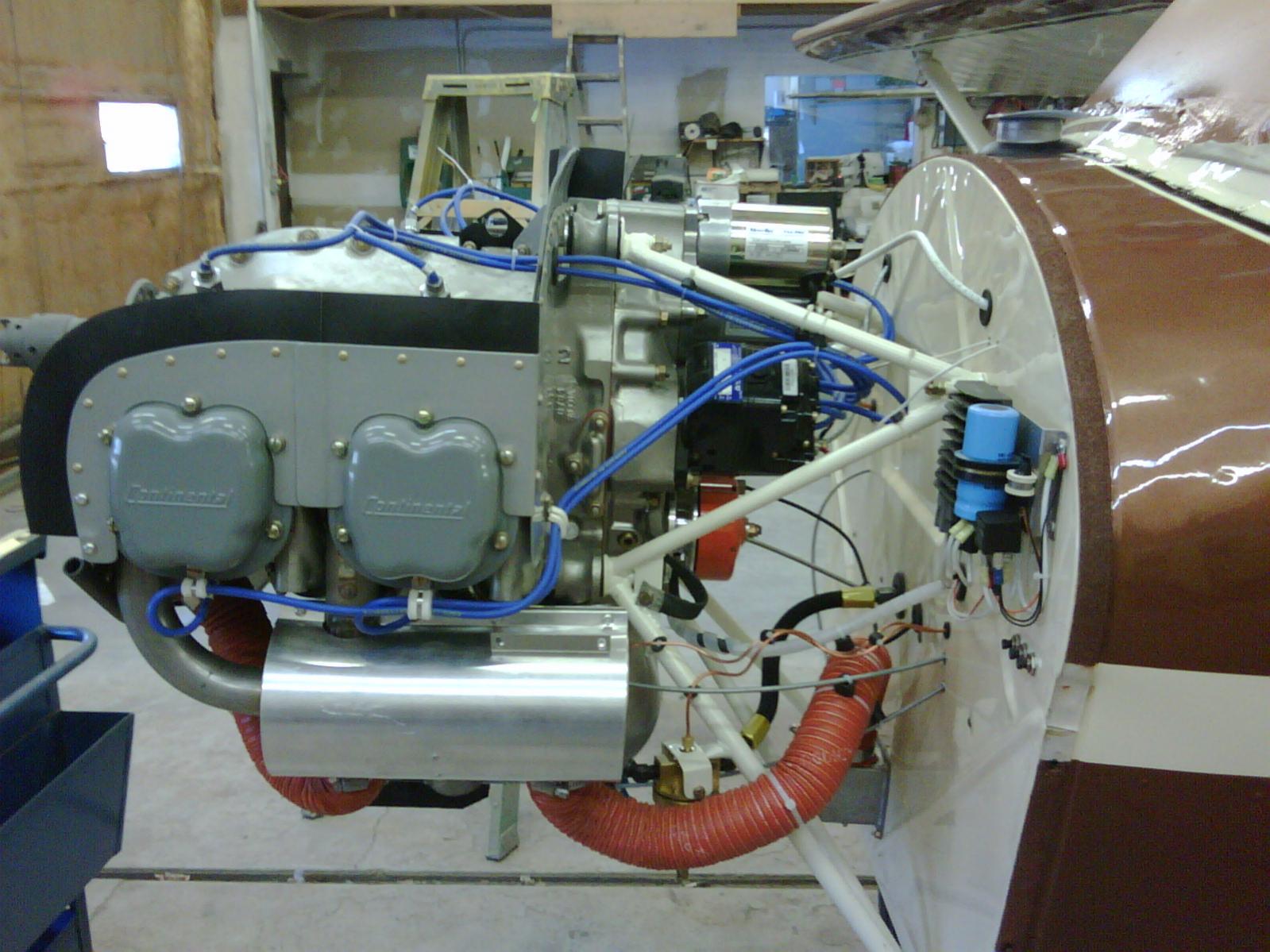

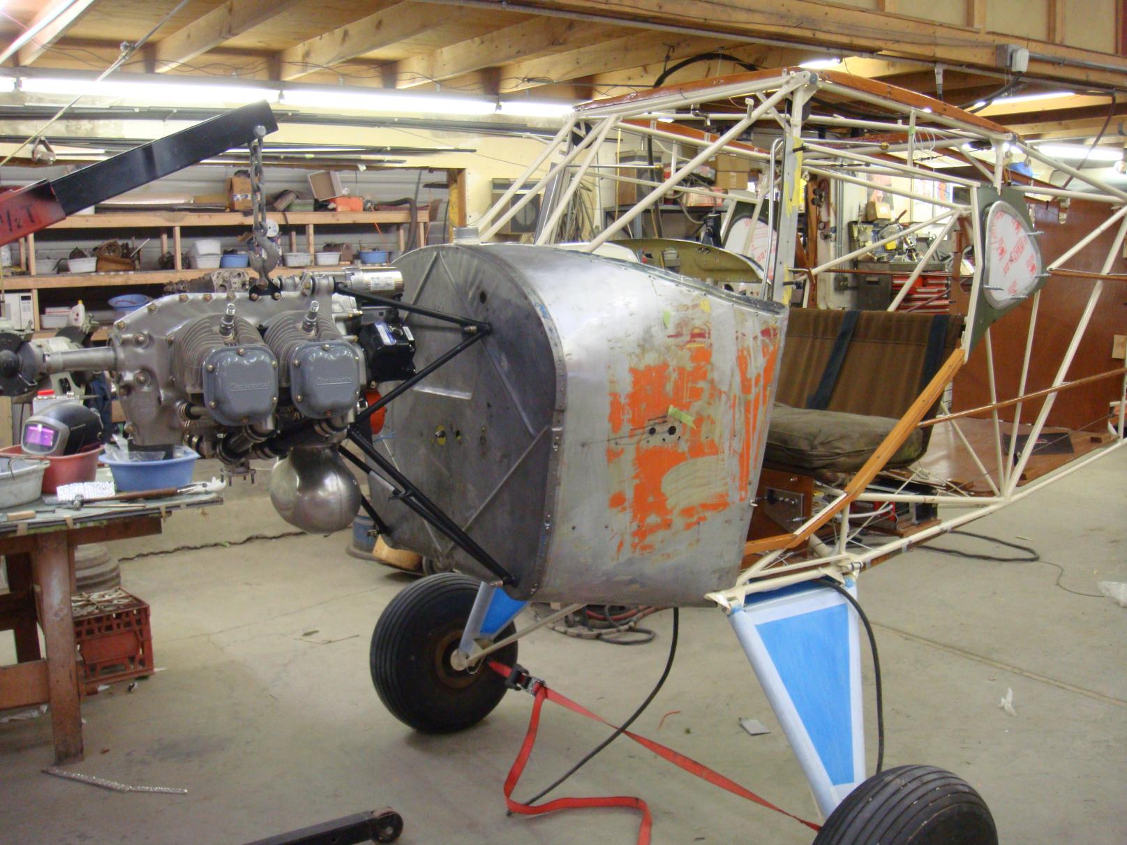

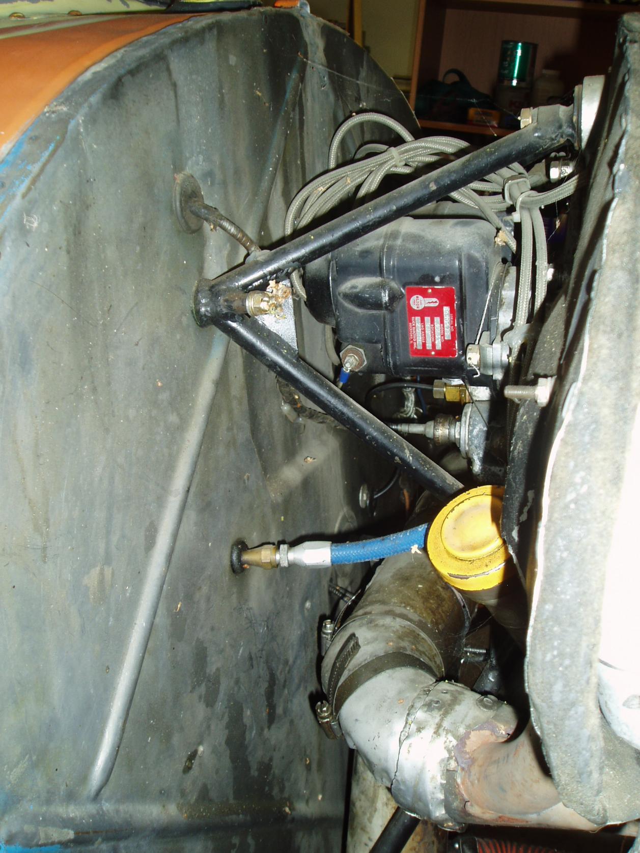

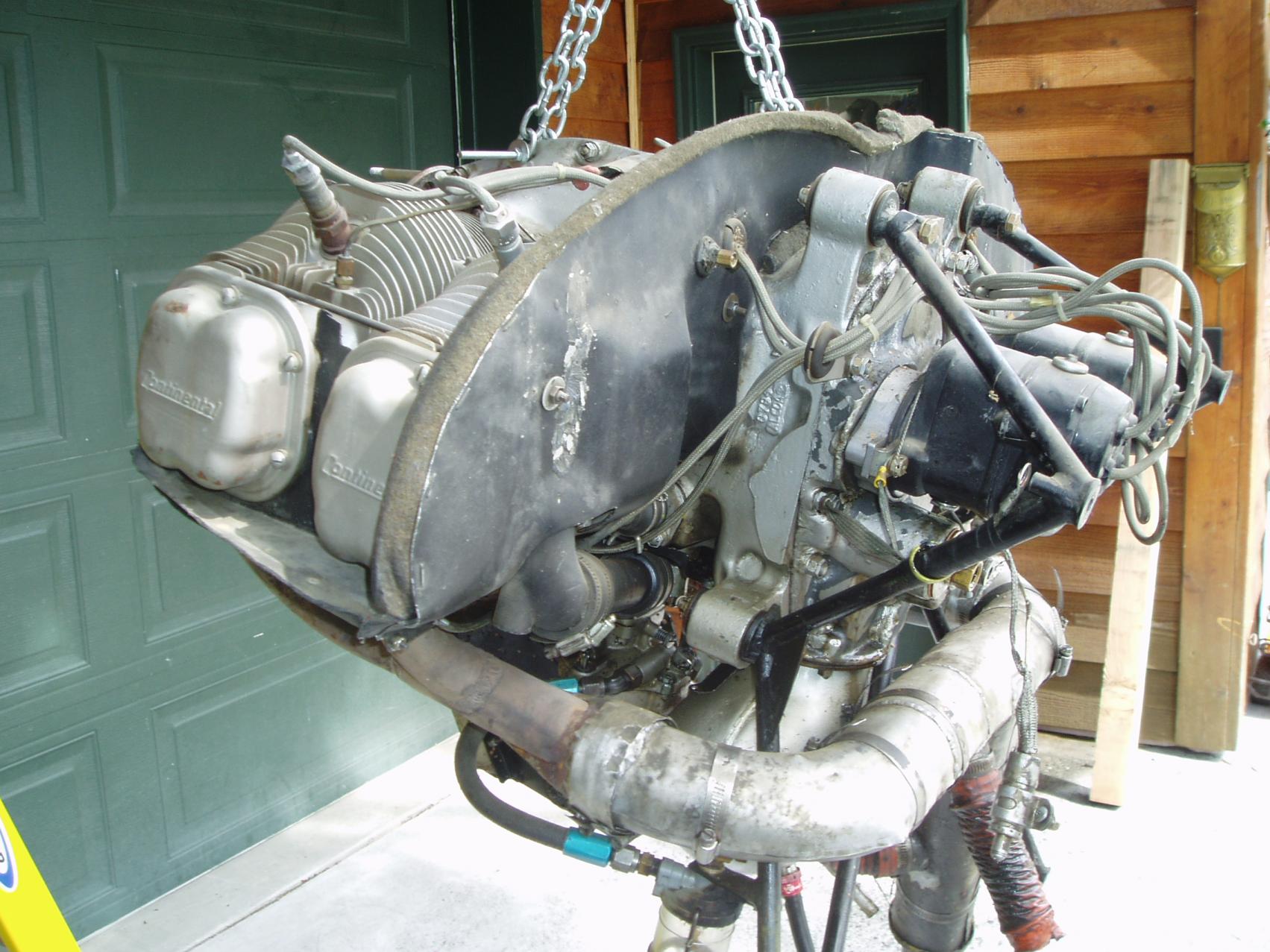

Well im trying to work out the short mount with electrics. here are the thoughts let me know what you think or know.
I have an 85 with electrics and b&c alt.
As i understand it the long mount is 4 inches longer than the short.
The long mount puts 4.5-5 ish inches between mags and firewall
The original starter with pull cable is 1-1.5 inches longer than the mags.
if the skytec starter is an inch shorter the c85 should fit on the short mount
possibly the 0-200 with short alt should fit on short mount with small mount standoffs.
the other idea i was kicking around would be a swing out mount. this could make the distance needed to fit the starter and get the engine as close as possible to the firewall.
so in closing has anybody tried these combos or does anybody have the ability to measure the skytec starter you could measure from the engine flange back
