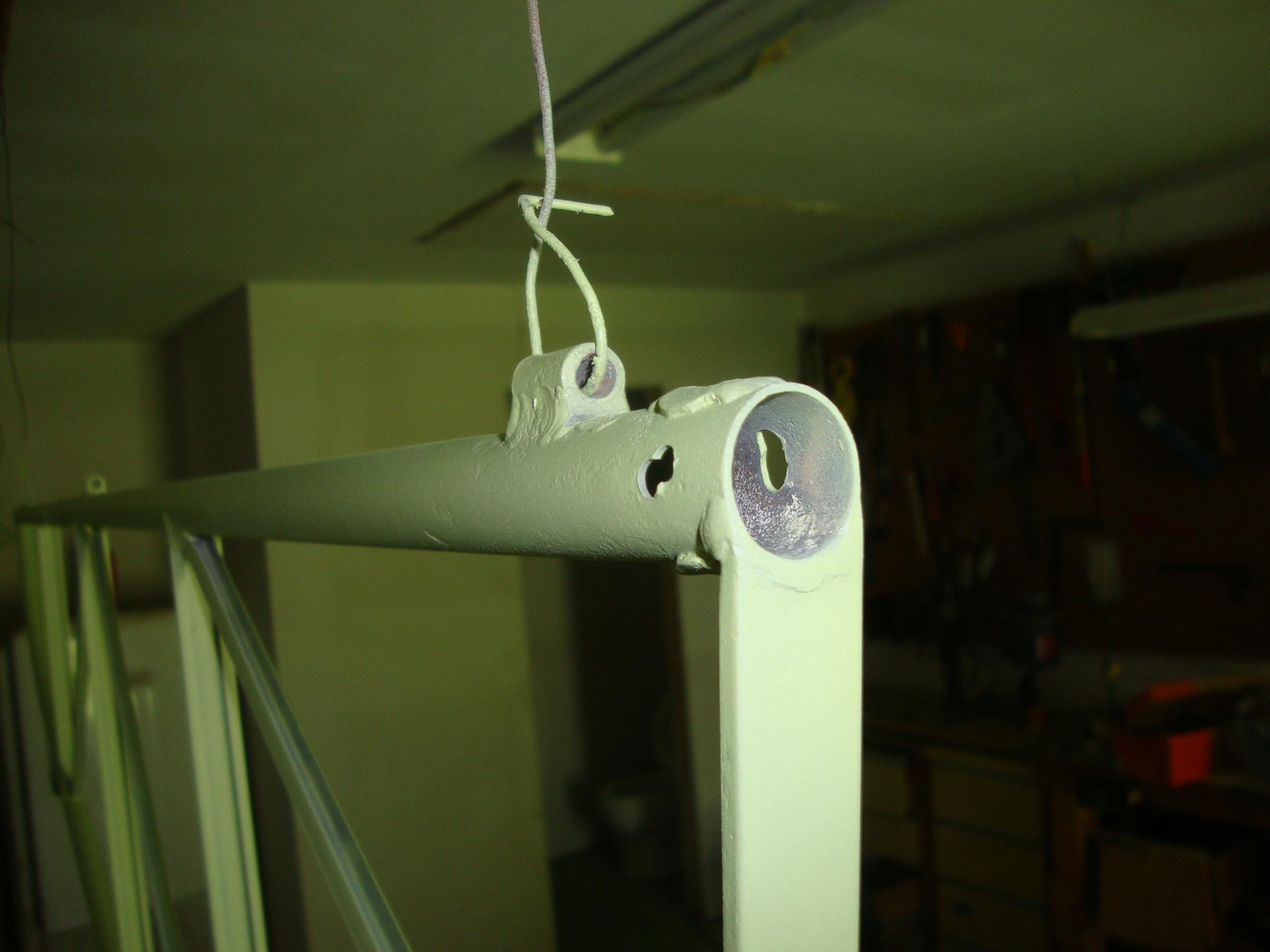

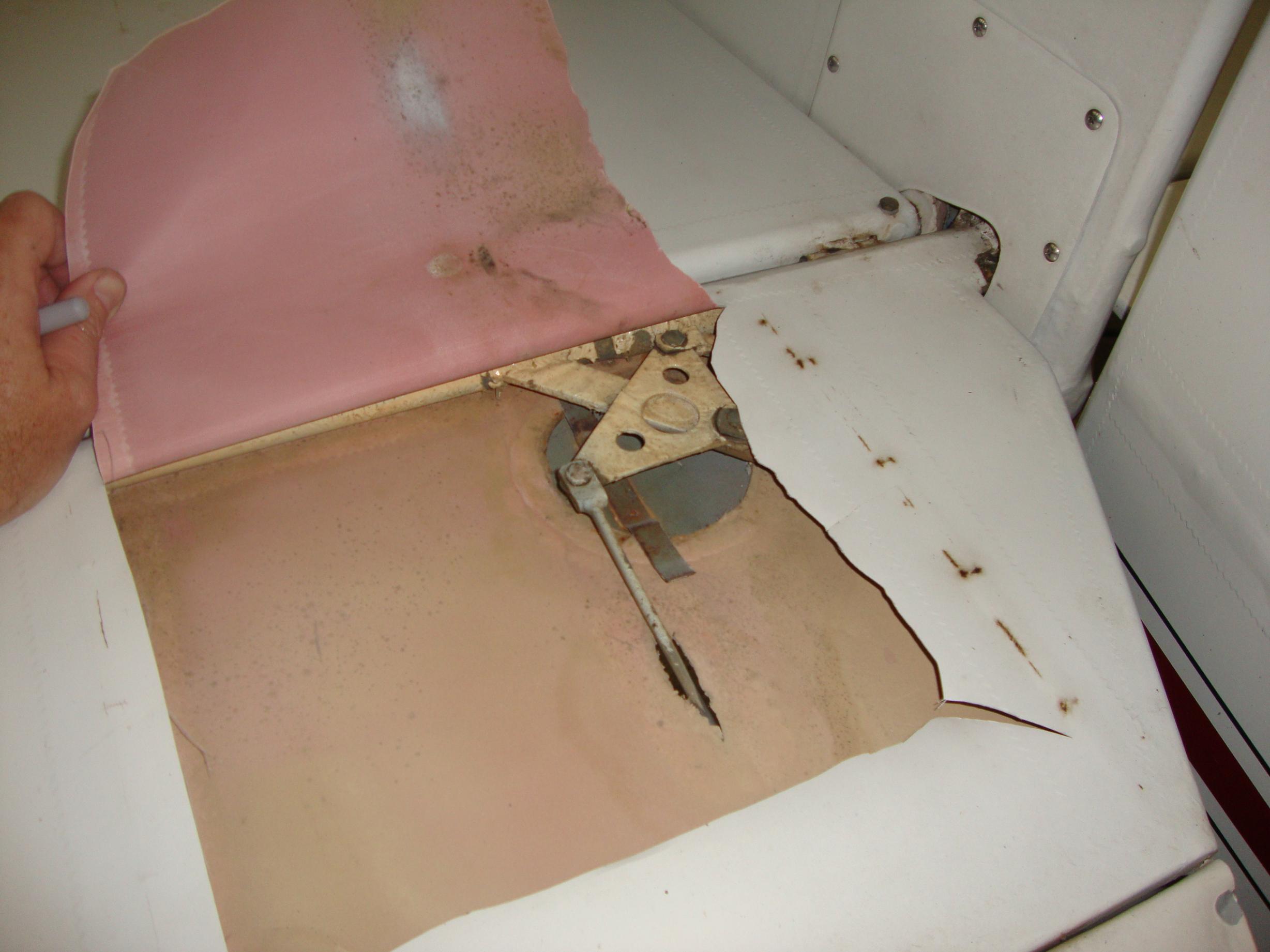

    Any comments on the thru hole(s) where it attaches to fuse?

    Looks like it went from one plane to another. With the wires in tension that stab will not be going any place, in my opinion anyway. However because it is not a moving part and not a structural part, a weldment should be an approved fix but we will see as there are way more qualified people that will weigh in here.
    Larry
      Re: Horizontal stab attach bolt hole
      You may be right about it being moved from another airplane becasue both the leading edge hole and the trailing edge hole look like this, twice drilled. But only on one of the two stabilizers. The other one shows no evidence of being double-drilled.
      My IA is a good welder and he says the thing to do is weld it up and redrill it correctly. Just wanted to bounce it off of the tribe.

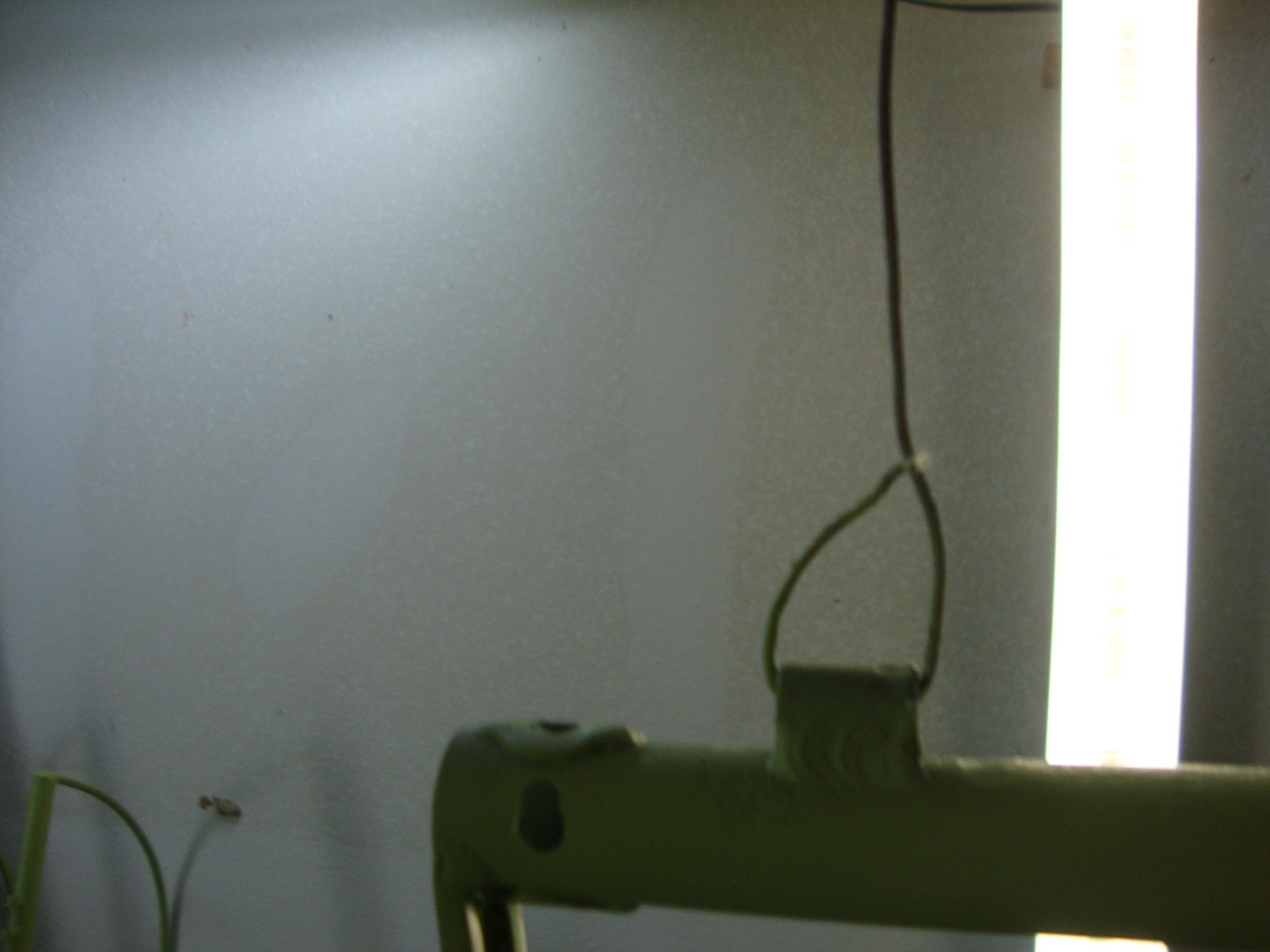

        Tim,
        I have seen horizontals with round plates (fender type washers) bent to match the tubing and welded over the bolt holes. I don't know if this was factory or not but the tubes only showed evidence of one hole on the inside. In other words, the washers were not welded on to cover a miss-drilled hole. My thinking was that they were there to keep the tubing from crushing in case of over-tightning of the mounting bolts. In your case a washer or small plate welded over the area may be a good way to fix the double holes.
        David
          Weld it up and redrill.

            Hi Tim,
            AC43.13-1B chapter 4 page 42 says this;
            4-60. STEEL AND ALUMINUM FITTINGS.
            a. Steel Fittings. Inspect for the following
            defects.
            (1) Fittings are to be free from
            scratches, vise and nibbler marks, and sharp
            bends or edges. A careful examination of the
            fitting with a medium power (at least
            10 power) magnifying glass is acceptable as an
            inspection.
            (2) When repairing aircraft after an accident
            or in the course of a major overhaul, inspect
            all highly-stressed main fittings, as set
            forth in the manufacturer’s instruction manual.
            fittings.
            (4) Elongated or worn bolt holes in fittings,
            which were designed without bushings,
            are not to be reamed oversize. Replace such
            fittings, unless the method of repair is approved
            by the FAA. Do not fill holes with
            welding rod. Acceptable methods of repairing
            elongated or worn bolt holes in landing gear,
            stabilizer, interplane, or cabane-strut ends are
            shown in figure 4-25.
            The figure basically shows how to make a repair washer and weld it on.
              Looks to me like you need a stepped binocular bolt. The shank has an overlapping double diameter in the stab holes and a single diameter in the airframe hole. Provides great load capacity and no play but are a pure B**CH to put in. ;-) When I worked for the Navy we had a set of "special fasteners" that were a riot to show to mechanics for use in "special" repairs.
              We also had "Joggle bolts" (for misaligned bolt holes), offset head bolts (to hide holes too close to the edge) and angle bolts (shank angled from the head so a crooked drill line is hidden). They were all gags, but hilarious the first time you gave one to a mechanic.
              By teh way, I have seen the washer repairs and they seem to work well.
                  Thanks for everyone's advice. What's interesting is that both stabs, on both the leading and trailing edges, have fore/aft (horizontal) holes that are reinforced with a washer. When would these ever be used?
                  The tube in the fuselage only has holes for the vertical bolts that were installed.
                  Tim Hicks
                  N96872
                    My guess is when these part were used on a pre-war fuselage. Pre-wars had horz. bolts.
                    Or it could be that somebody just decided to go to vert. bolts instead.

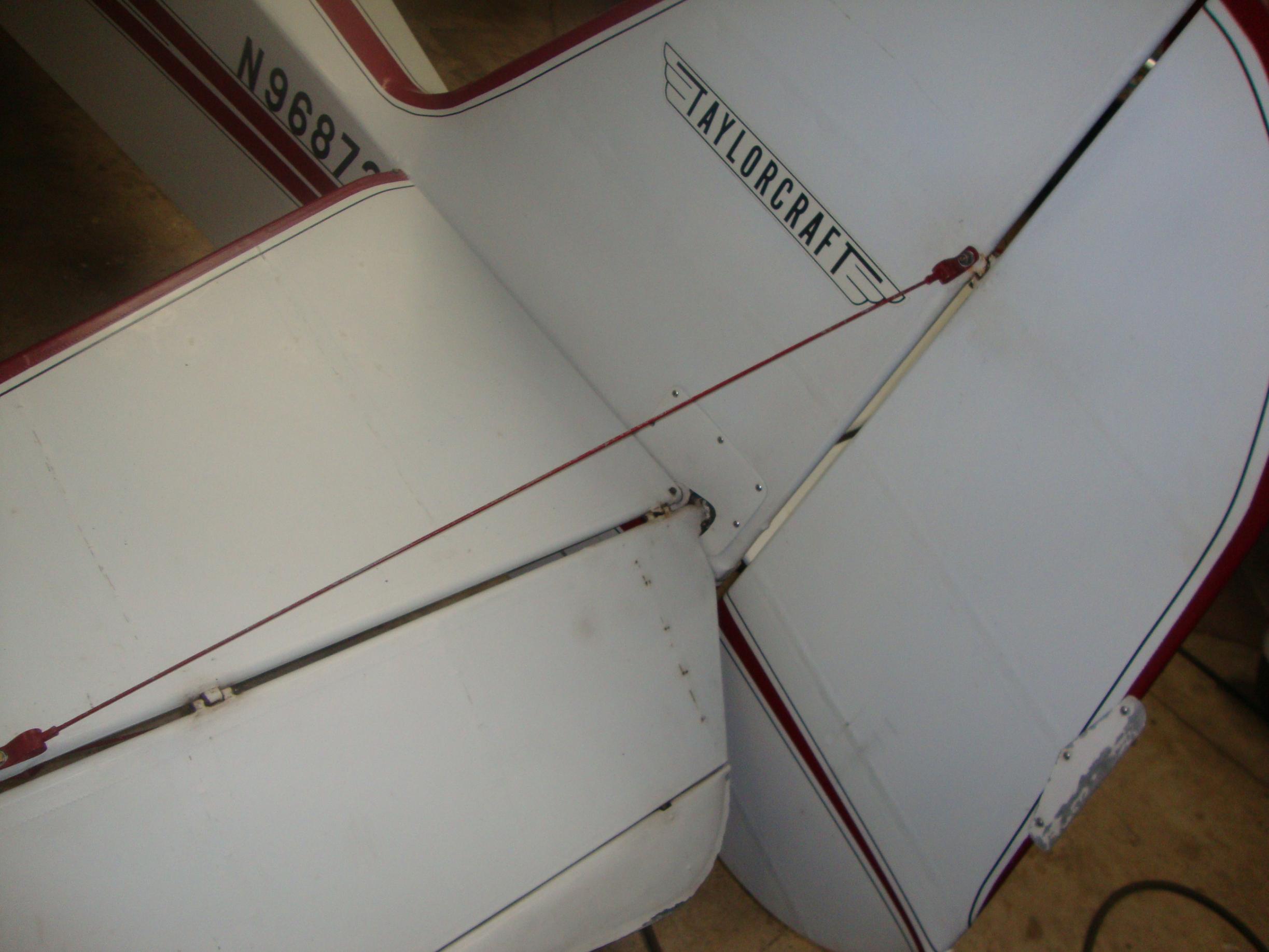

                        They will fit but most pre-wars have 3 hinges, post-wars have 2 hinges per side.
                        Eric Minnis
                        www.bullyaero.com
                        Clipwing Tcraft x3

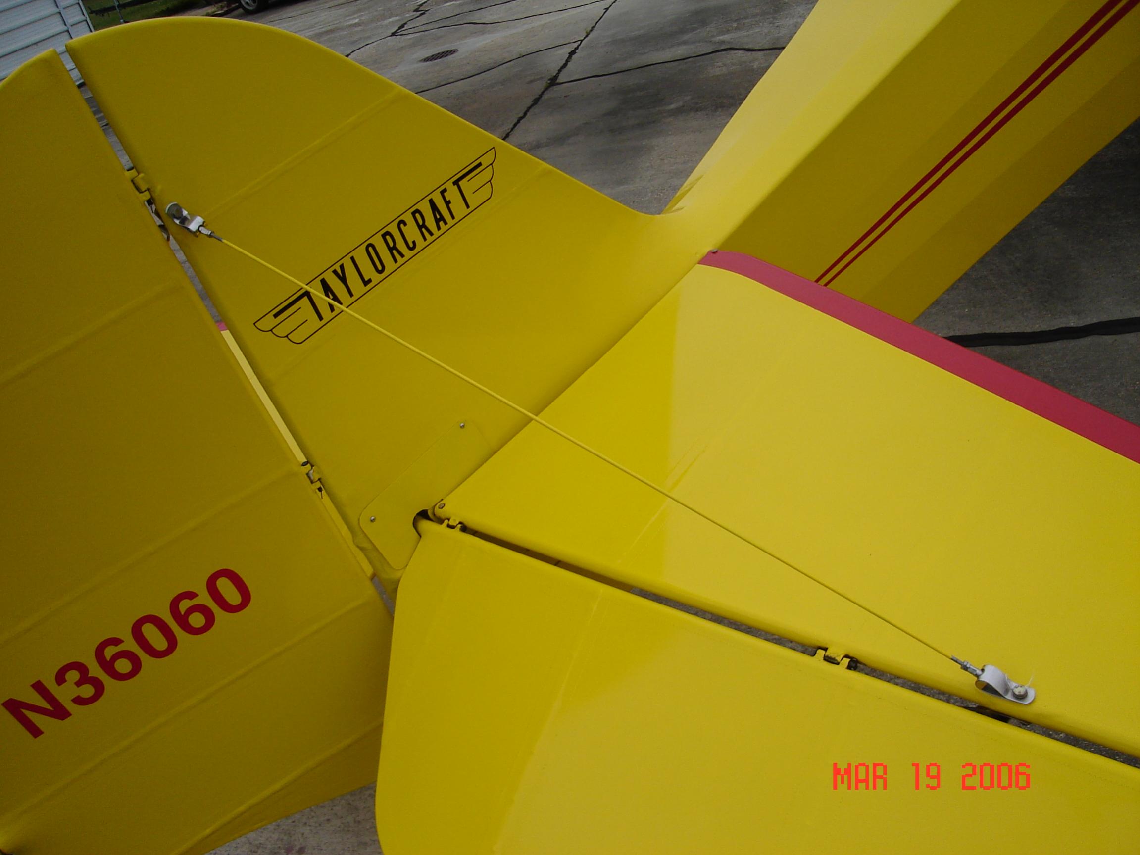

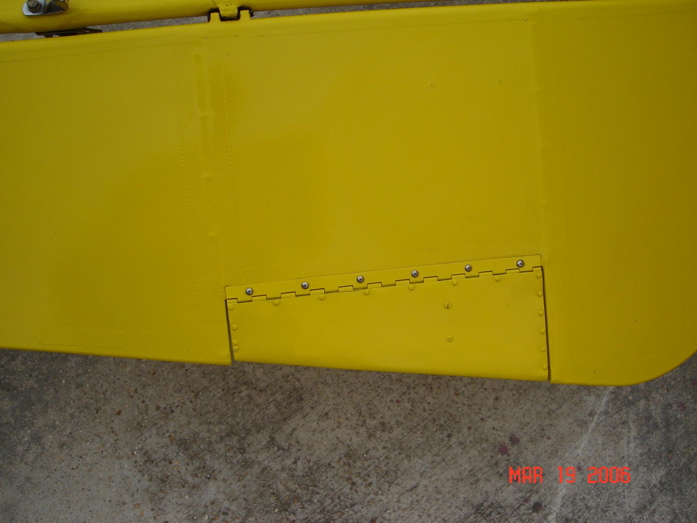

                          Aha. My stabs and elevators have 3 hinges per side. So this means that they are prewar, right? But I have a metal trimtab with the jackscrew-type actuation. I share a hangar with a yellow 1941 (pre-war) TCraft and its trimtab looks very different. And its rudder has 3 hinges while mine has only 2.
                          Tim Hicks
                          N96872
                            My 41 is 3 hinge but has vertical bolts and a jack screw trim. I am to the point that I don't expect ANYTHING to be "standard" on a Taylorcraft.
