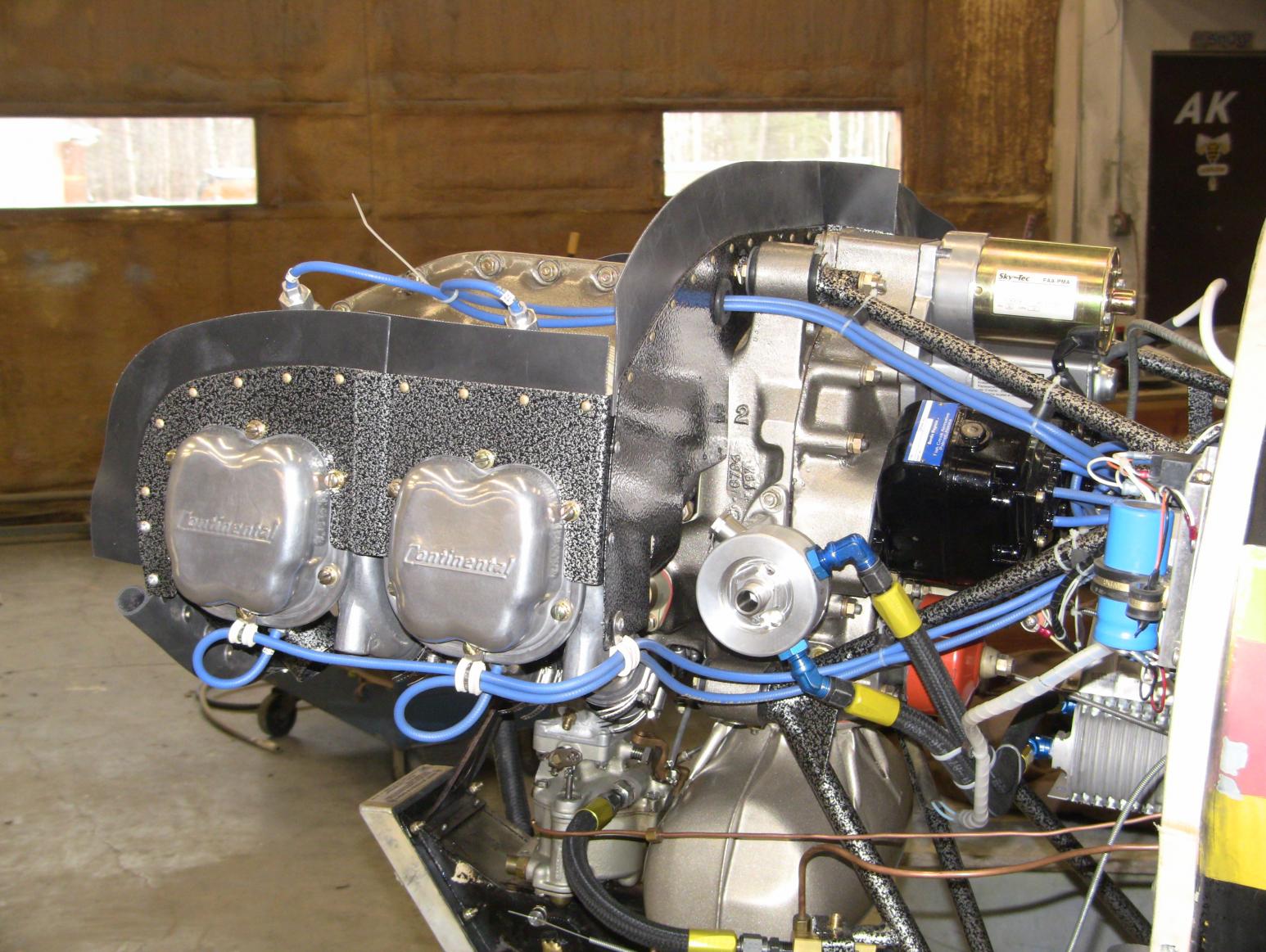

    Hopfully the pics post, here are the new style baffles.

    The baffles are grate but what I see is a total engine up grade that is jest beautiful grate job Chuck

          Hello Eric,
          Nice looking engine installation and especially the baffles. You have chosen good people to help you with the mods.

                    eric i love the cleanliness of your motor could you post a few more pics id love to see more detail all around. i also went with the same alt and mounted my electronics inside the cabin same location. i was thinking of putting my battery where your oil cooler is.

                      PM me your email address and I will send some pics. There is two sizes of alt, I have the little one. There is a better alternator out there for the same weight, these dump the extra electricty into a heat sink so it is wasiting full power when there is no load for it. I put a tube blowing on my heat sink as the thing gets hot. My battery is under the seat with the solenoids, they get a little nose heavy with the extended mount when light, I will know more after the weight and balence is done tomarrow. There is no "Jenny Craig" for these girls, the little pounds add up. I went light weight and don't want to see the scales when they pick her up, she used to be light.

                        Nice looking engine installation. I like the oil filter and oil cooler installation. Where will your cooling air inlet be located? I see you have no exhaust installed yet. Are you going to go with a split exhaust? This should be a cool cucumber with all these items added up. The oil cooler will make a huge difference, perhaps too good in cold weather. I would love to see more photos and hear more about your progress. Is this a C85-12F, C90-12F, or O-200-A?.

                          Terry,
                          We are pulling a 3'' duct off the back of the rear baffle, the oil cooler and filter is from Steve's Aircraft. I also have an 8 point Electronic International engine monitor (CHT/EGT) so a hot cylinder will show before there is a problem. You are right about having to much oil cooler for most if the flying here in Alaska, I will restrict the airflow to maintain adaquate oil temperature. I am on floats in the summer so the engine does get worked. It is a C90-12 flanged with the 6qt oil tank, and 150 exhaust. I started it yesterday for the first time and she didn't make 2 revoultions before firing up and running like she ran yesterday. I saw a static rpm of 2100 with a 76ak-2-42, i am going to put a 39 pitch on and see how she does with that.
